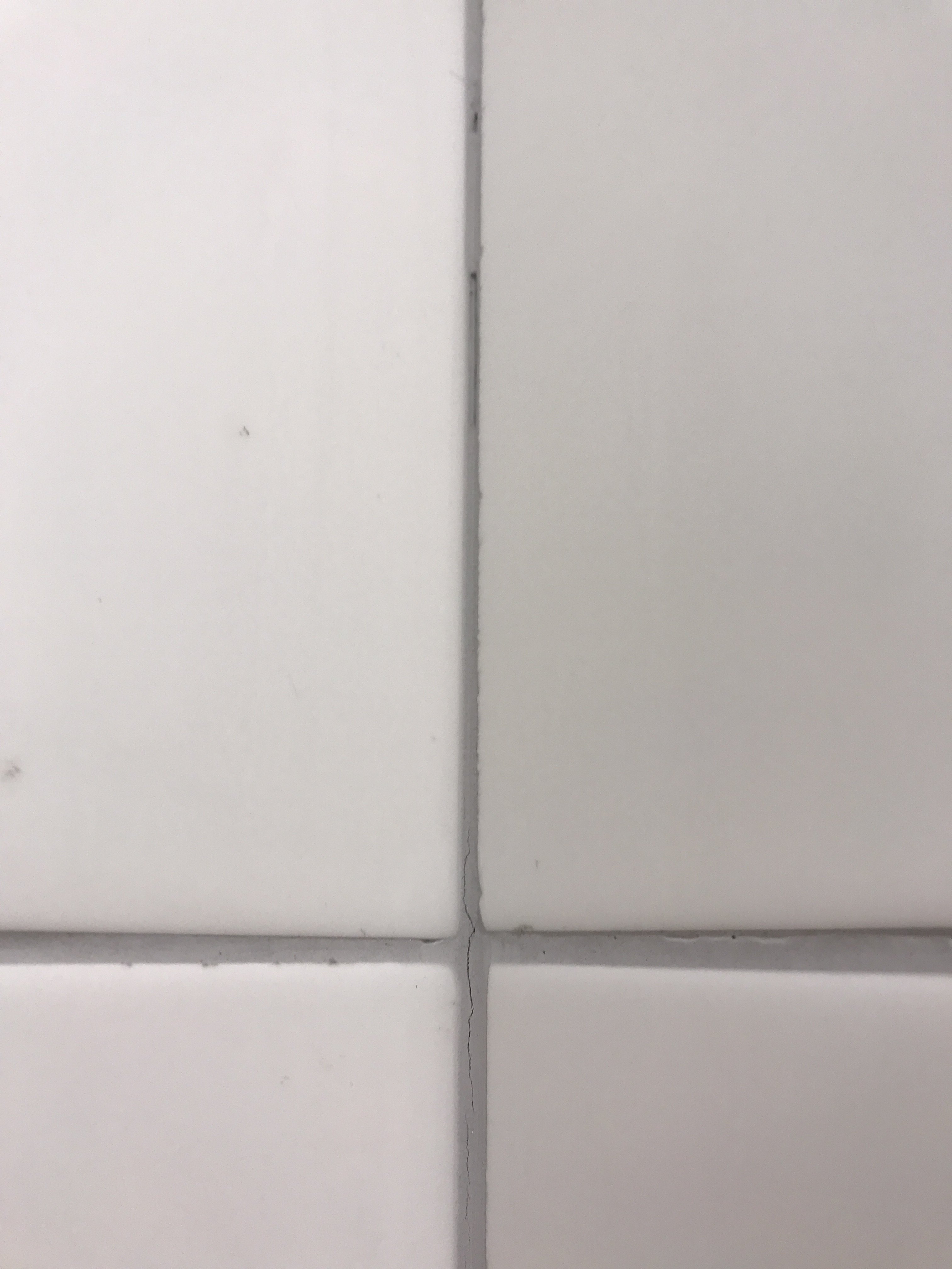

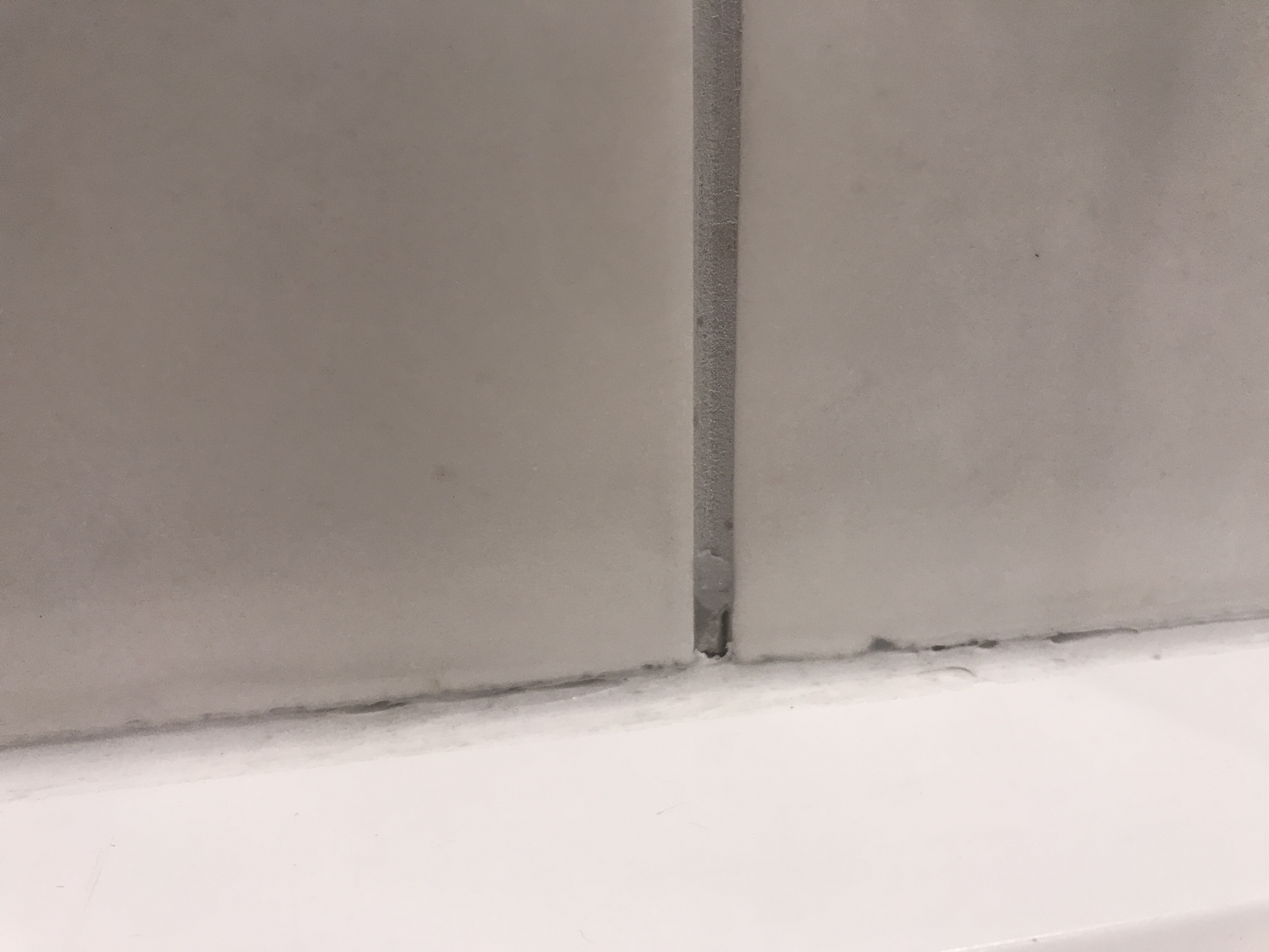

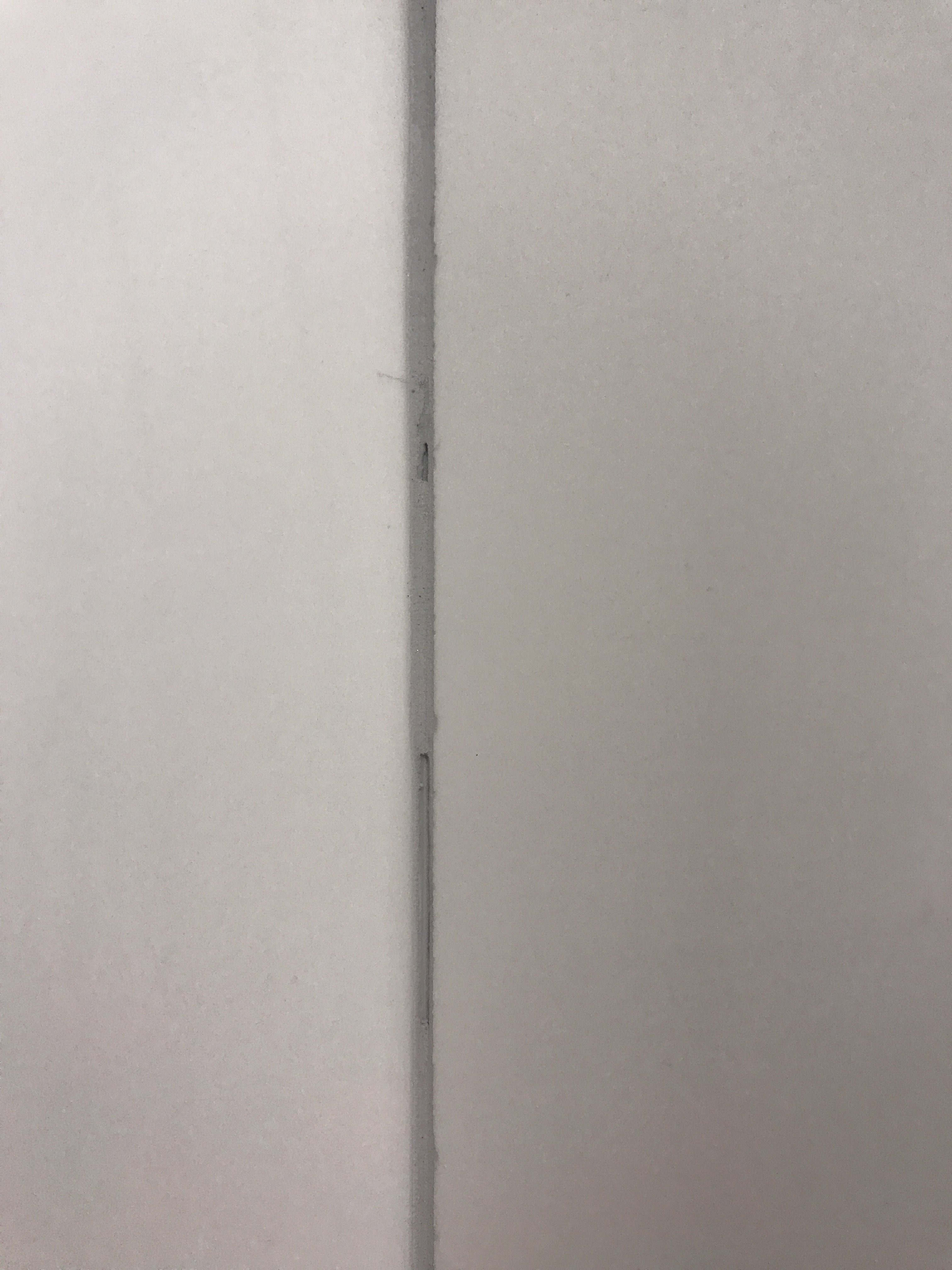

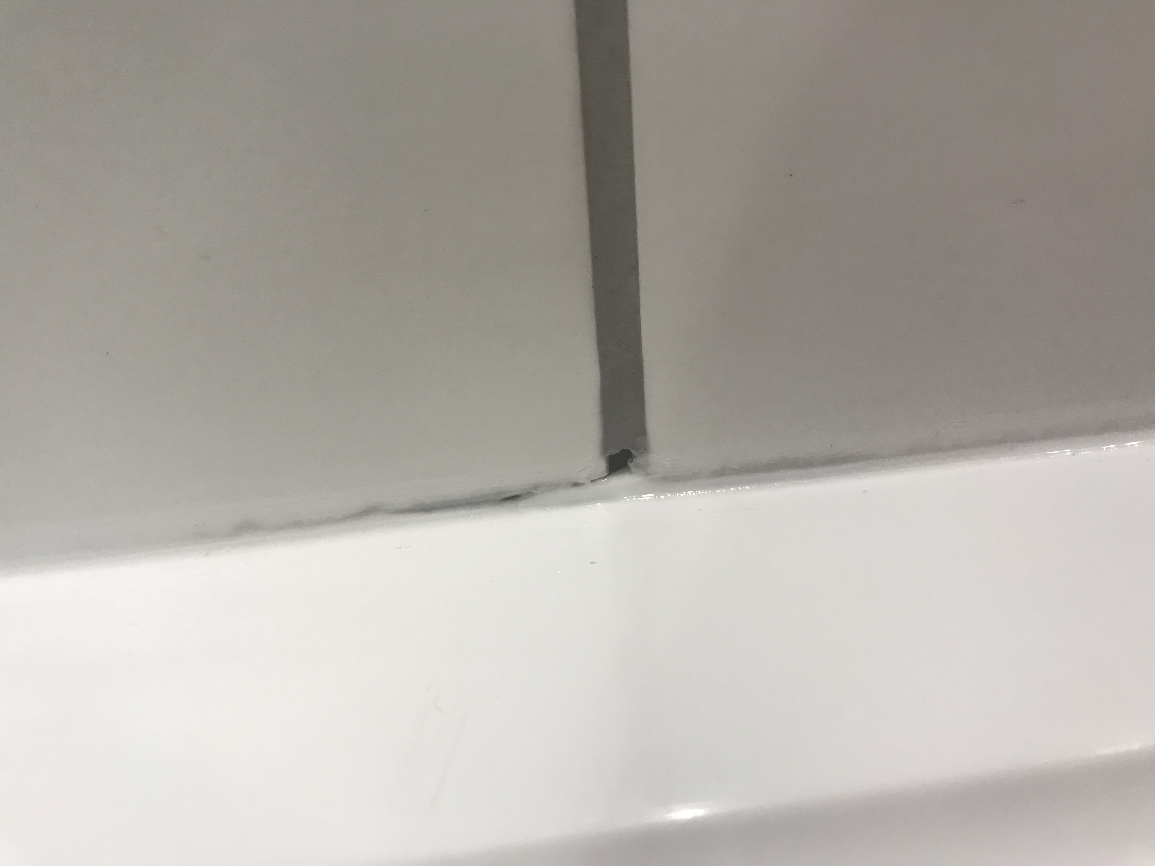

Hello I’m not sure if I’m posting in the right place but I could do with some advice regarding our newly installed bathroom (6 months old.)
I’ve just noticed stains in our dining room
Ceiling directly below our shower. My first thought was leaky pipe work but I’ve just spent ages inspecting everything and have found:
-Bubbling paint all down the dining room wall which indicates this has been going on for some time,
-cracks and holes in the grout all over the place in the shower cubicle,
-gaps between the shower tray/sealant, which I imagine is what’s causing the leak.
Now I need to know what I should expect from our bathroom fitters. Should they fix the grout, reseal for free, should they also fix the downstairs room? Should we suck it up and sort it ourselves? Is it normal for gaps and holes to form?
As a side note the wall tiles were fixed using dot and dab which I questioned at the time but he seemed confident and said it needed to be dot and dabbed due to uneven Walls (despite them fully boarding and plastering). Will add pictures if possible. Thank you.
F92338FC-6A15-4AD7-9405-419174401083.jpeg A860ACE6-6DF3-4D03-A15D-FAE0AC8E02EE.jpeg E75E3B87-D40D-4556-8B42-F40050F679E1.jpeg 61DFF2AC-F705-4D17-86A8-31184D62FFB0.jpeg 15A575C0-CE18-4DCE-8AD7-F872AF9A6AB2.jpeg
Did I read that correctly, they reboarded and then said the walls were uneven?
You are correct that Dot and dab is not an acceptable fixing method. No amount of Silicon or regrouting is going to fix things I'm afraid.
Unfortunately when you make little errors like that, it can ruin the boarding behind the tiles. This is why we tank shower areas. It protects the substrate should something not be quite right.
There’s no Second chance if there’s no tanking, waterproof board or even water resistant board.
The internal corner is an expansion joint and should be sealed with Silicon, the grout should fill the entire joint in other places and there should be a bigger Silicon bead on the wall to tray joint. Also in Pic 2, the grout looks like it was too wet and has sunk.
Looks like it will need to be ripped out and done again as any repairs will only be superficial, I would imagine the substrate is damaged and will be breaking down.
