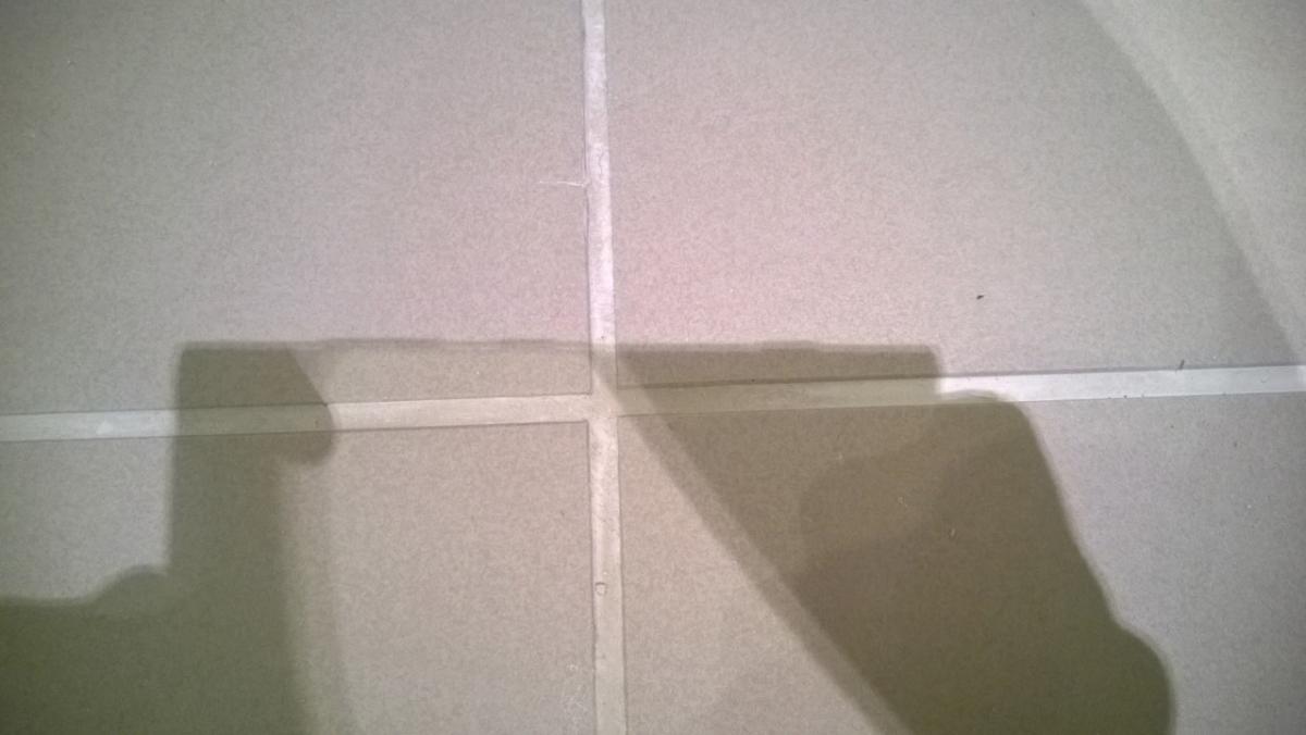

The chipped porc is going to annoy the hell out of me (the rest of the cuts are fine, but this is in the bath on the corner of the window in an obvious place). The same goes for the floor, its out by just over 1mm, but its a whole row of 3 tiles and then of course the next and final row next to it.
Am I just super fussy?
Aside from slight lipping (Porc large tiles in brick bond), and that a little too much grout was washed out in places (which I'm pulling the firm up on tomorrow) I'm fairly happy:
1drv.ms/1jWg82e
Do I ask them to replace the tile around the window (will this completely the plasterboard beneath and be harder than it looks?), and do I ask them to sort the floor?

I've managed to save your photo's from your one drive and hopefully, I've got them attached here.
Neither picture is great but the cut to the window has to come out! Either the Tiler needs a new cutting wheel or new teeth as he looks to have had a good chew of the edge! Also agree with your pulling of the grout - washed too much out.
Thanks John, appreciate the reply. With some of the grout taken out, it looks a little better, but the tile is of course still chipped - 1drv.ms/1krymok, would you still take it out?
Do you think this can come out without causing too much pain - especially given the location and plasterboard backing?
Cut around the window is not acceptable and has to come out regardless of the plasterboard behind it, his poor workmanship in this area needs resolved at his expense , not yours! Can't really make the other picture out!!

At the end of be day, the customer is always right... If they're happy, it's acceptable. If they're not, it's not. Once in a blue moon, you may get a completely unreasonable customer, who is just trying to get the job for free, or a discount, but I certainly don't think it's unreasonable to expect a finish that isn't badly chipped on the cut edges.
chipping around the window is not acceptable in my opinion.
