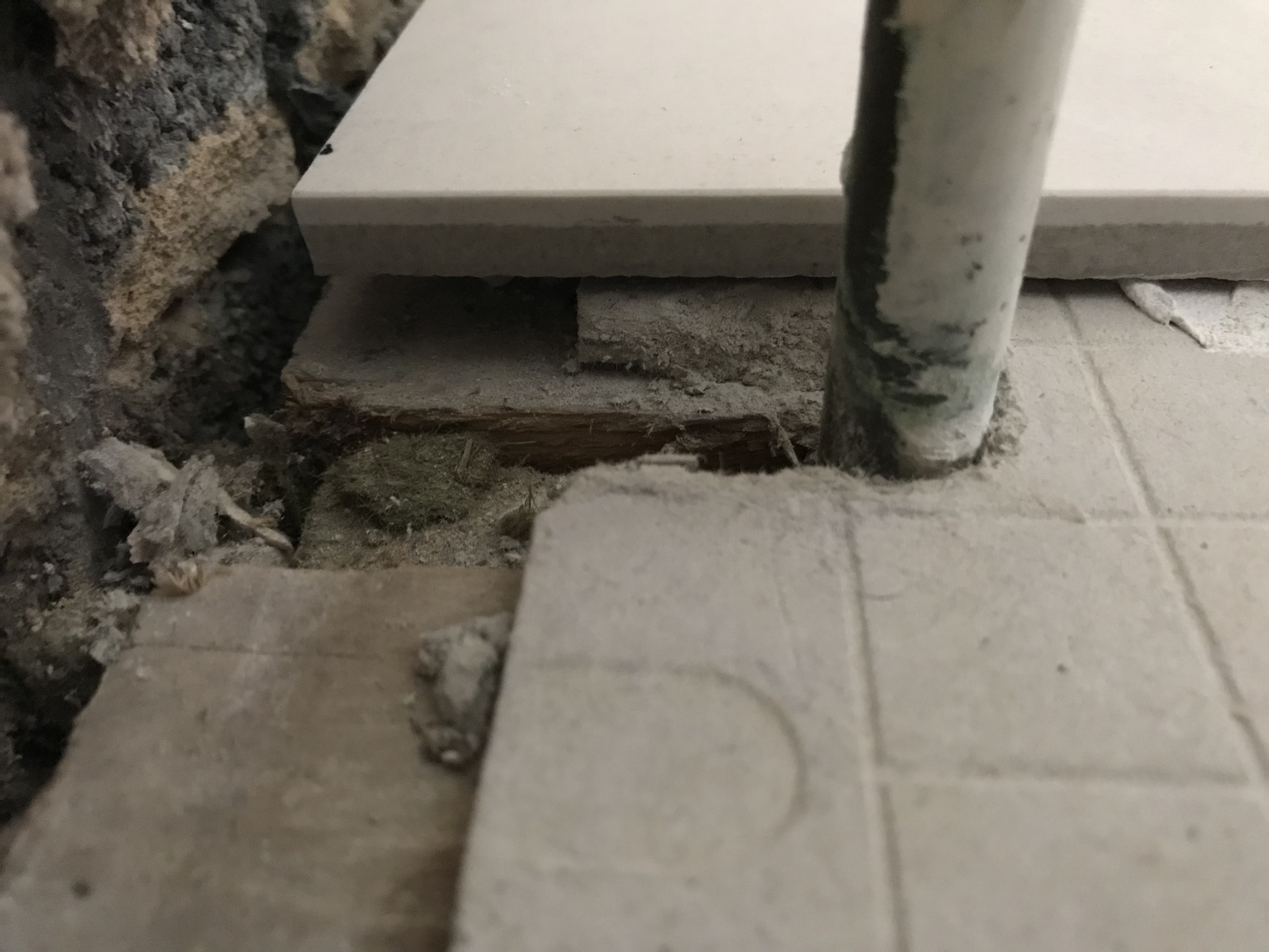

There is nothing there that can’t be rescued, if you have lost faith in your tiler which by the way he has conducted himself so far you have every right to then maybe time to get another tiler in

The chipped tiles will be hidden under bath and boxing 🙂

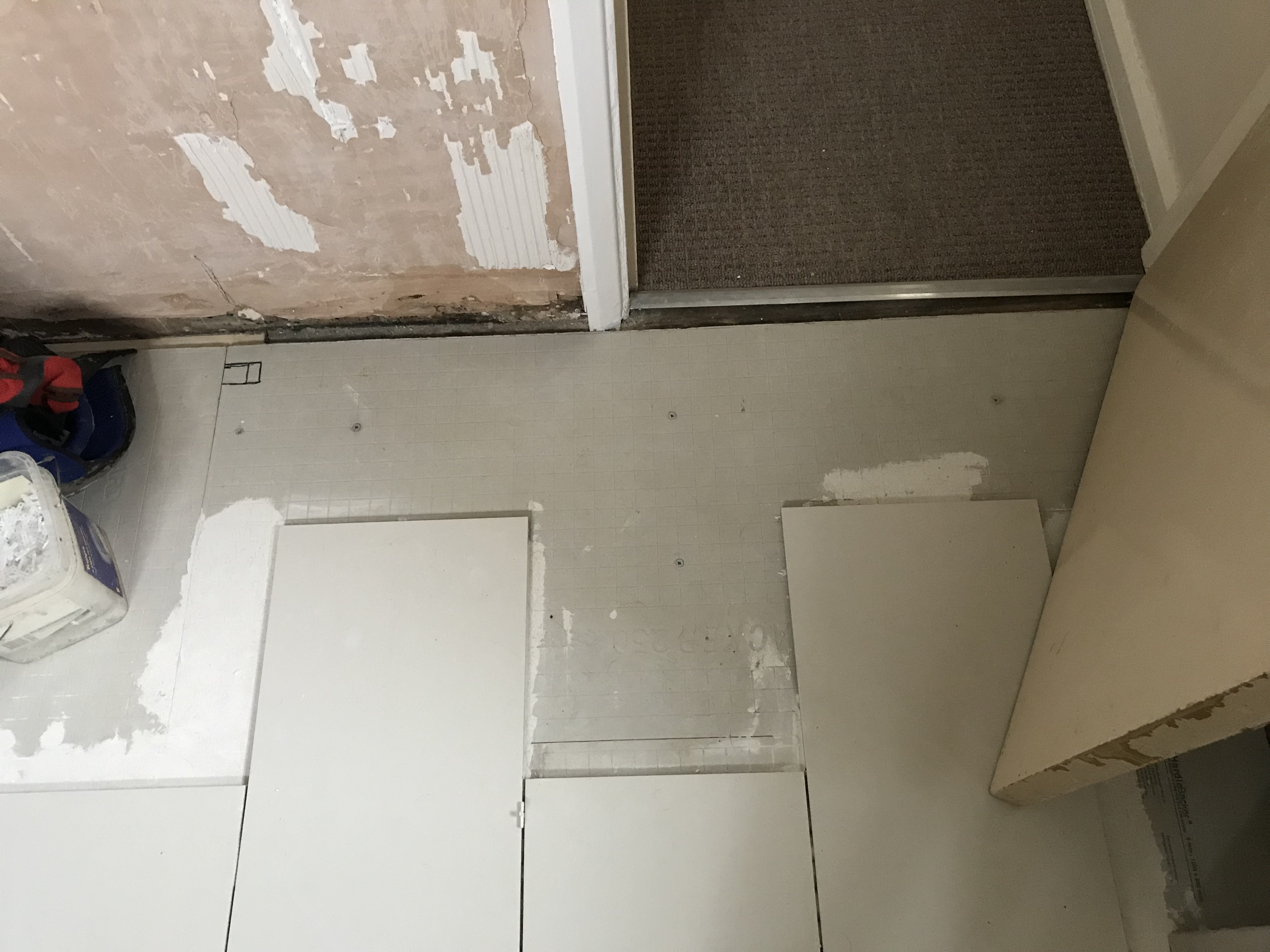

From a technical standpoint, the hardibacker is incorrectly installed, Hardibacker require a minimum of 12 screws per complete board and all joints to be taped with their skrim and then feathered over with tile adhesive prior to Tiling.
He appears to have done neither.
So you have grounds to condemn the floor.
The down side to that is that you’re legally obliged to offer him the opportunity to rectify it before dismissing him.
If use that as part of your decision, make sure you make the offer to rectify in writing attaching
Hardiebackers install pdf.
This is not to say it will fail, however Hardibacker will not offer any warranty.
If you’re wanting to be in your eyes ‘fair’ and want to pay him for what he has done,
Then it could easily be argued that the cost of replacing the Hardibacker and tiles, together with the time involved, would equal any forthcoming payment.
That would leave you with compensation for the rip out.
If you do make him an offer to never darken your door again, make sure you do it in writing, along with your reasons, together with the Hardibacker installation guide AND the opportunity to correct it.

Thank you for the advice, I’m going to give him a call and just try and talk things through like you say give him an opportunity to rectify any issues. As well as getting some others to hopefully come quote this weekend see how much they would charge to complete and fix it if he’s not willing to.
The tile is over the hardie backer board this part won’t be stood on as it’s at side of where toilet is going but will the below where the boards don’t meet the door bar need fixing sorry I’m a complete novice
