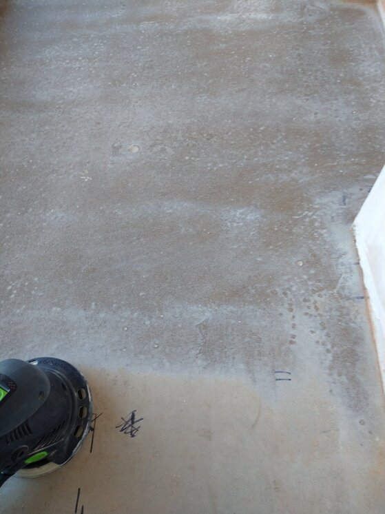

Up front, it's a self build - my 4th, so done a fair bit but 1st time using anhydrite.
Screed down for 4 years+. Prepping for ditra. Started sanding with 40 grit using 6"festool orbital to remove laitance - solid - (so may have to use diff tool).
Issue I have - surface (when sanded with 40 grit) is a tough mushroomy colour - I can see whitey/ creamy colour aggregate beneath it where the air bubbles have burst.
Before sealing do I need to take off top mushroomy coloured surface to reveal agg beneath? -
Mushroomy surface is solid and we'll bonded to agg beneath - hard to even scratch it with screwdriver - my common sense brain is telling me that primer will bond well with top surface as is - so why remove and expose the more fragile agg beneath.
Appreciate your thoughts

I'm happy to do the work - it's part of what I do - just don't want to remove what I think is a good solid bondable surface - guess my concern is that primer won't penetrate surface & therefore surface liable to debond from the screed - maybe just overthinking - wouldn't be first time.

To use “traditional” prep methods The surface needs to be clean sound and absorbent. As the surface is currently solid it is definitely sound. Clean … well that’s fairly straight forward… A simple test for the level of absorbance is the water drop test. Get a few drops of water (you could use perhaps a spent lateral flow test bottle or similar) to put a few drops of water on the surface of the screed. It should soak in pretty much immediately. This, when you prime it allows the water in the primer to dial in pulling the polymer in as well. If the water sits on top of the surface for more that a couple of seconds it’s not absorbent. You can get specialist primers for non absorbent surfaces but I’ve never had much success with them. So you are best to sand/grind it to open up the surface a little and make it more absorbent.

If you heat slowly then it should be fine. I would deffo sand it though for an acrylic primer method.

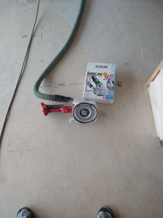

Passes water drop test no prob. Gone for a Weber primer/ sealer & SPF.
I'll crack on with the 40grit as planned

In case it may help someone I ended up using a grinding cup on a 4" grinder attached to hoover via a dust collector. I had forgotten I had these. Took no time at all just a matter of keeping the grinder level & moving at steady speed - backwards & forwards easier to control the grind that arcing from side to side.
