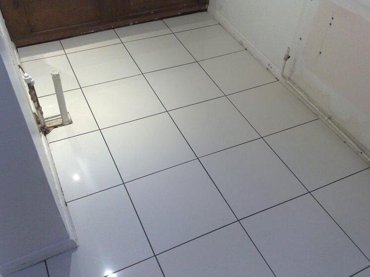

wasnt looking forward to my first time laying this,but it was a breeze
worked very clean,didnt seal before laying, but when they were down
applied LTP impregnator with a sponge mop effort, nice to work standing up, grouted ,washboy ,cleaned up real nice with J-cloths ,then sealed again and buffed
i think i read another post a few weeks back where someone had no bother with these too,steve
