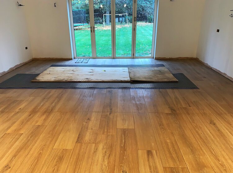

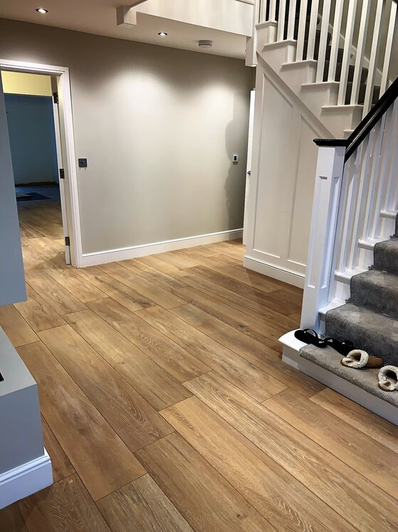

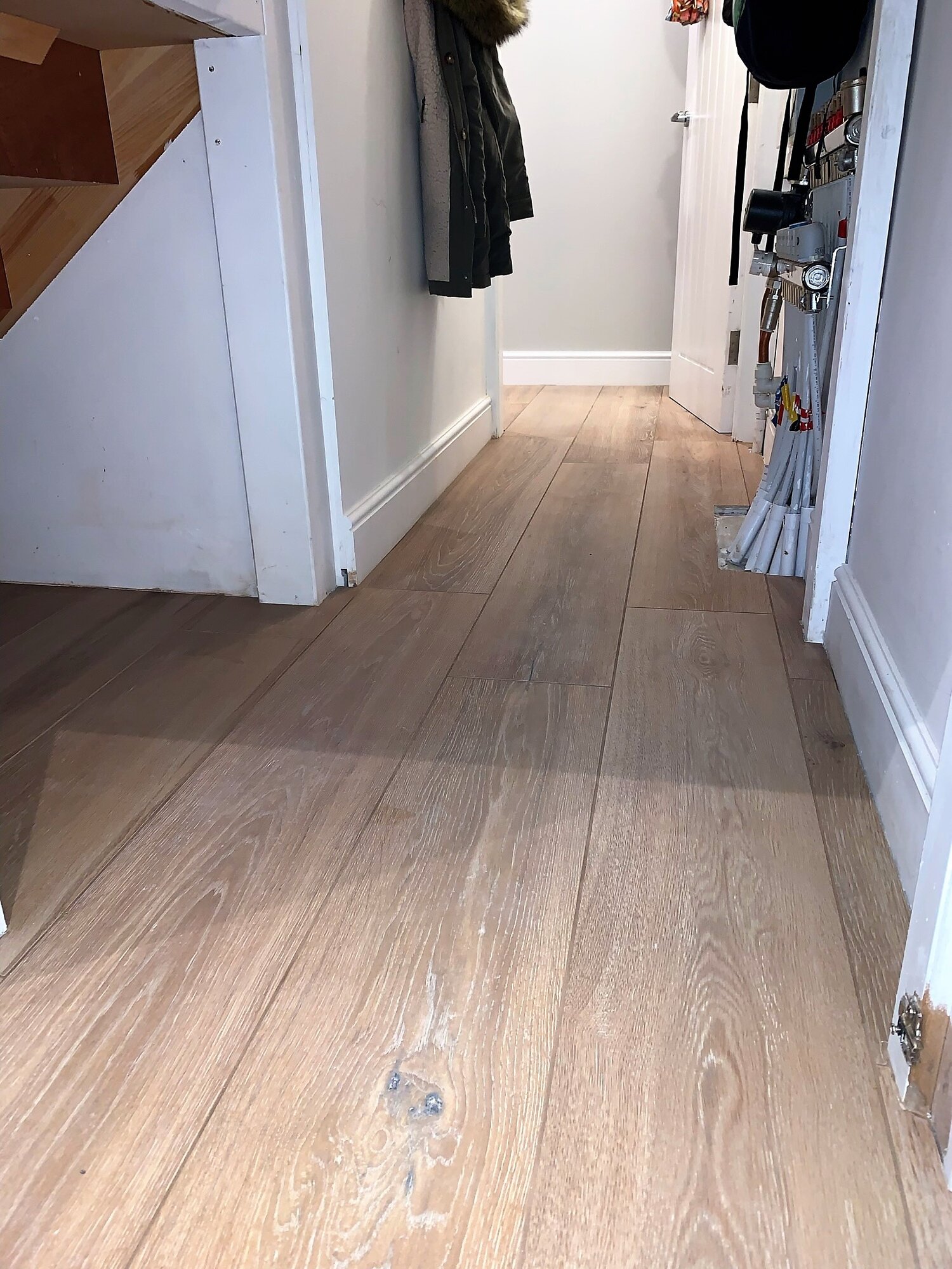

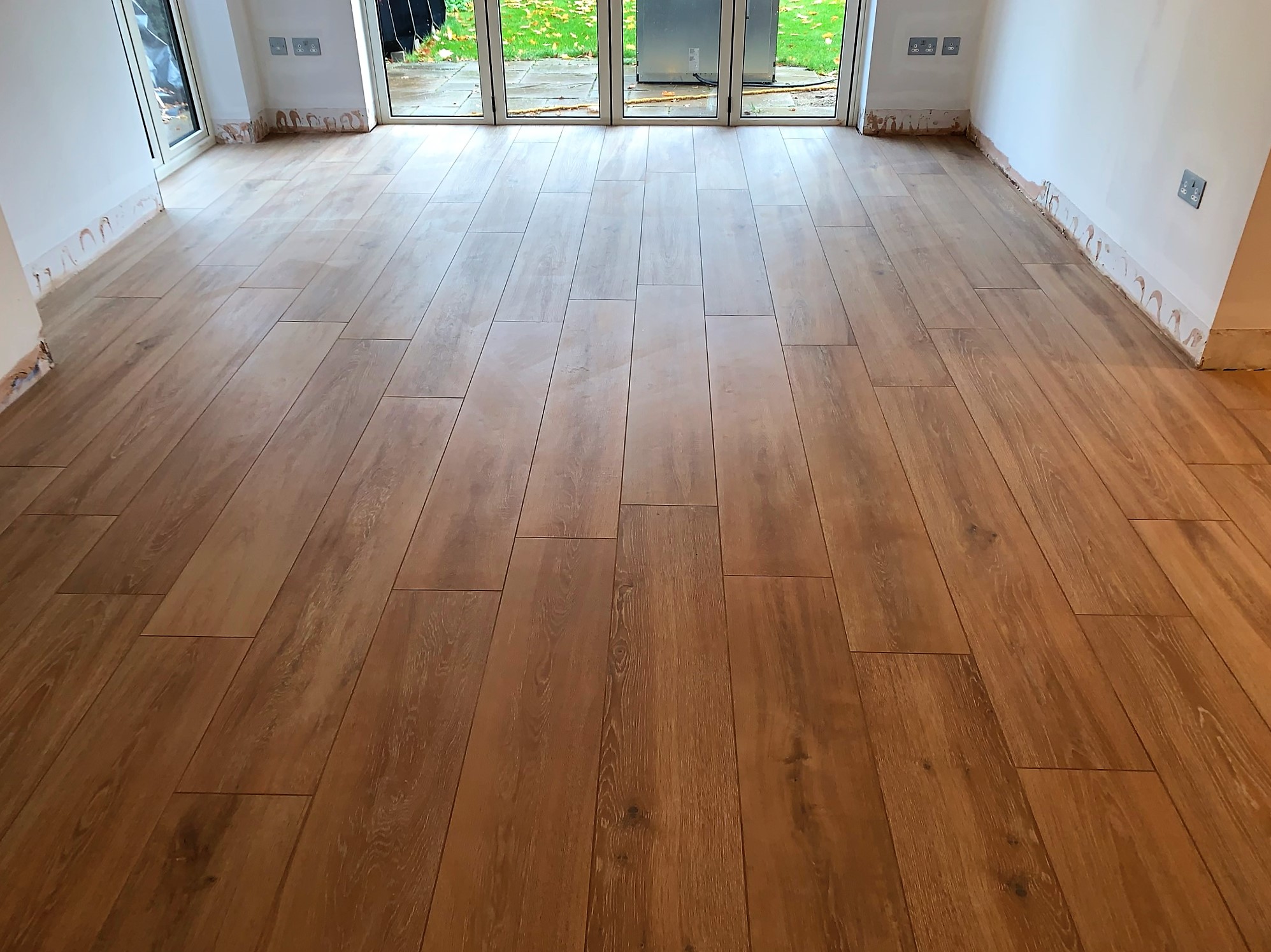

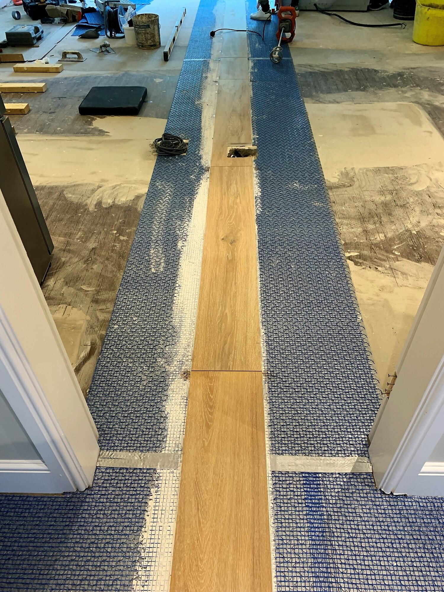

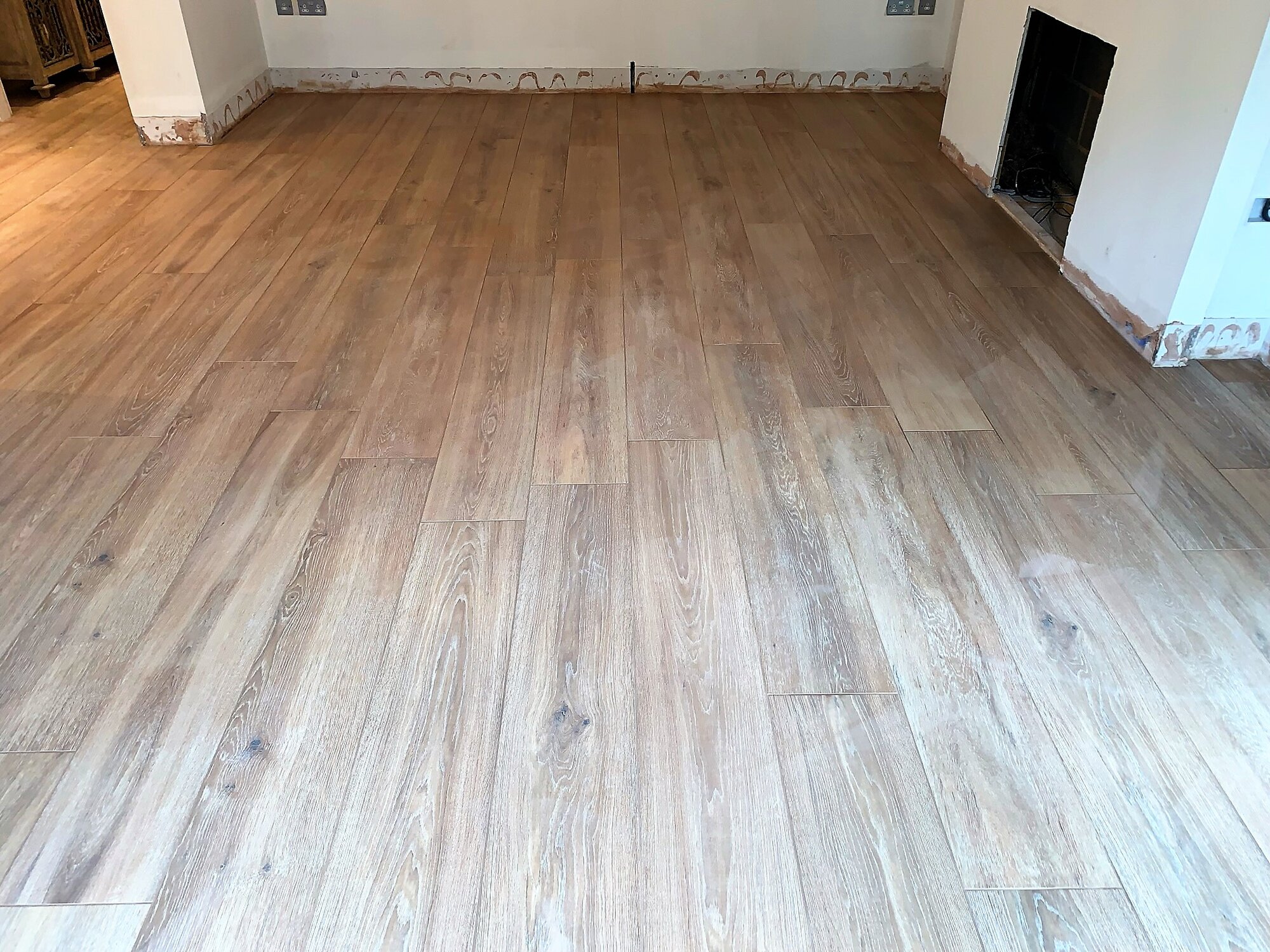

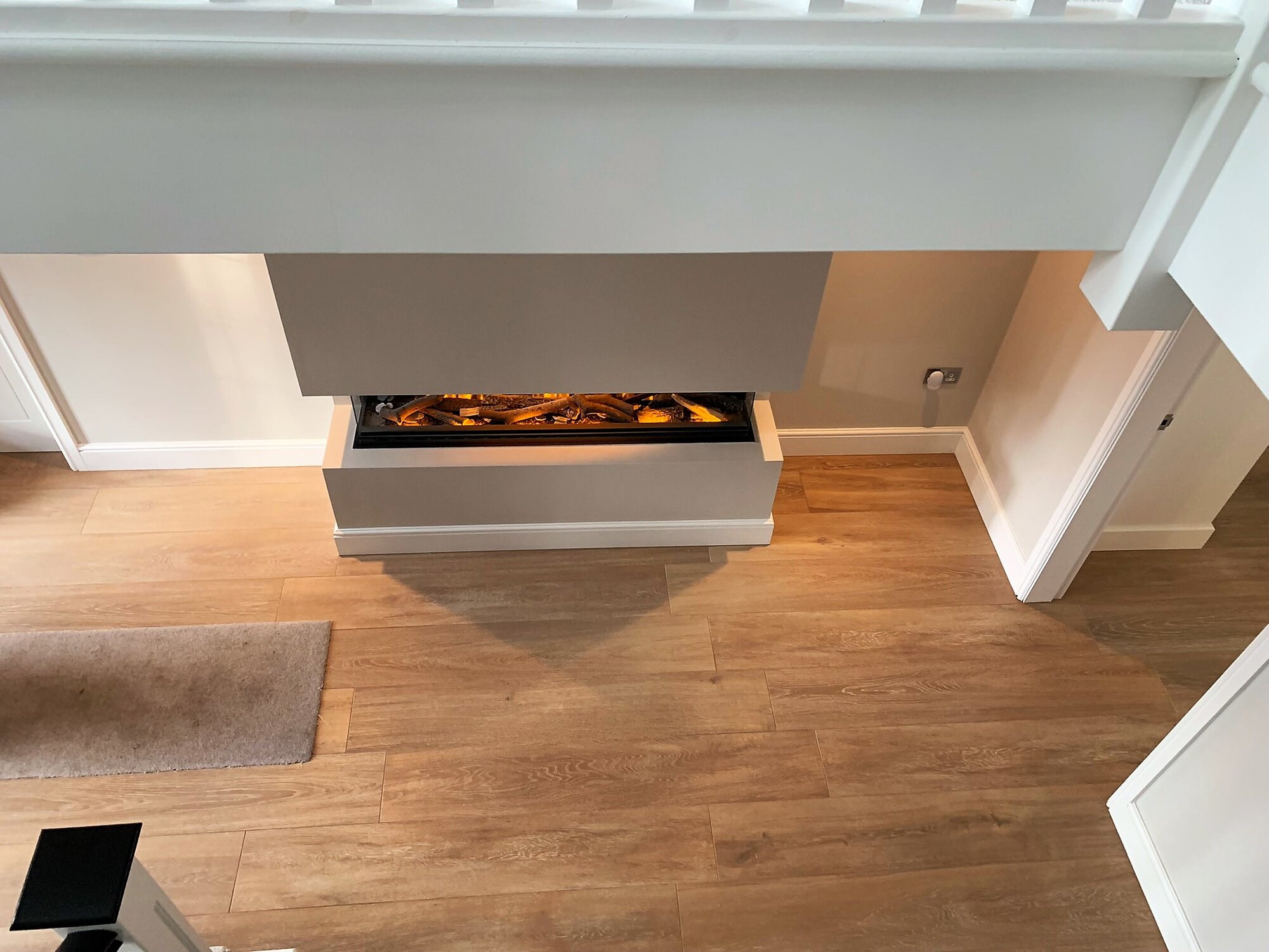

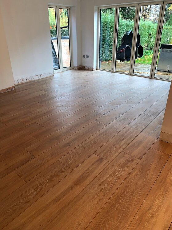

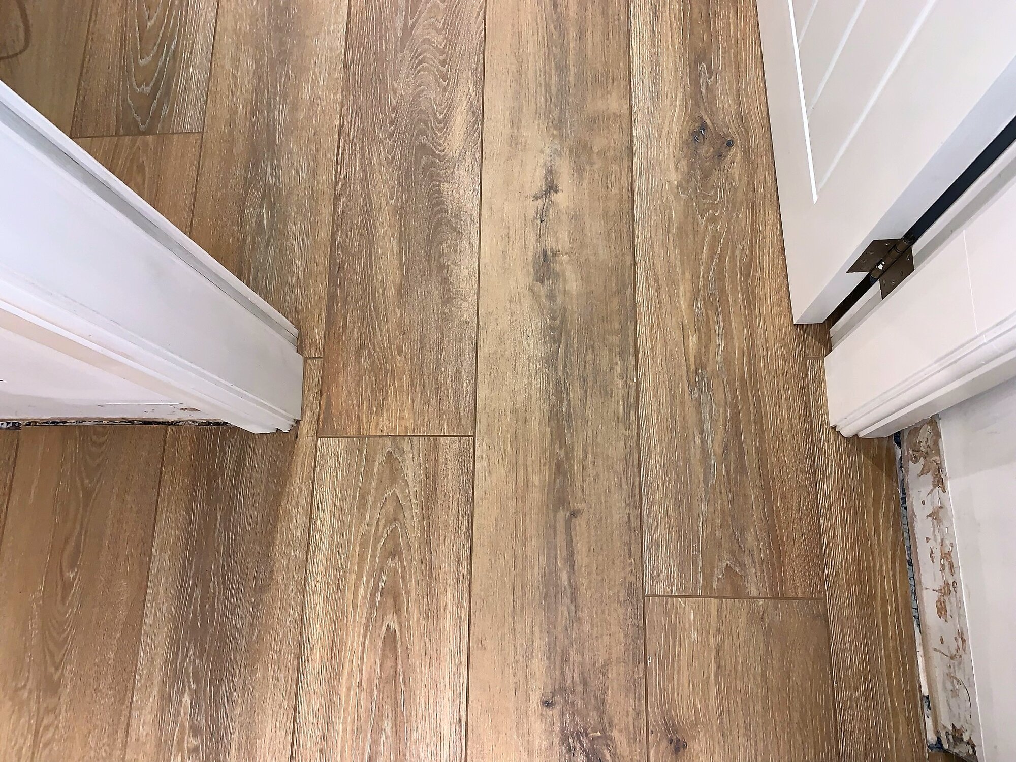

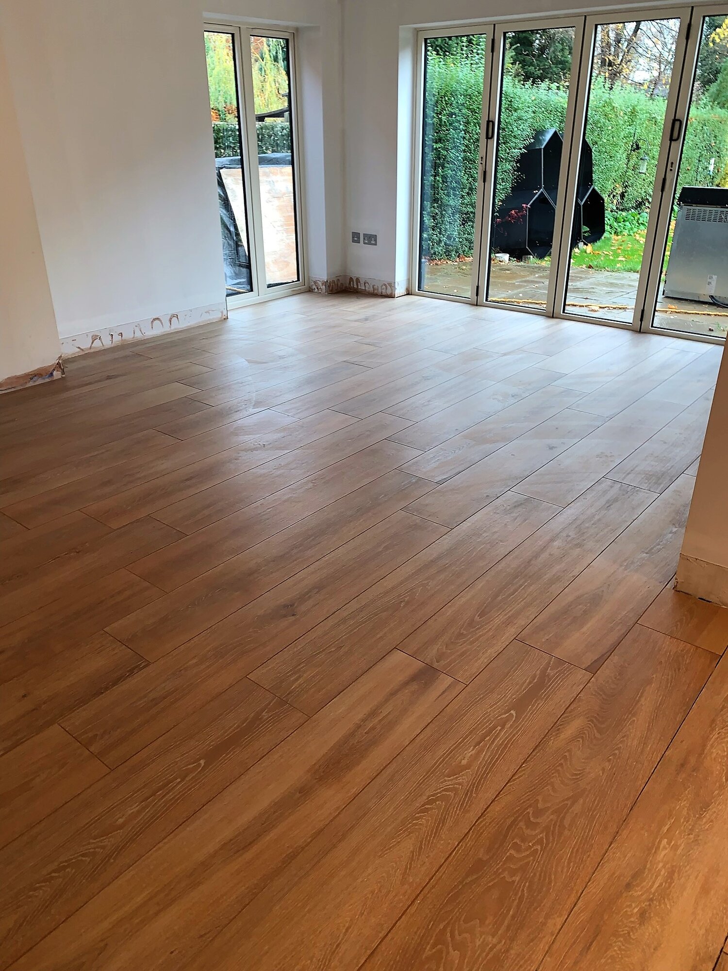

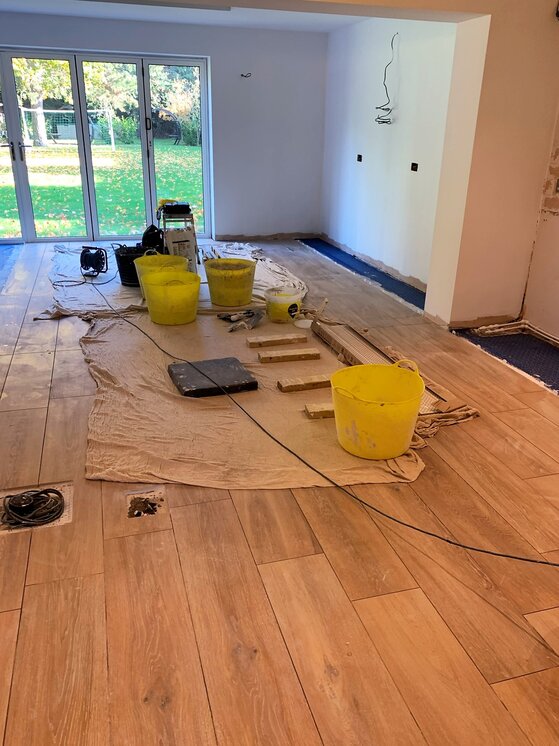

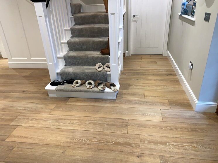

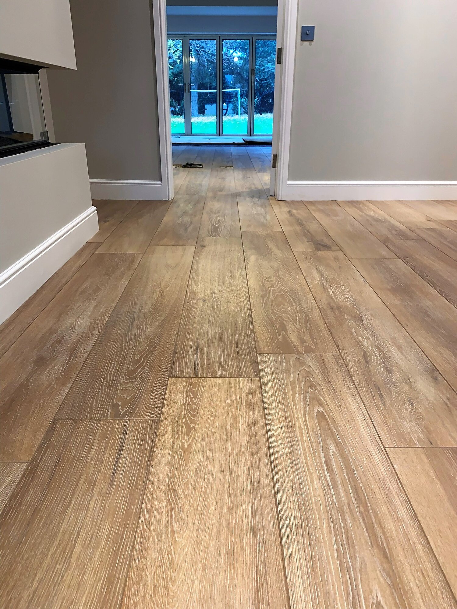

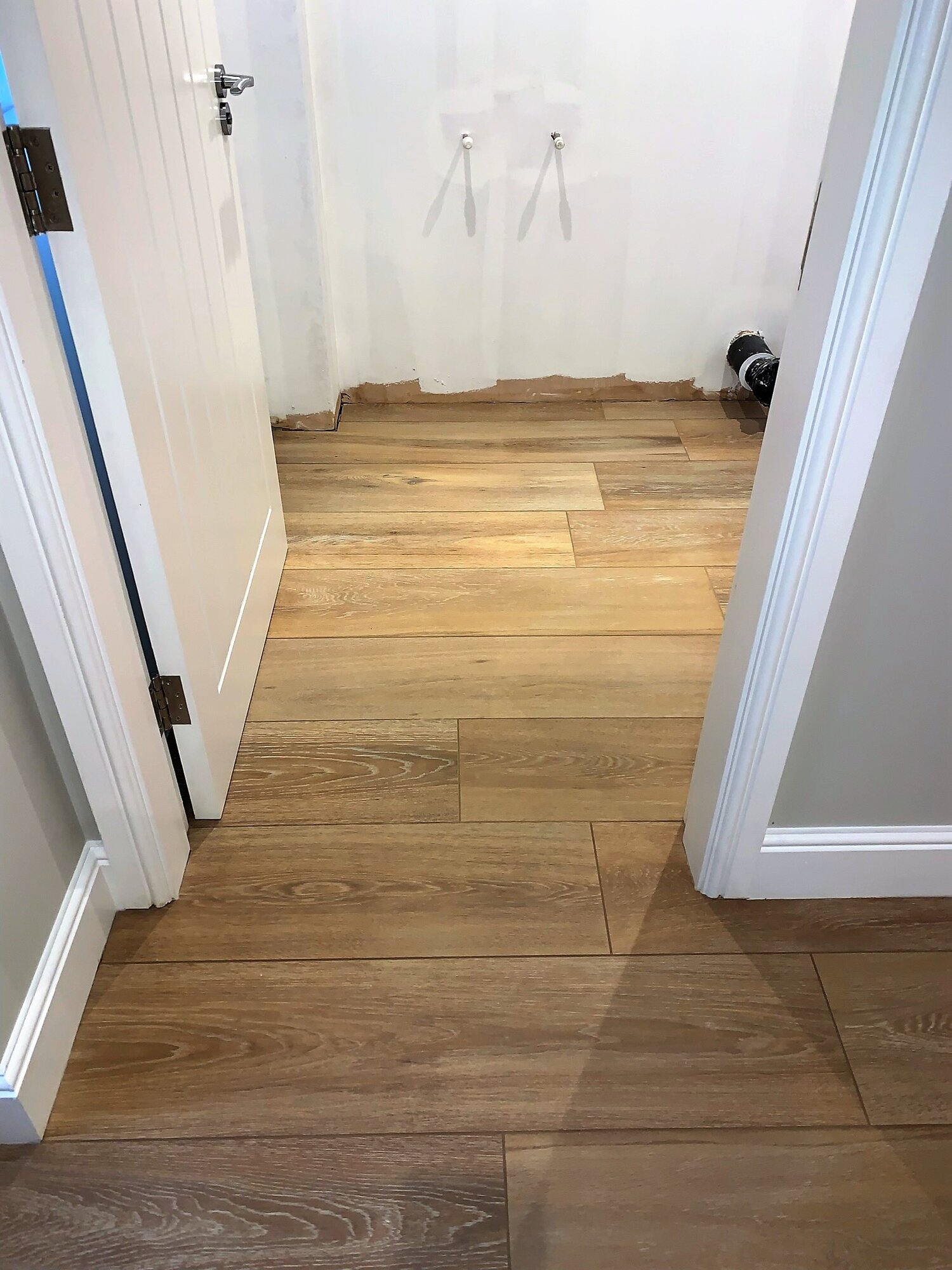

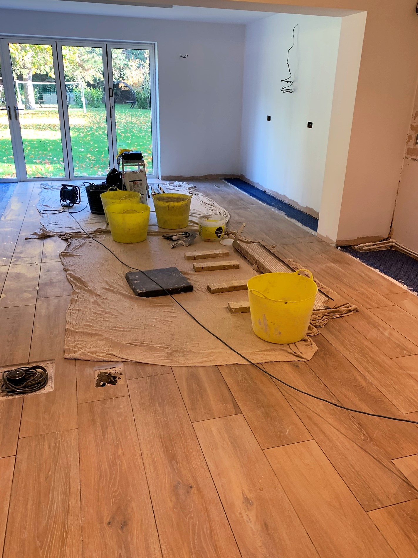

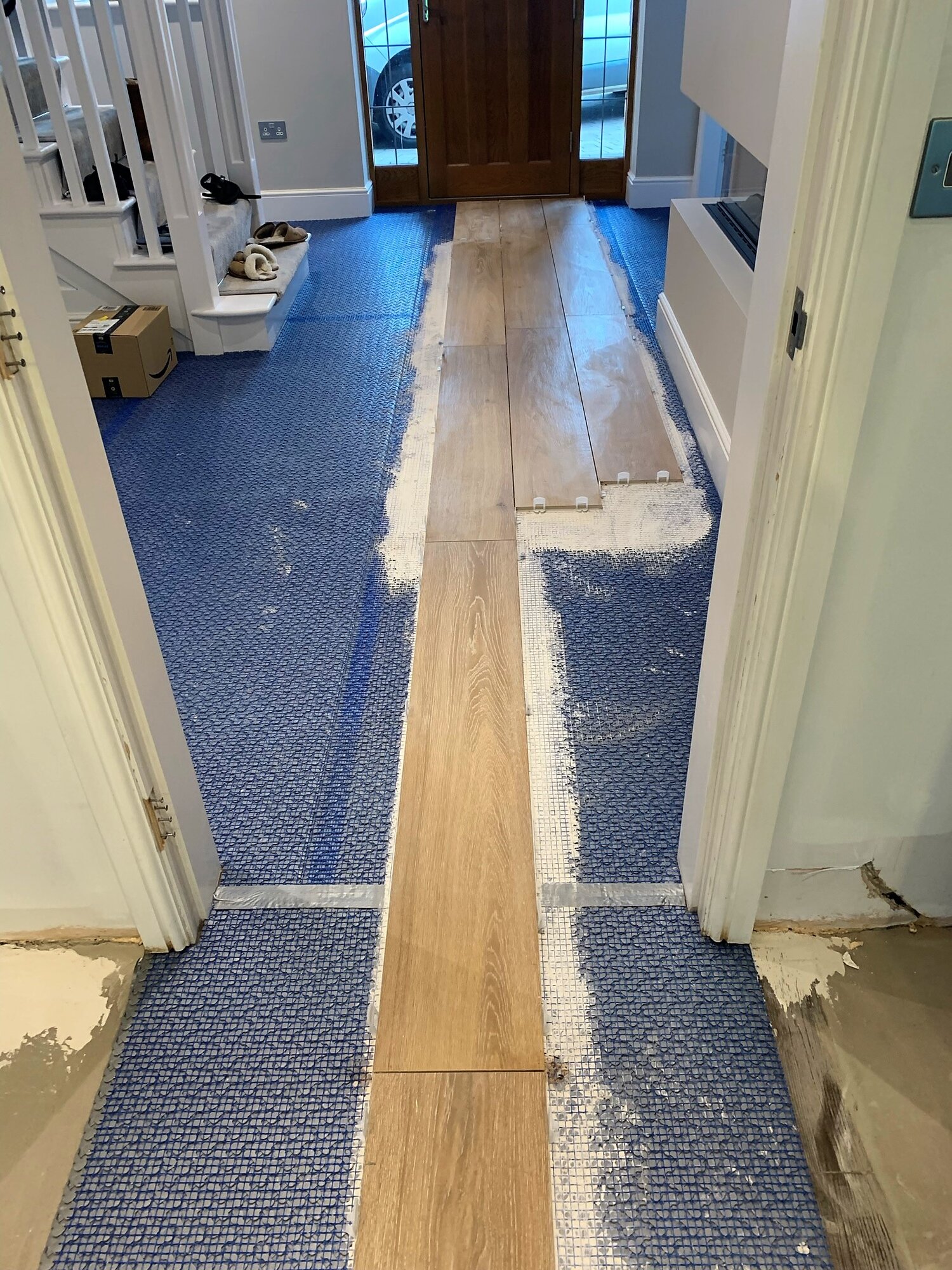

I finished the job end of last year. BAL guys came out to moisture test the extension and got the go ahead to crack on.
Did spend 4 days grinding the odd high spot and used 5 bags of SLC to level areas where old units were till I was happy and confident enough it was all in spec for using the Flexbone.
How did I find the Flexbone?
Expensive but brilliant product. Would definitely use again.
