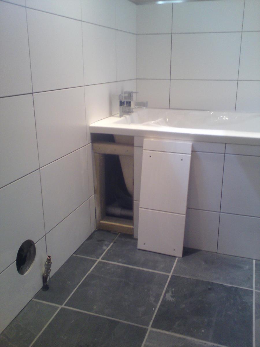

I constructed a bath panel last week using hardibacker onto framework leaving access for taps. On the pics they show before and after grouting and I am going to be using Silicon down access panel for easy removal if required :thumbsup:

And how unsightly do those screw fixings look.. not saying it is wrong.. but i prefer the nice clean look.. but as i said , down to choice with each customer.
Yeah I know what your saying Dave but I would always rather gain access just incase there is ever a problem in the future. I'm not saying I would do that in my bathroom but just an example
IF you have to do an access panel.. then use magnetic fixings and Silicon the joint same colour as the grout.. then you just slice the joint to open up.. 🙂
Yeah I'll have to look into those magnetic fixings Dave!! Never used them before and would look alot better than those unsightly screws as you call them :smilewinkgrin: :thumbsup:
thanks for the pics great help.
i can see how your frame was constructed on this side of the bath. how do you support and fix on the other corner of the bath. hope you get what i mean.
All constructed from 4x2". Fixed to the wall both sides and fixed to the floor. I have vertical 4x2 pieces where the access panel is and another middle-ish and both ends. When fixing make sure it is back far enough to leave enough room for plaster/cement boards so the tile will either run up under the lip of the bath or sit flush. I made mine so it was flush
