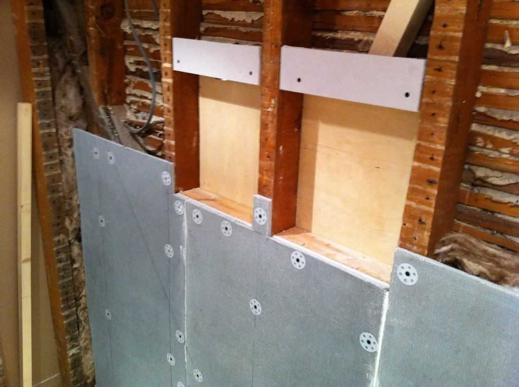

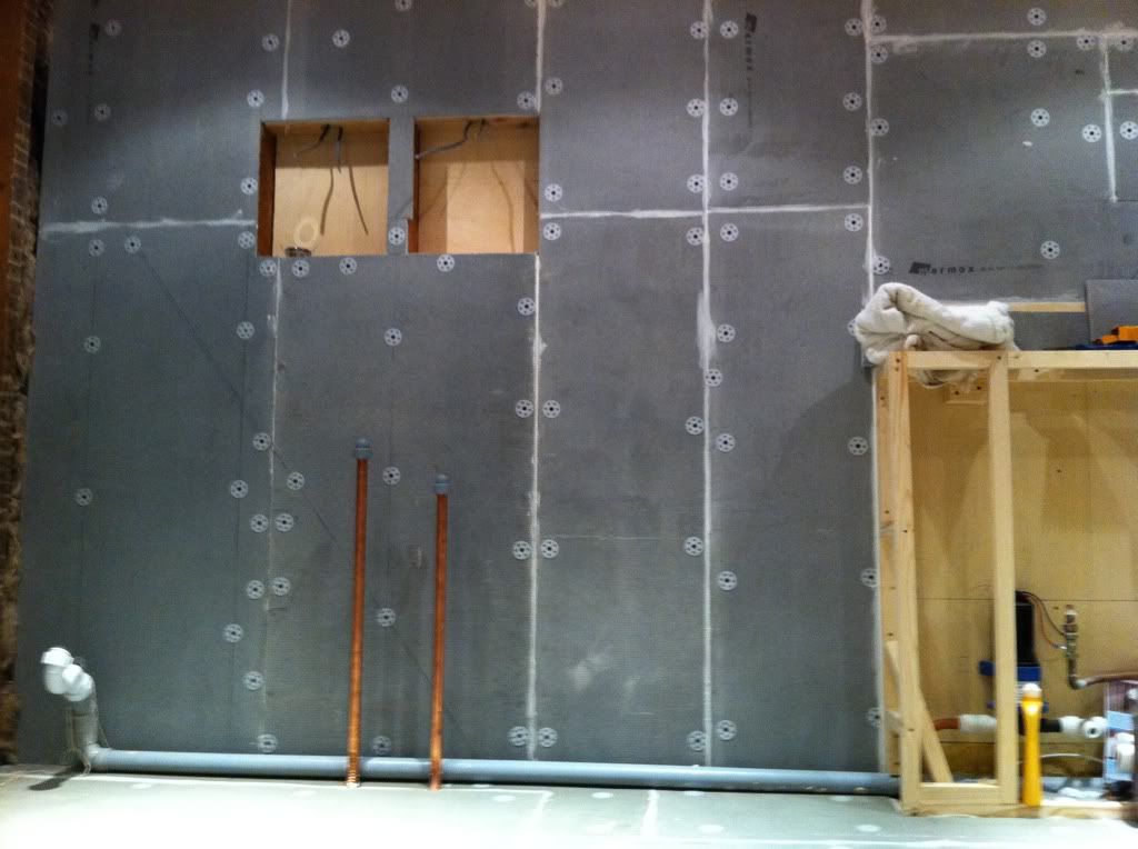

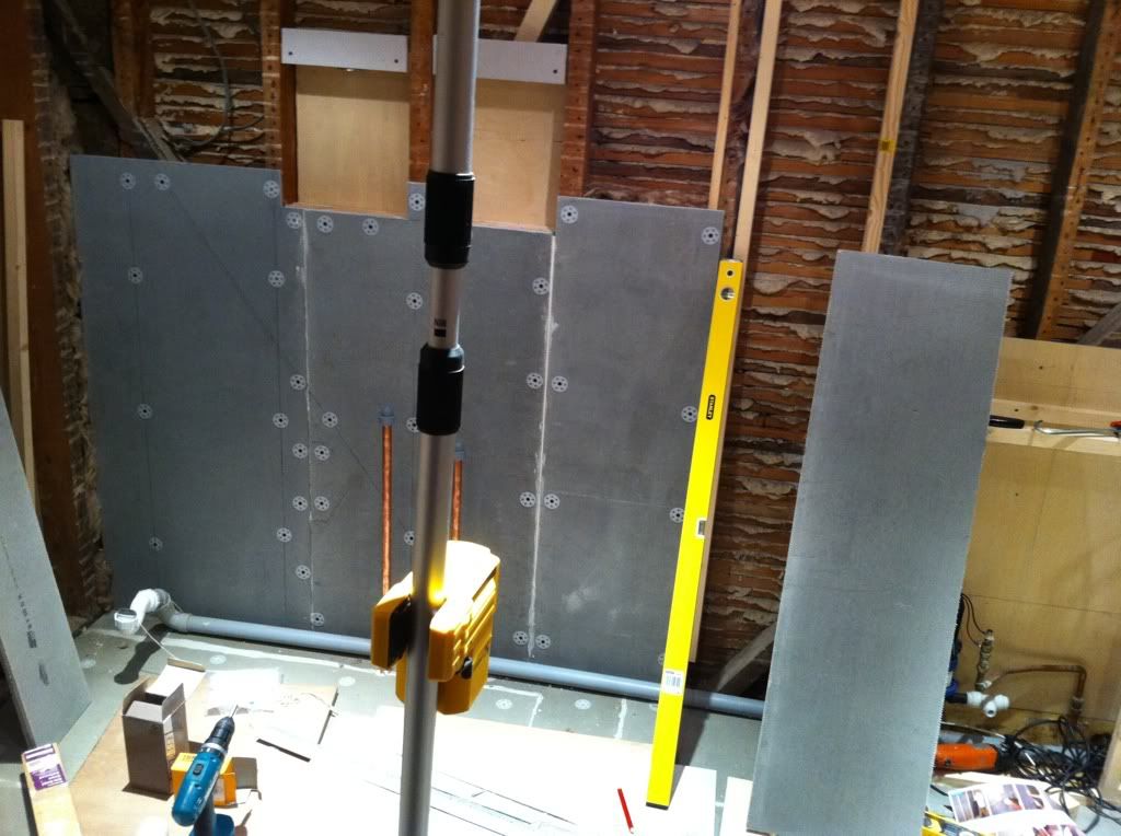

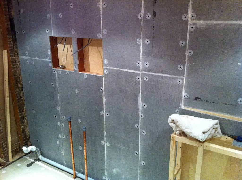

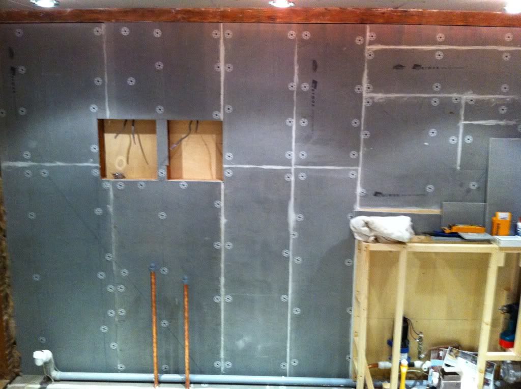

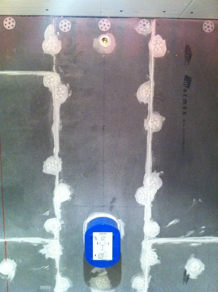

next step.. laying the marmox boards and tanking!
