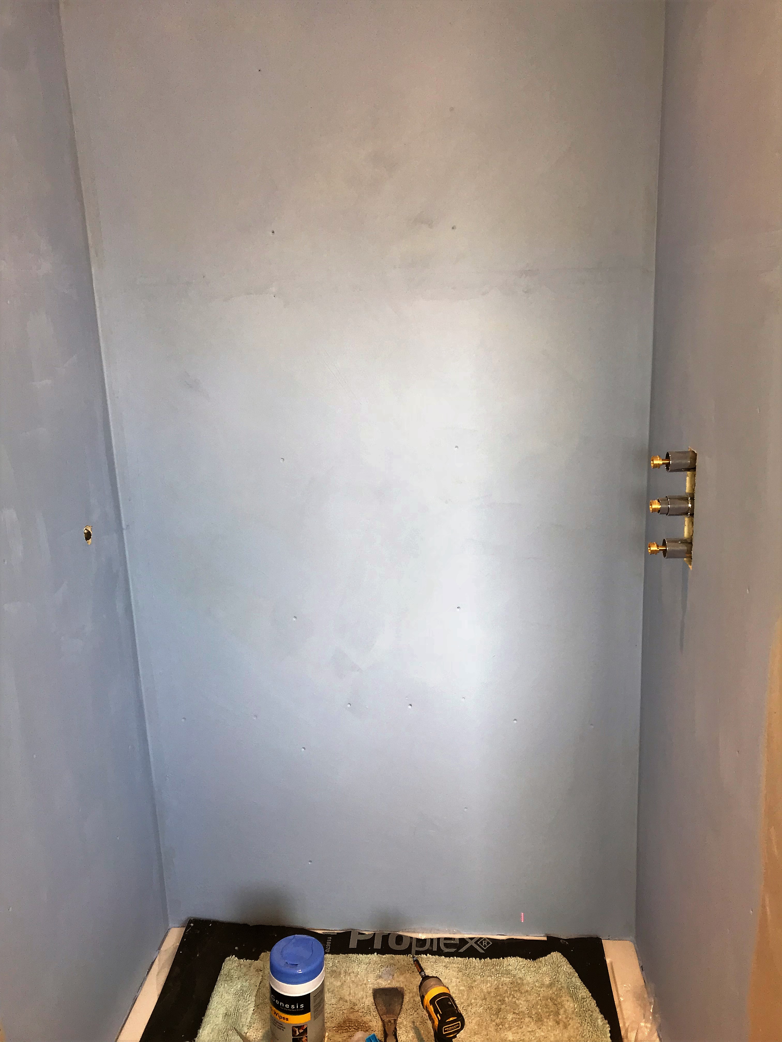

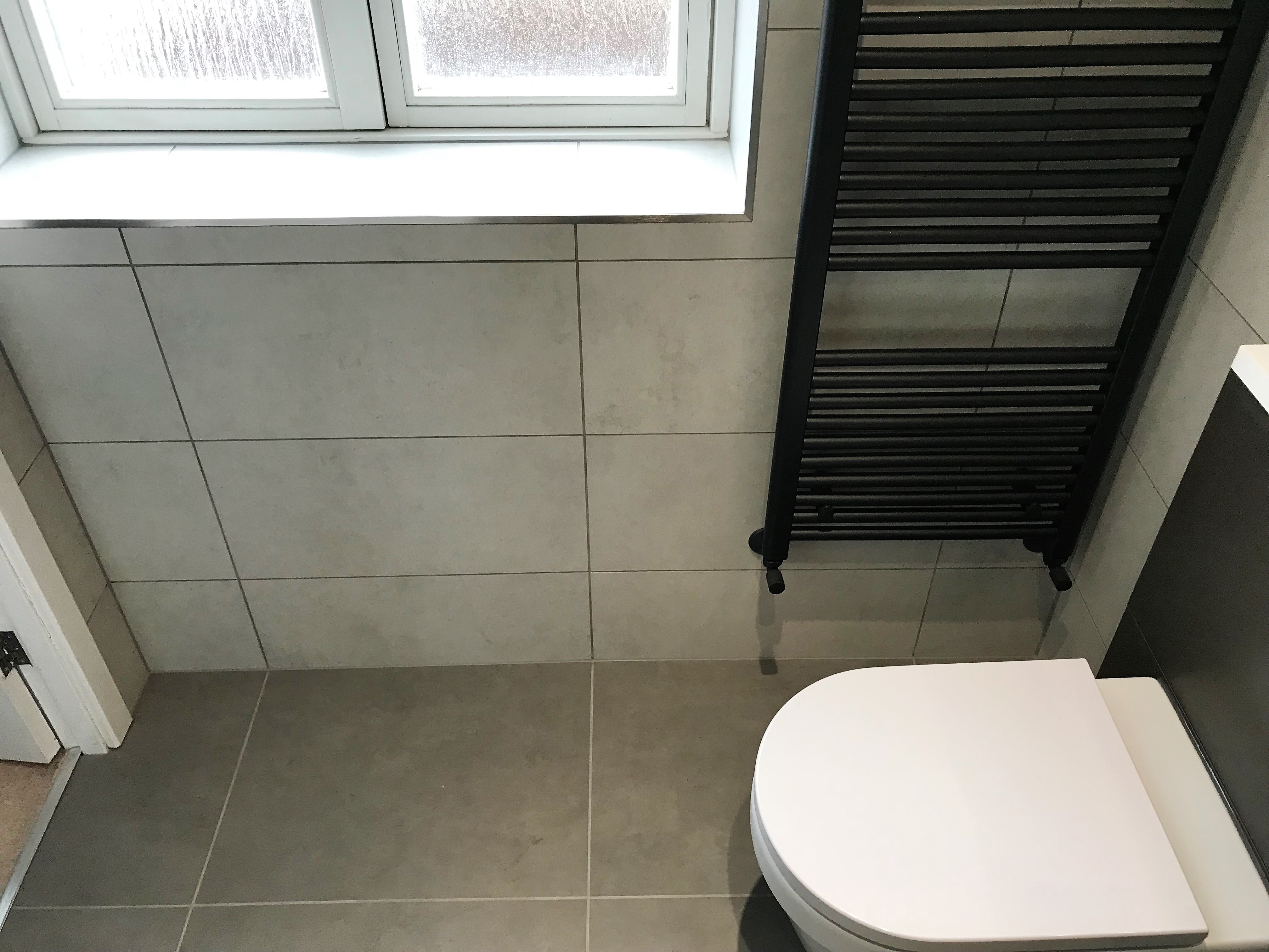

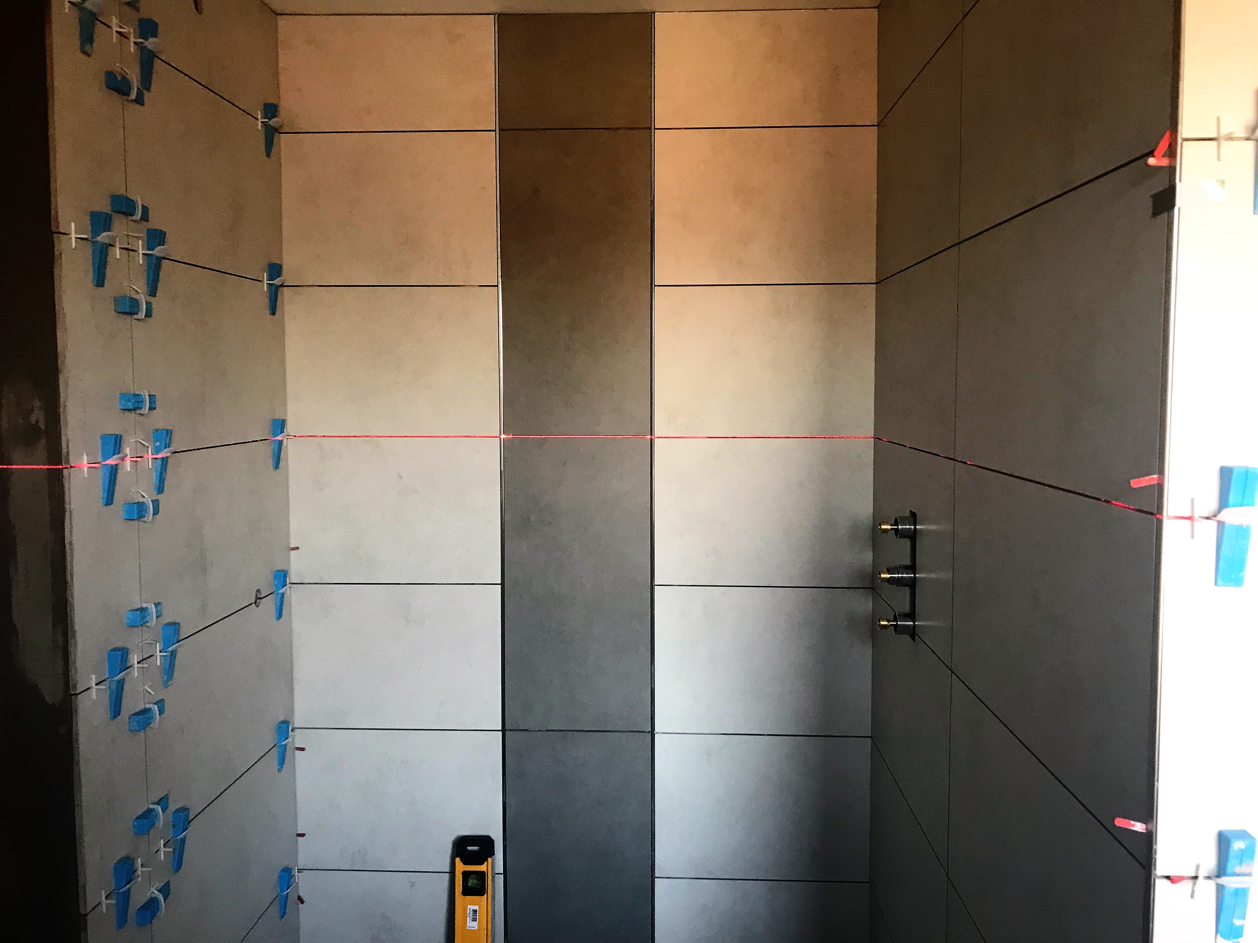

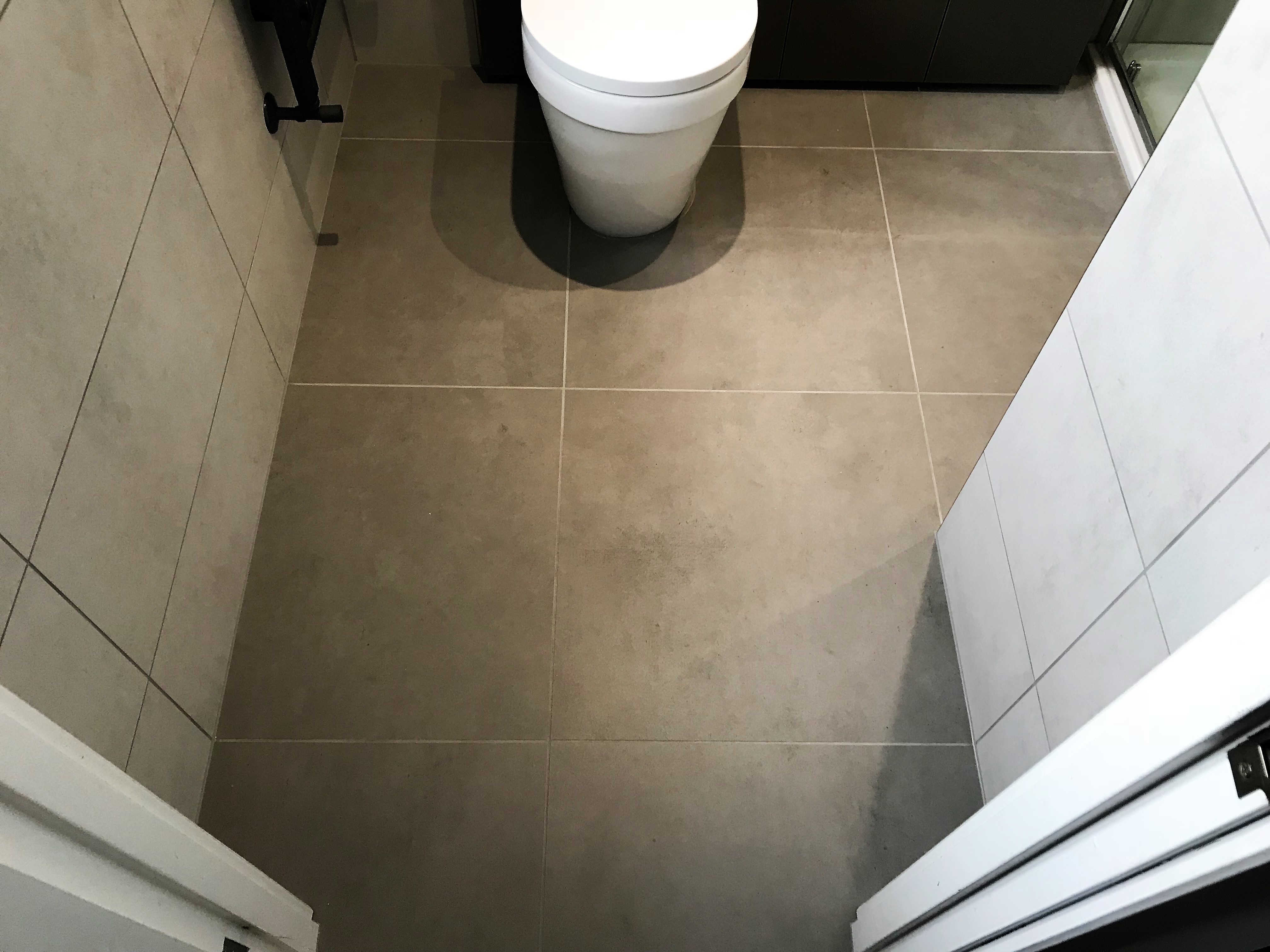

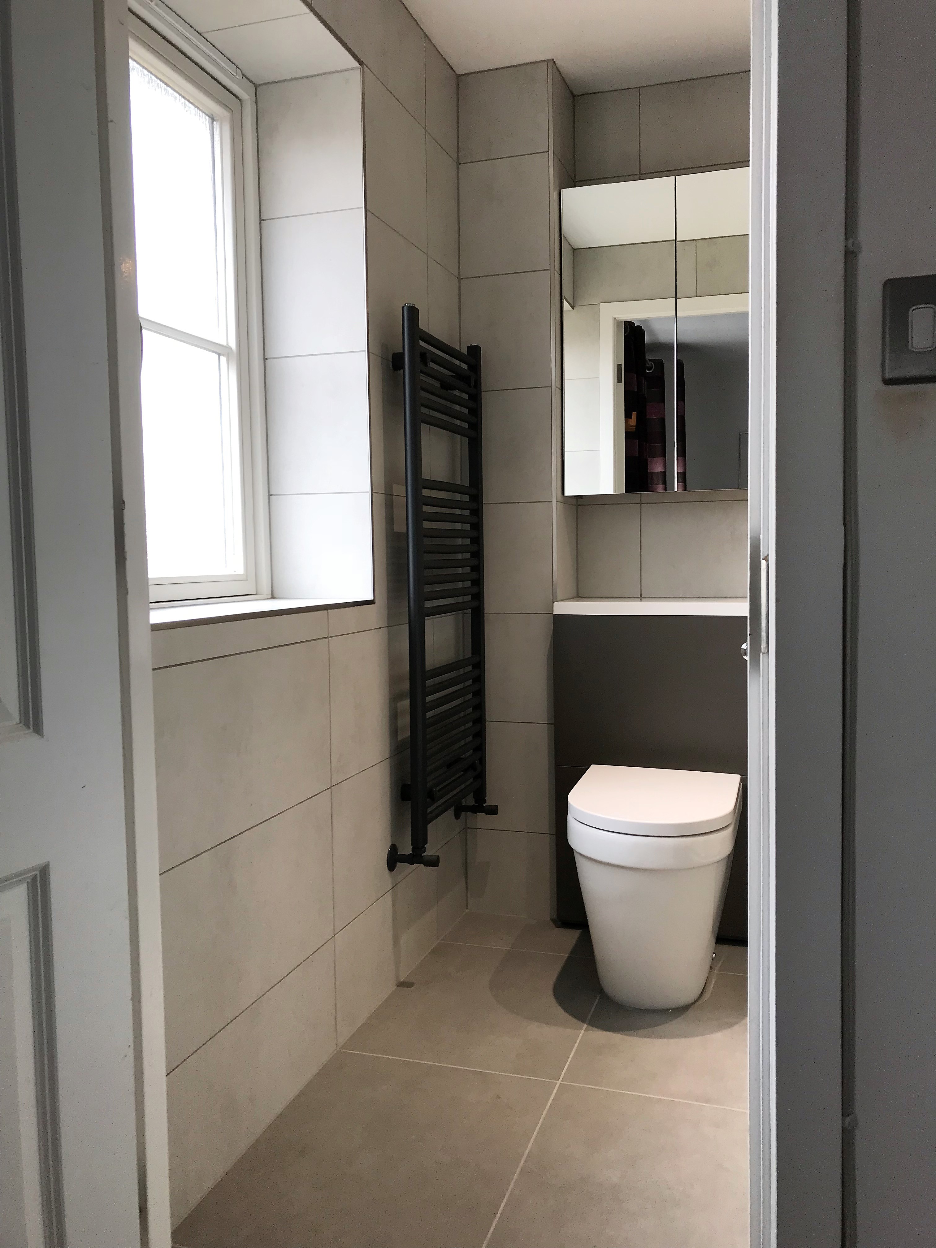

Tiles are rectified 60x60 floor and 60x30 wall and the sizing is spot on and the room allows for joints to match up without silly compromises. I can count on one hand how many times that's happened for me.

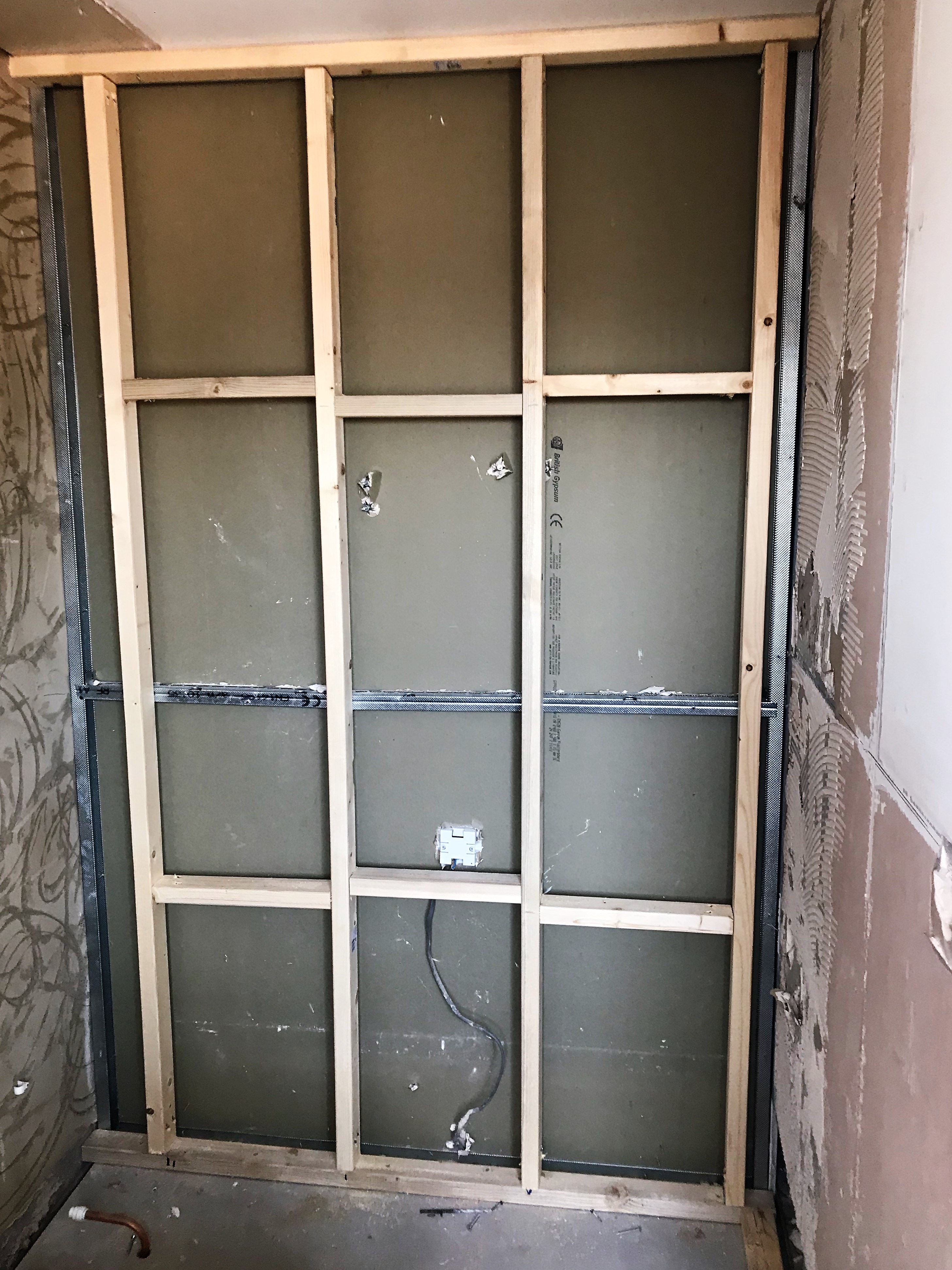

So today set out walls on the vertical to get my floor set out and got them fixed.

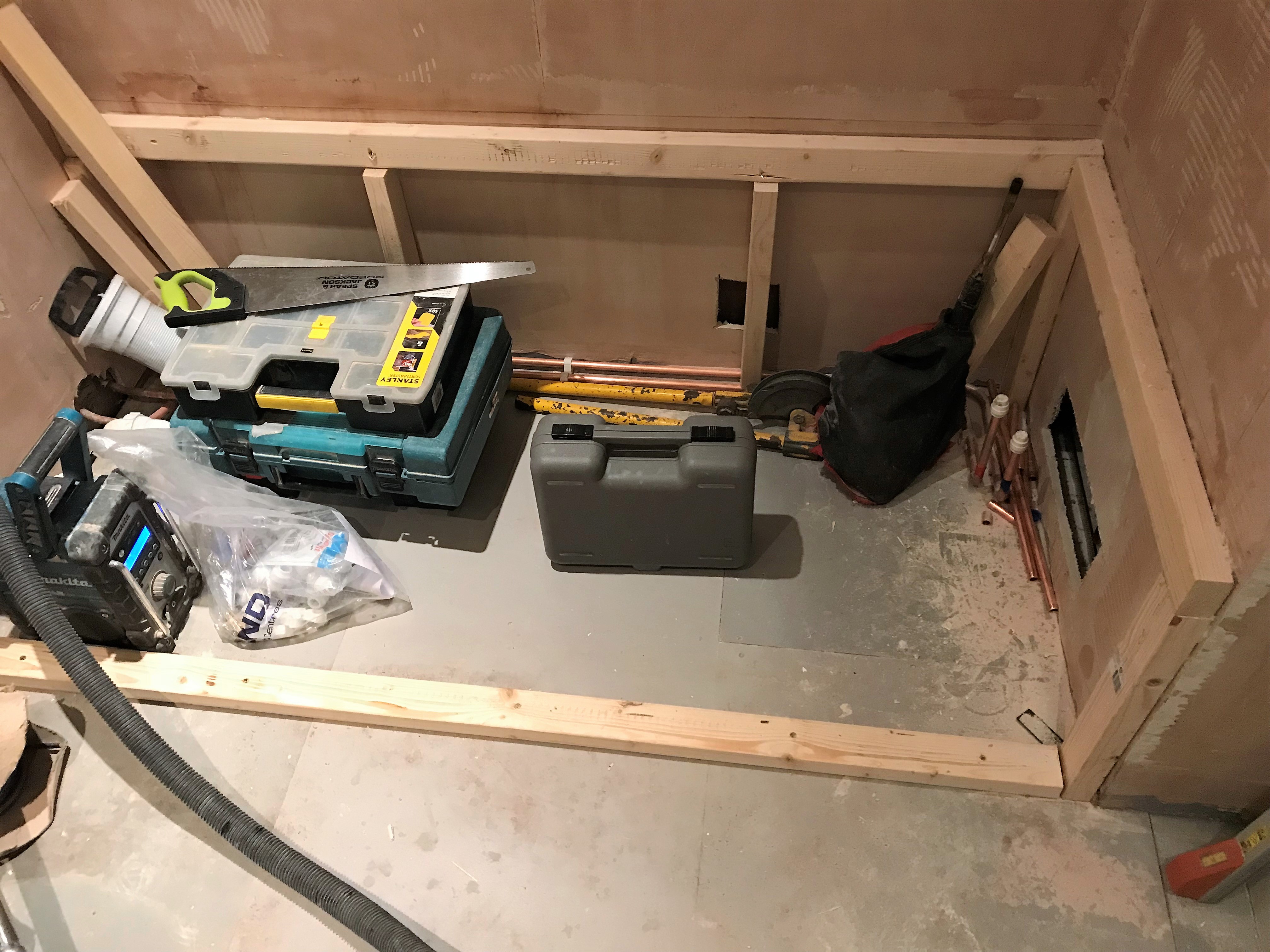

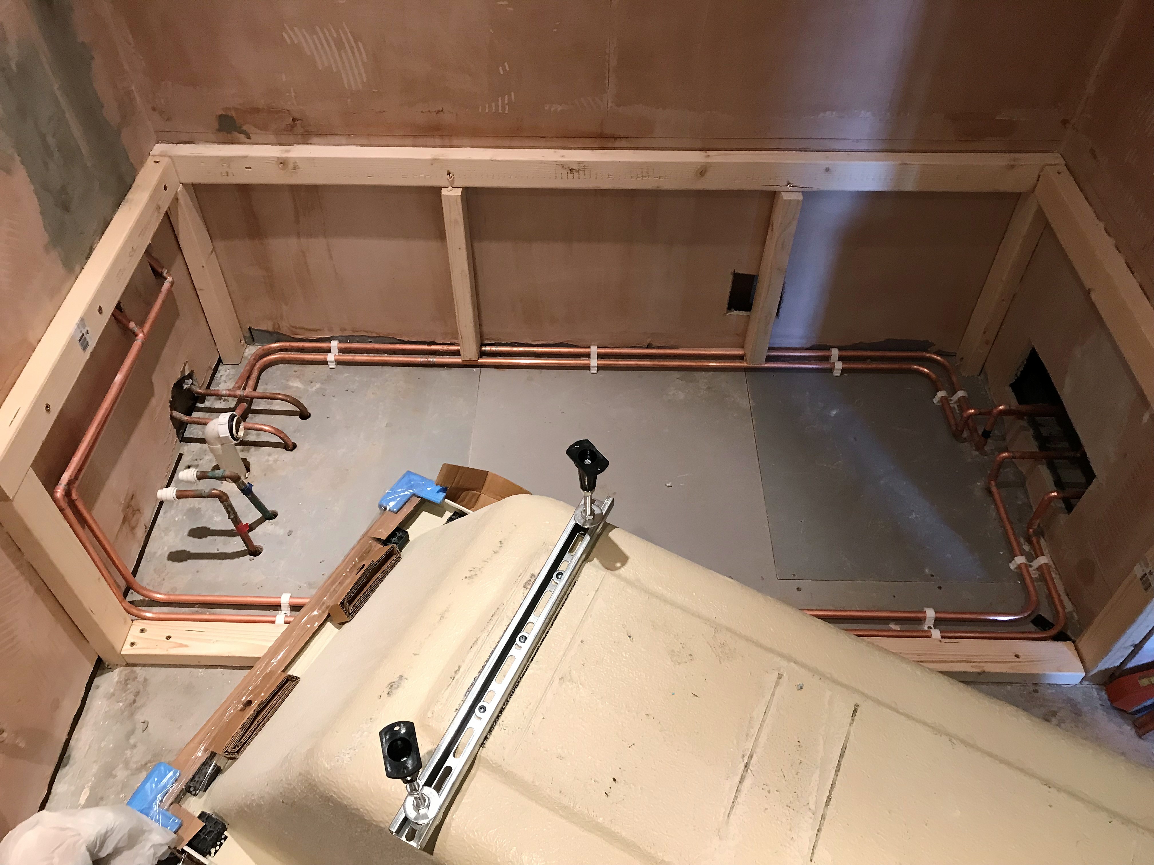

Nice job macten! That bath is going nowhere. Lost count of the amount of times I have walked into someone else's work and the bath isn't strapped.
The one I took out had nothing, no battens, no Silicon and not even those useless little wall brackets that sometimes get supplied.
