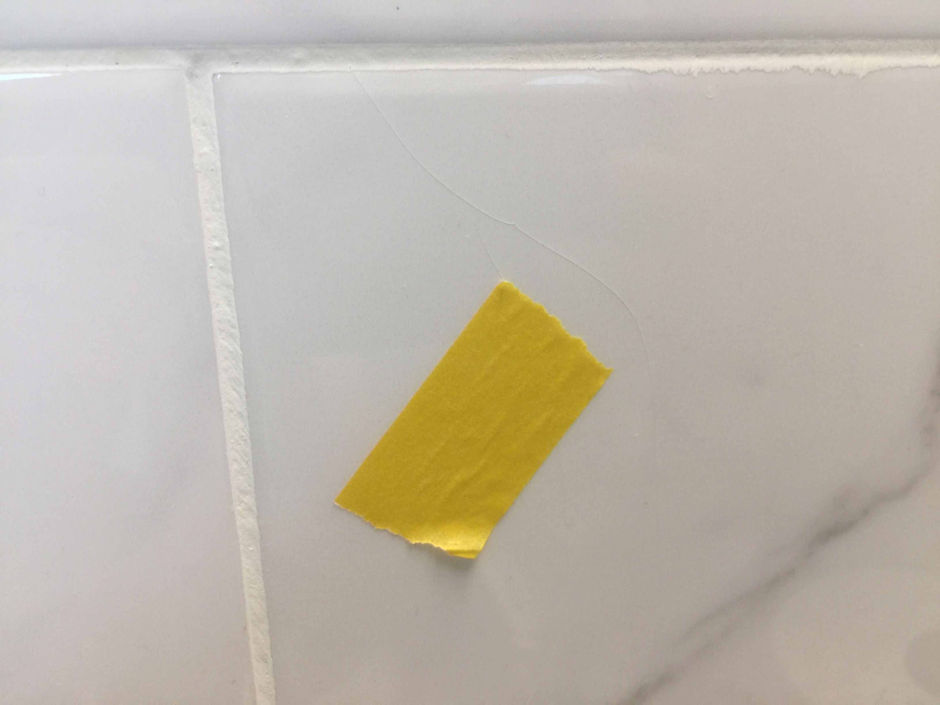

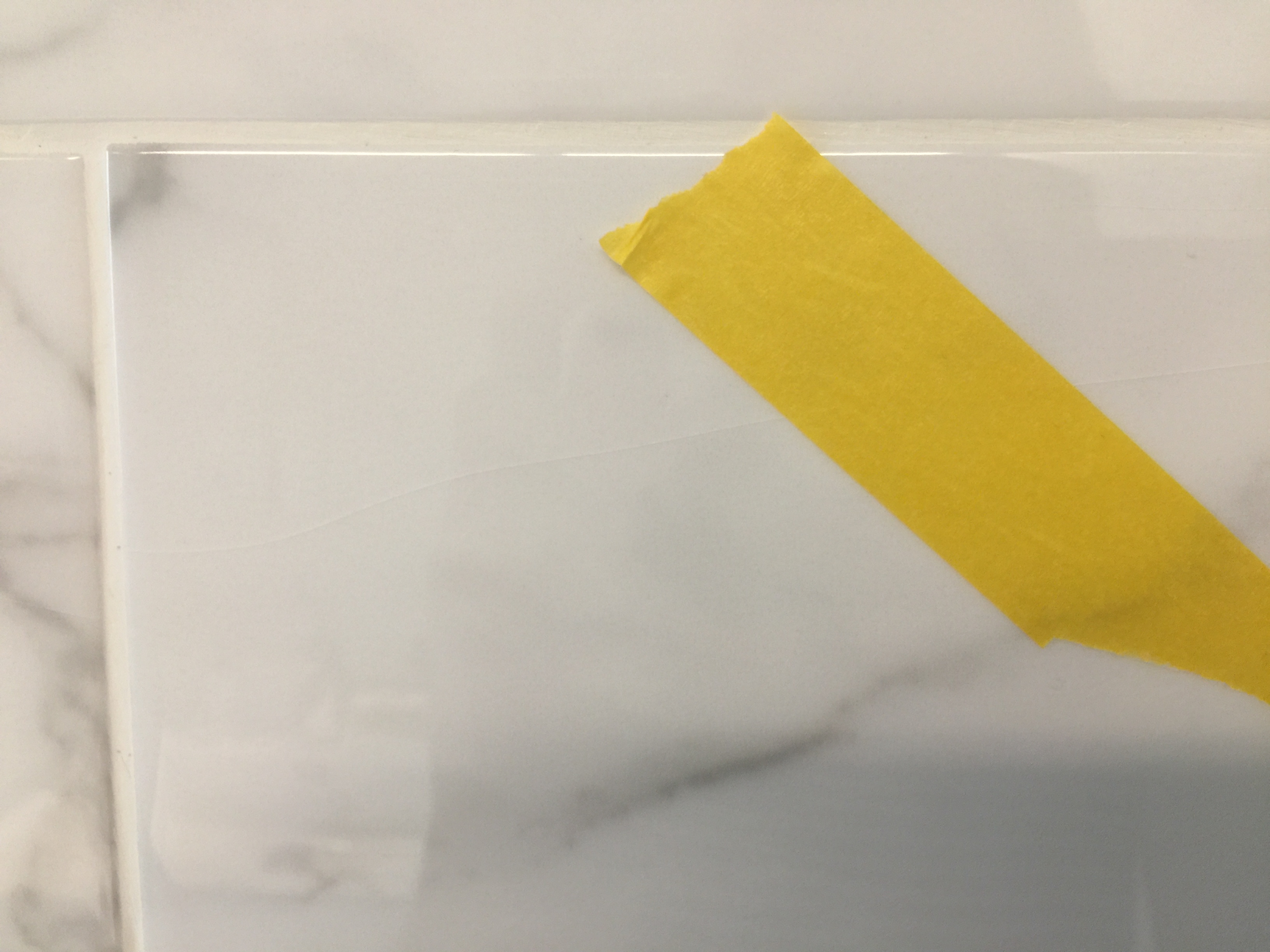

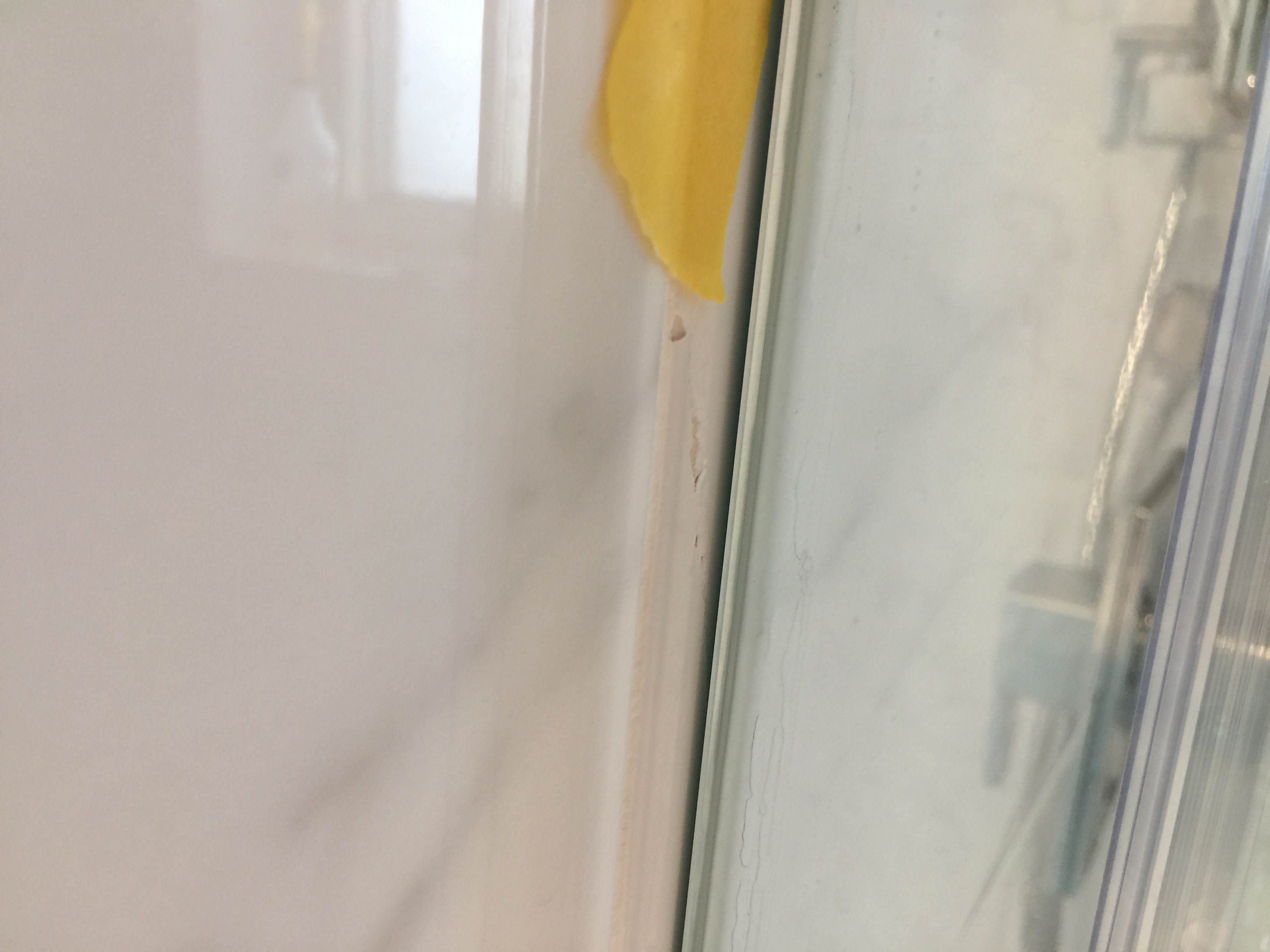

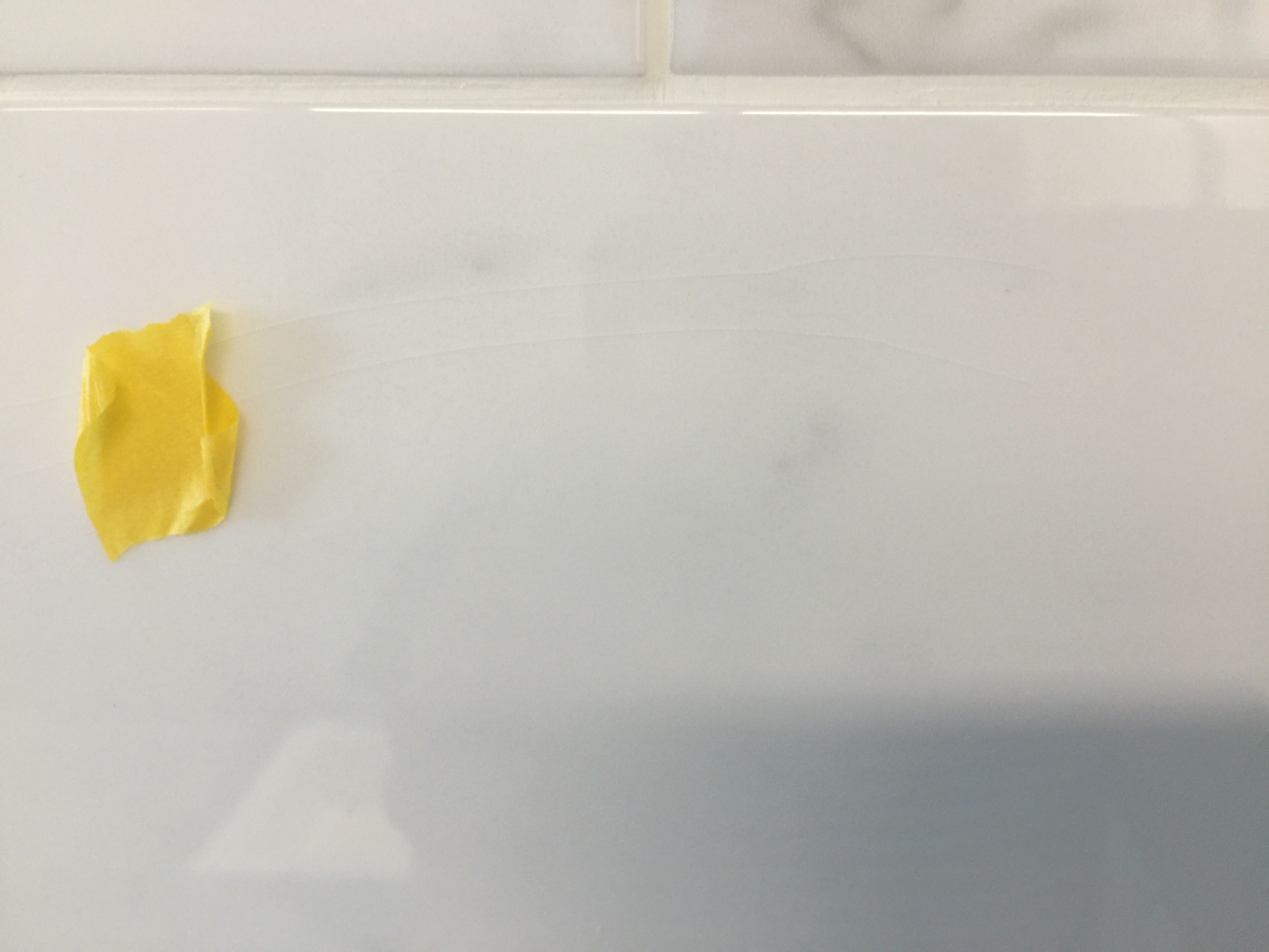

We completed the renovation in December 2017. Six weeks later, in Feb 2018, I started noticing small cracks in the wall tiles (both inside the shower and out). There was one that first showed up that went across two tiles, but another one that just appeared in the middle of a tile and looked like a crescent moon.
We spoke to the GC and agreed to keep an eye on things to see how bad the situation was. Now it's been 2 months and it's definitely getting worse. More cracks are appearing everywhere and the existing cracks are getting larger.

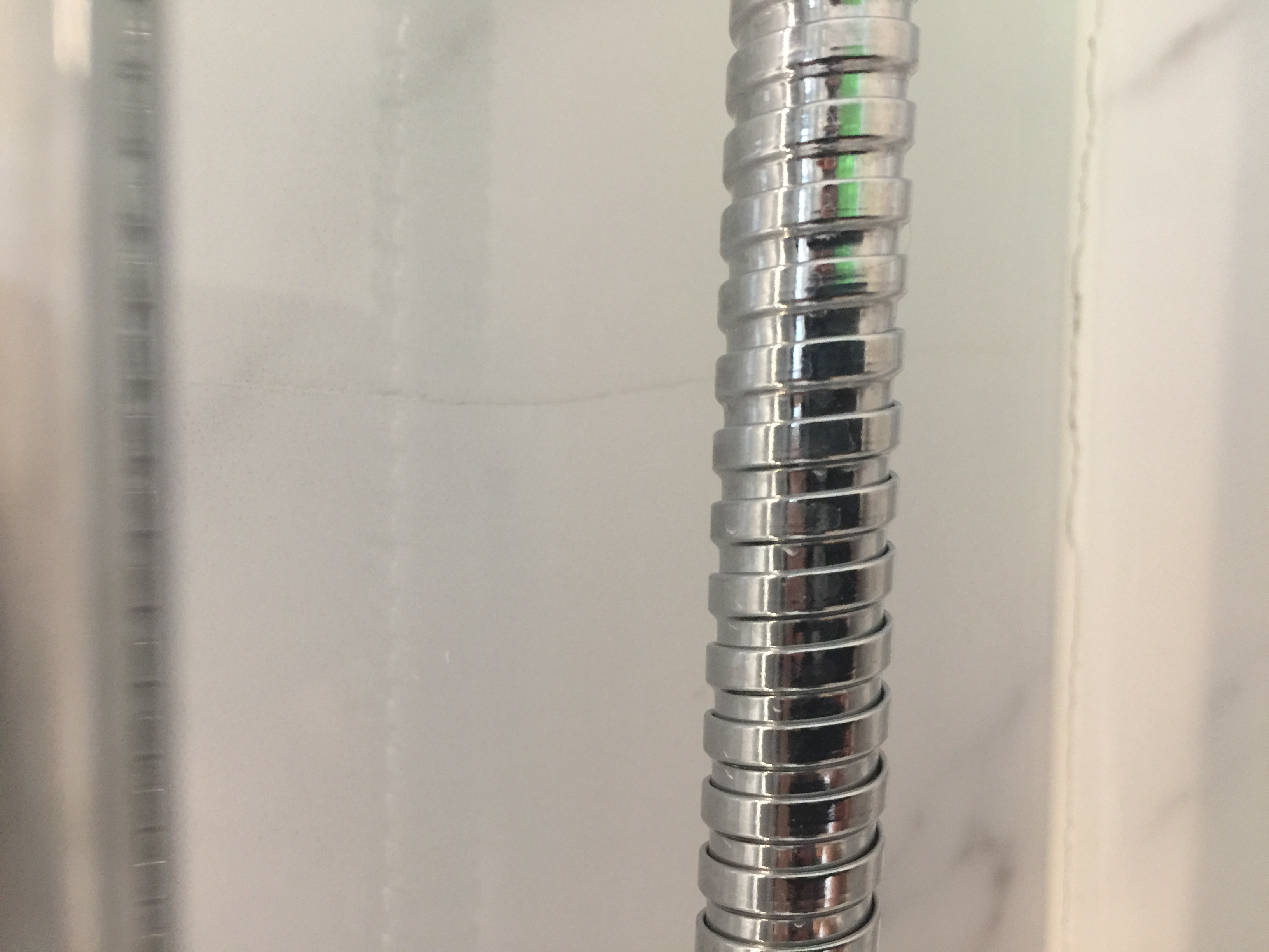

Some of the cracks appear 30" - 36" from the floor, some 40", some 60". The worst cracks seem to travel in almost a horizontal straight line, but not quite. But to be honest, there really are cracks all over: some go horizontal, some vertical, and no real pattern. The bathroom is small, 5x7'.

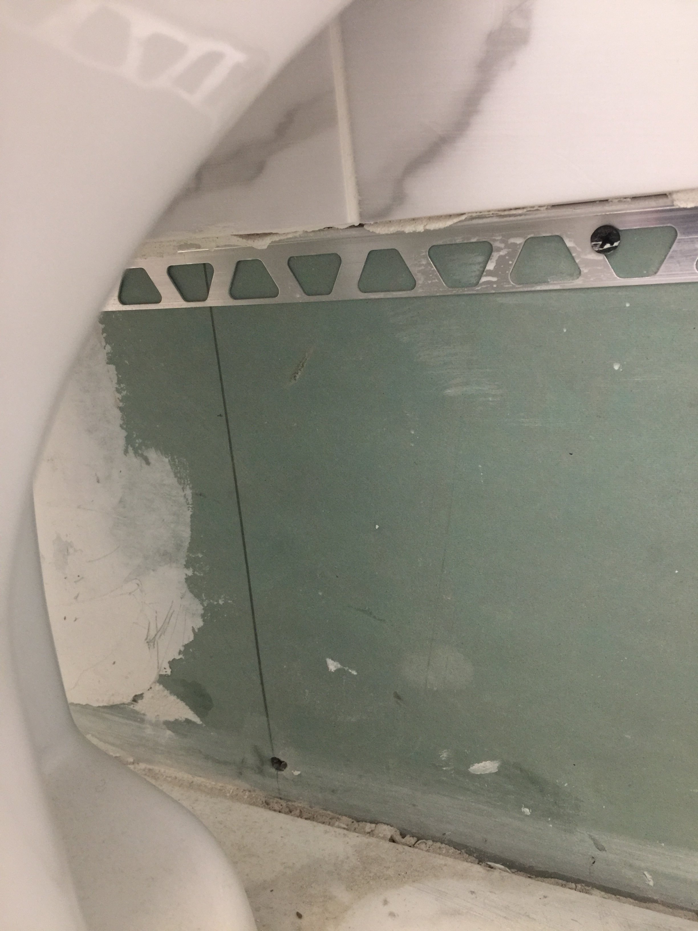

The GC is blaming faulty tile. The entire bathroom was ripped down to the studs, and green backer board on the wet wall and (I believe) tiles fixed straight to the non wet walls (no backer board). All four walls are tiled floor to ceiling. Because I am stupid, I do not have pictures of the work in progress (lesson learned).

What do you mean by green backer board can you be more specific . Ie is it a purpose made tile backer board or is it green mdf ( medium density fibre board ) or green plaster board or something else .
There is a thread related to BCT tiles but in this instance I’d suspect fixer error in most places . The boards should have been taped jointed and movement in the substrate is causing the cracks.

How deep was the bed depth? Cheap/poor ceramics can be pulled apart by drying adhesive if the bed is over permitted depth especially if rapid set was used. I have seen it on a couple of occasions. Cracks all look like crazing to the glaze. Were any of the tiles applied over existing paint?

Green backer board - new picture attached below. Not totally sure what it is or what it is called.
The tiles were all applied to different wall types, if that makes sense. One wall had that green board, another wall had drywall that had no paint or wallpaper, but was sanded/patched after the removal of the old tile, etc. All the walls, regardless of the type, are cracking.

Definitely need to tape joints but I bet it's just from adhesive curing and shrinking, pulling on the tile and that's the result. In my opinion and experience BCT tiles are not fit for purpose and I refuse to install them.
