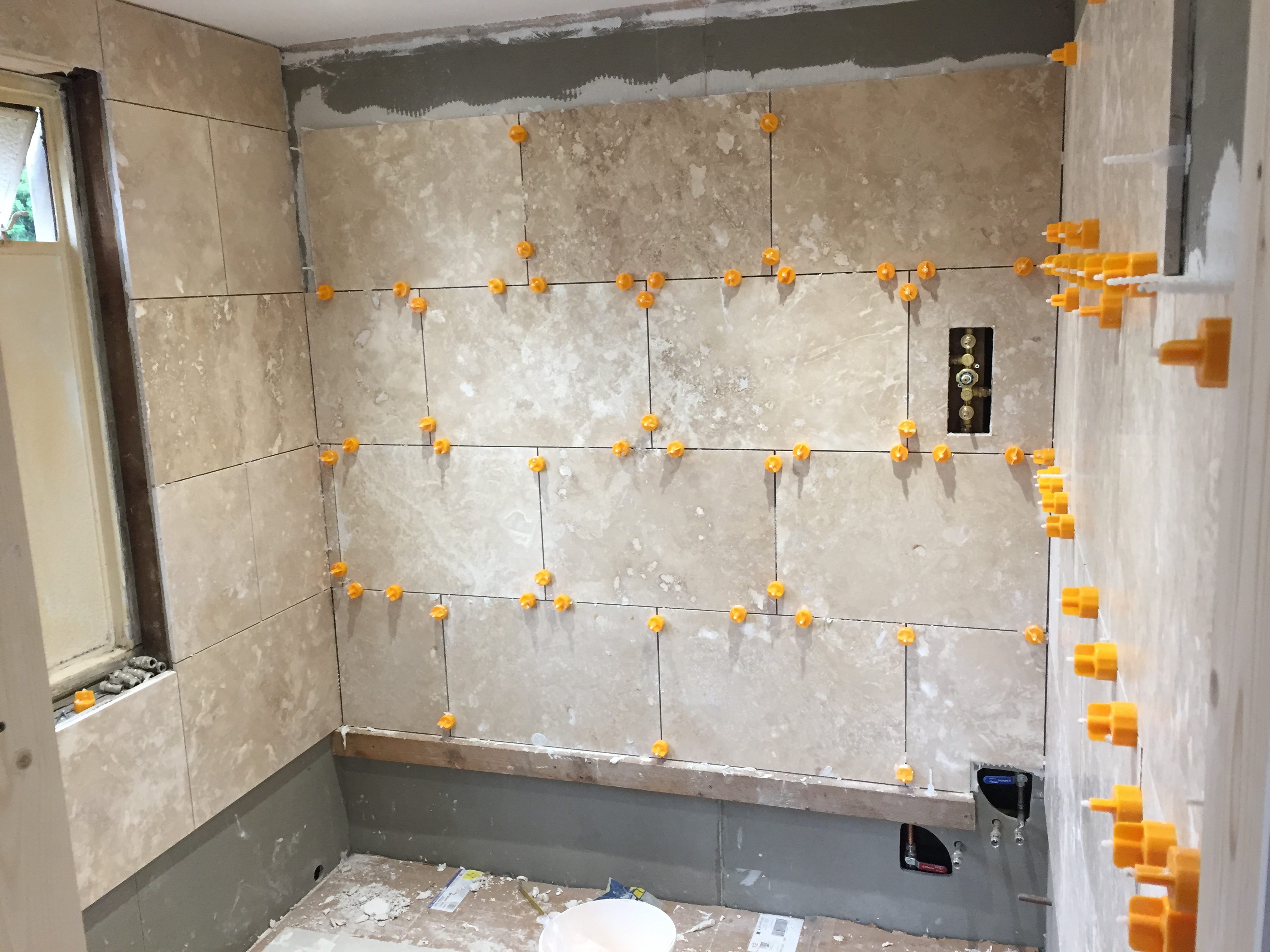

I used the twist on self levelling system as shown on page 1 of this thread. I found they worked really well.
There two types; one with a cross which also acts as a 2mm spacer, and one with a straight line, also acting as a 2mm spacer. The cross is for using where 4 tiles meet, the line is for other joints.
Due to my layout, I used the line spacers, but wanted a 4mm gap so had to also use traditional spacers. I used 3 clips per joint!!
When tightening them, both tiles will move slightly, giving an almost perfect joint. To remove them, I gave the yellow know a swift whack in line with the joint and then the yellow bit is reuseable once you remove the spree from it. I'd highly recommend these.
