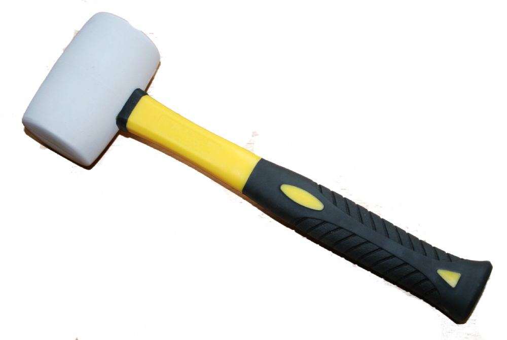

Best tile levelling system? Got to be one of these.... white-rubber-mallet-builders-brand-rws040-291-p[ekm]1000x671[ekm].jpg
...them clips are for DIYers and amateurs according to some😀
