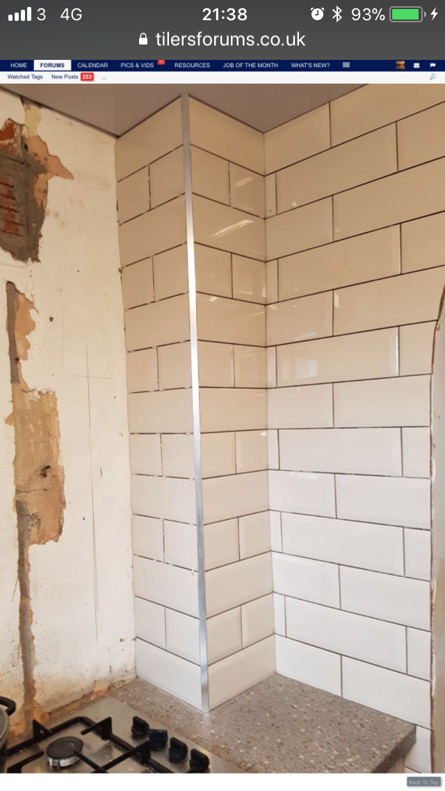

Actually, thinking about it, the window sill will be 8mm/10mm instead of 9mm/9mm
I'll chop off the bevel where the trim meets bevel, and then have a full tile touching the window. 8/10 would then reflect all the way on the inside of the the window frame. Does that make sense?
Here's one I did earlier, someone else had tiled, but the customer got me in to remove quadrant trim and tiled sill and fit new 'L' trim and window board.
