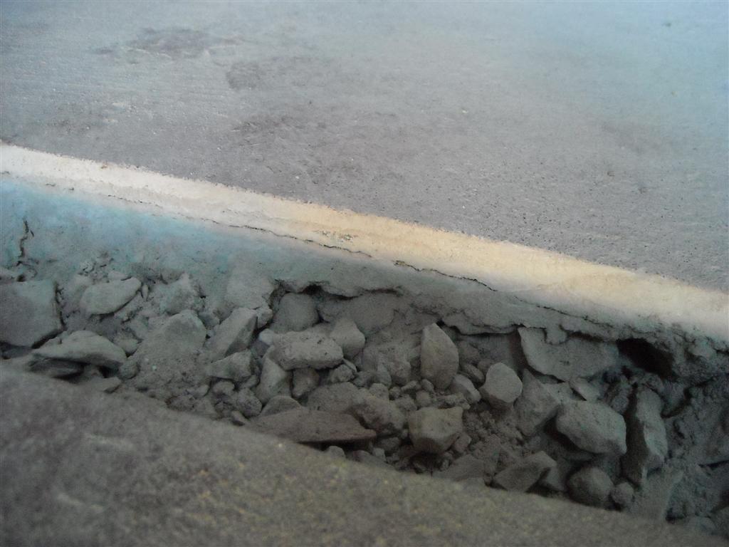

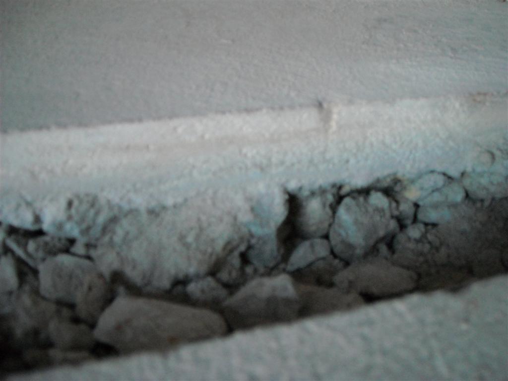

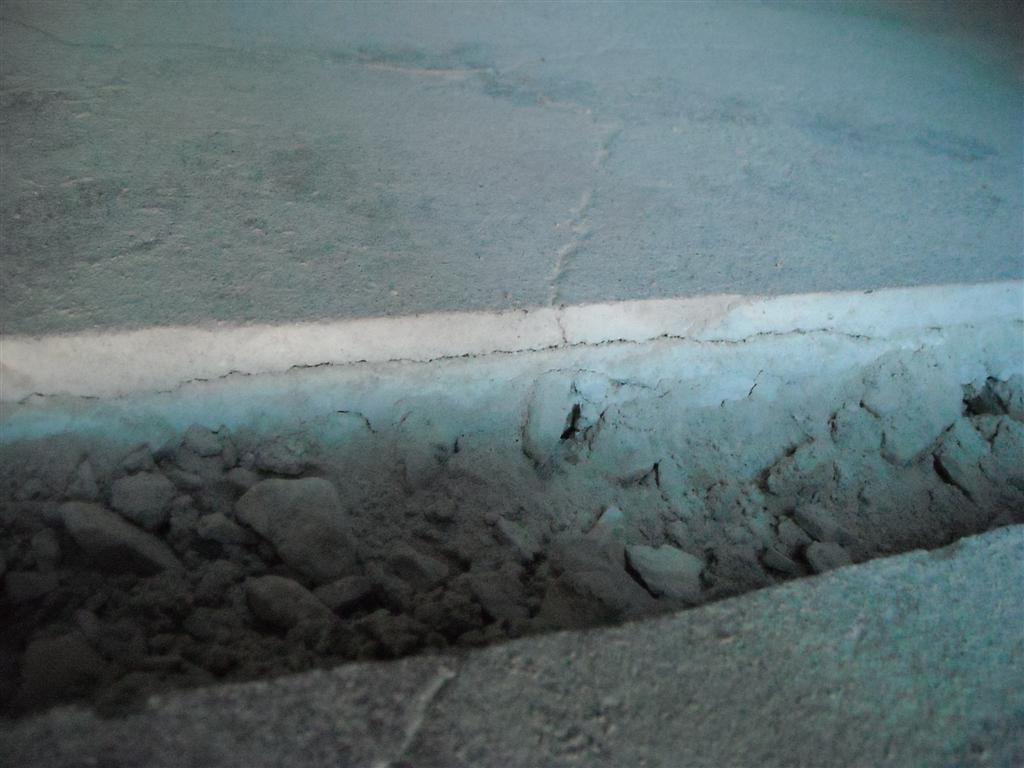

I'm restoring an old house and I am about to cover the floors with ceramic tiles. The problem is that the floor consists only in a mortar layer laid over some gravel directly on the soil. The mortar layer has some cracks and recently I've found (while opening paths for electrical wires) that in some places it consists in 2 layers that became uncoupled.

For the cost of bodging it you may as well dig it all up and lay a proper floor laid with a damp course.

Although the pictures look bad, the cracks are very old cracks possibly due to rain water infiltration over the years and first years natural movements. (the roof was in a bad shape and all the roof had to be changed - for that job I had to hire someone) .

How solid is the floor solid -is there any movement, new cracking, when you jump on it - also no vertical movement, either side of the existing cracks?
Sorry mate, you'd be crazy laying tiles on this, there is no strength there.
I bet it's super absorbant as it looks so dry, you could try a water based epoxy primer/bonder, diluted. This would penetrate into the floor and set. This might work, but how well and for how long is anyones guess.

I'll have to make the jump test to be sure, but I've never noted any movements or new cracks. In some areas, when you bang on it with something it produces a hollow sound (probably detached areaS). For a time I've stored there about 20 bags of pre-mixed mortar (25 kg each) on a pallet and when the roof was being changed the floor supported a large pile of rubble. I didn't noted anything.
One set of cracks was always there, but there is another one that I'm not sure.
Although it seems very fragile on the above pics, It was not so easy to break when I was digging the electrical wire paths. Sometimes large pieces came out without breaking. There was even an "island" remaining and I could walk on it with no problem.

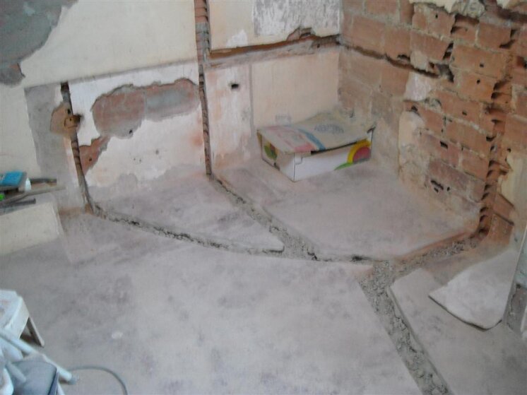

2 more pics for the whole floor...don't mind about the mess

Looks like your existing floor is pretty stable in the photos, and both areas are fairly small. Actually, I wouldn't use durabase or any other uncoupling layer - I think it'd be an unnecessary complication on your floor.....simplicity is always best where possible.
I think the most important thing will be the correct mixing and spreading of the adhesive with good notched trowel. I'd use BAL single part flexible and BAL wide joint flexible grout (or similar products). Important that the adhesive is worked well onto the existing dry screed, and is of sufficient depth to ensure a full flat bed is achieved under each tile. Use large tiles say 300*300 min. Take your time bedding down each tile, jiggling and thumping the tile with the side of your fist. Maye a good idea to lift the first couple of tiles to check a full flat bed is being achieved. Maybe also a good idea to just do the smallest one of the floors and see how that goes. If the tiles all seem good & solid after say 2/3 weeks - then do the other floor.
If the existing floor screed is not flat enough, you may need to put down a self levelling screed before tiling, but I'd avoid it if possible.
Another alternative would be to lay 22mm marine ply boards onto say 75 wide*30mm thick timber battens @ say 350 centers, leveled &solid bedded onto the existing screed. Then tile on top of that. I'd also lay a Visqeen 2000 polythene sheet (or similar) over the screed first, as it's so cheap, if there's any doubt about rising damp.
