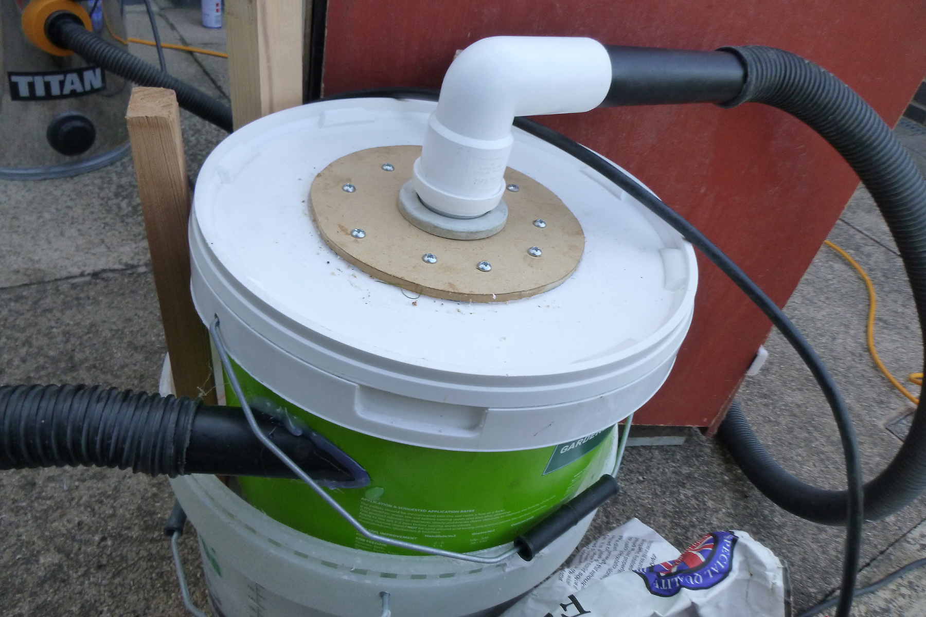

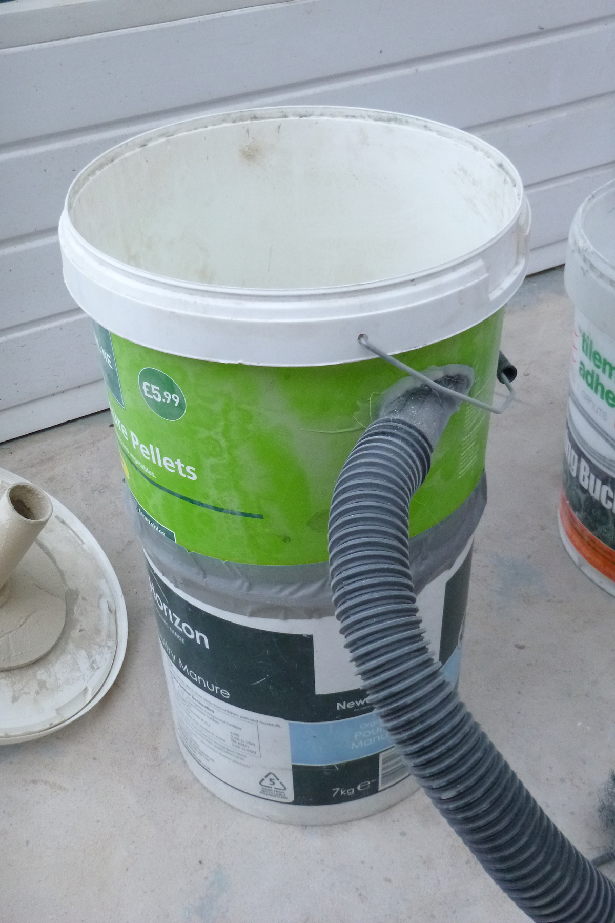

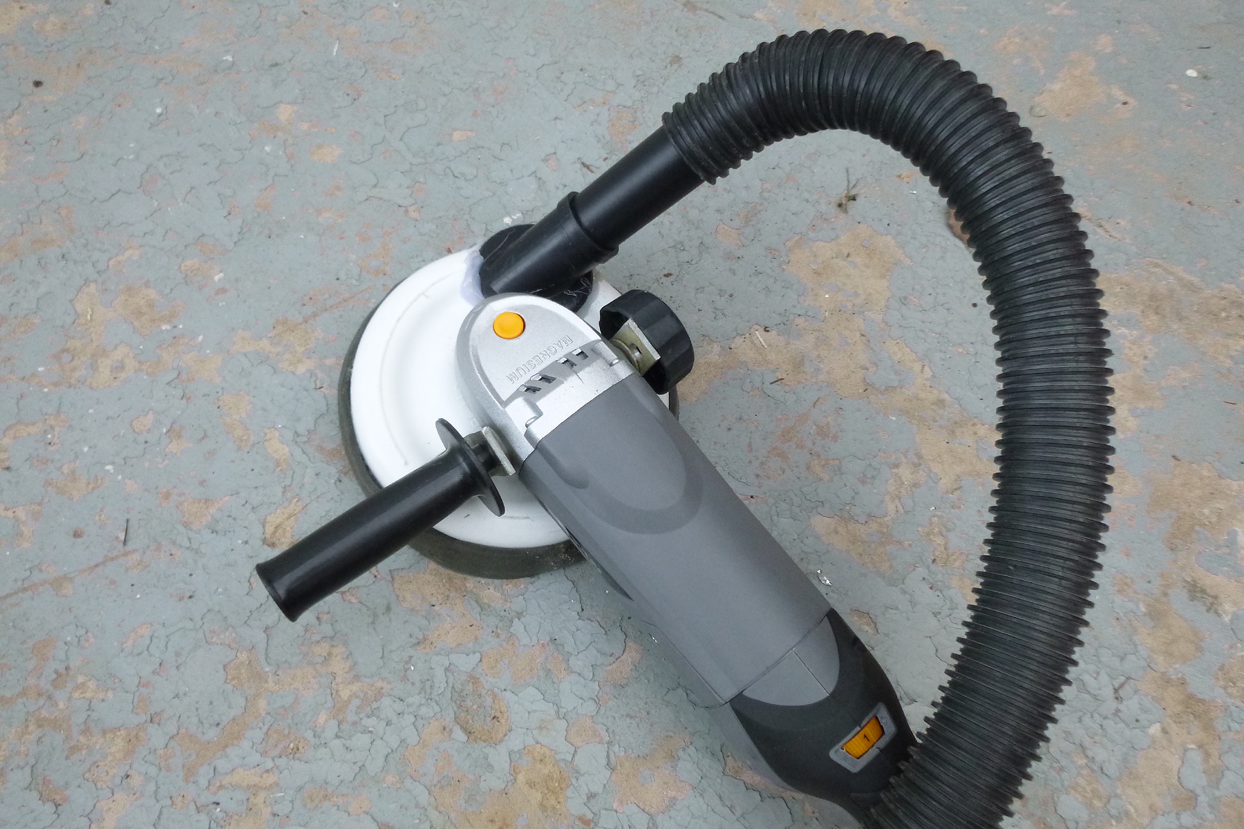

The problem is that the black hose attachment has come off from the shroud, this bit -
p1000902-jpg.98696
I used gluesticks but they did last the job out I need a better glue.

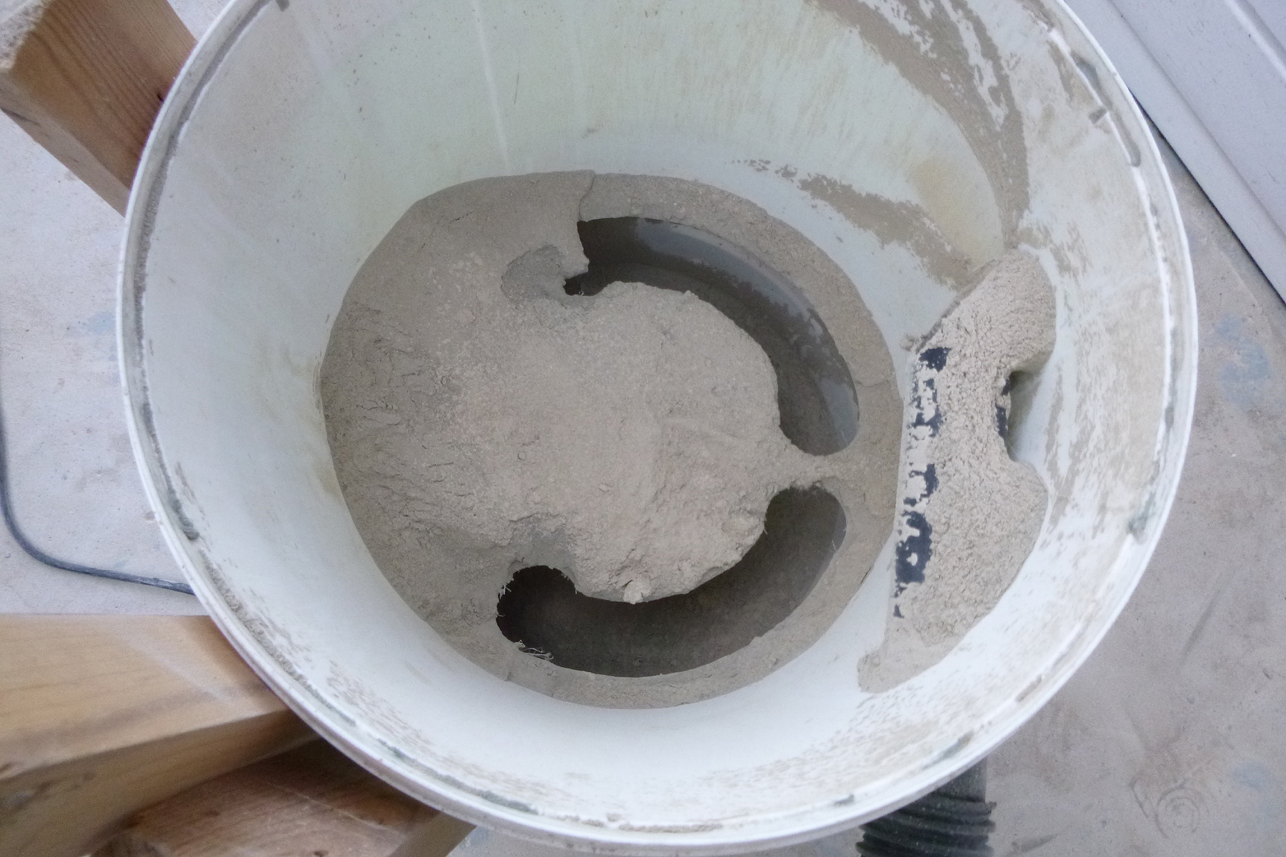

Also the baffle is meant to stop dust going up the exit hose to the vacuum but it may of worked but also acted as a shelf to collect dust, I think I will make the curved holes in it bigger. The idea is that it is a round disk under the vacuum hose here it is which is the bottom of the top bucket with the curved holes cut out so the dust on the outside vortex drops through to the lower bucket below.
