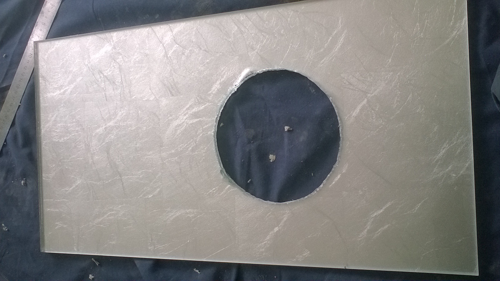

...guess what it didn't fall in a groutline as requested, this was the outcome, first attempt drilling round the hole with an 8mm glass bit ended with the tile cracking so that was a waste of time and money, second attempt with the angle grinder got it spot on, well if you don't count the big lump it took out of the face of the tile, luckily its covered by the shroud around the chimney...phew

Did a nice job tho Andy!

Shoulda known better, the fireplace receptionist said it would be fine to alter the chimney height to suit, the actual fitter then spoke to my customer and said no, the chimney has a seal on top of the fire that cannot be broken and the overall height must stay as it is, so it ended up being back to my problem, anyhow done finished with only 1 breakage... move on to the next one....a straightforward conservatory floor( that the customer decided he'd stand behind me all day passing me a tile at a time cuz he wanted to help) some weeks its just one after another :'(

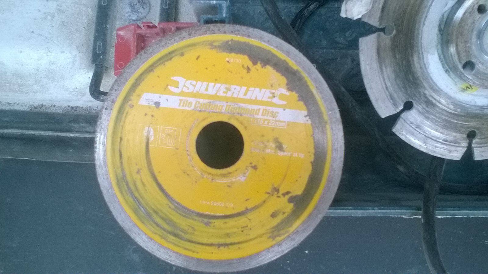

Tried it with the Bosch serated blade I usually use for stone and that was a bit too rough for it, changed over to the continuous rim in the pic and although it chipped the glass a bit it did the job as it was covered with a cowel round the chimney pipe, you couldn't have had I as a finished on show edge though..

Someone I know is looking for an angle grinder size blade for glass and u came to mind.
Thank you my friend, 🙂
