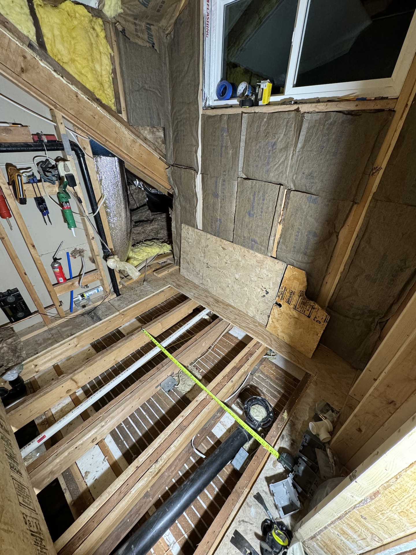

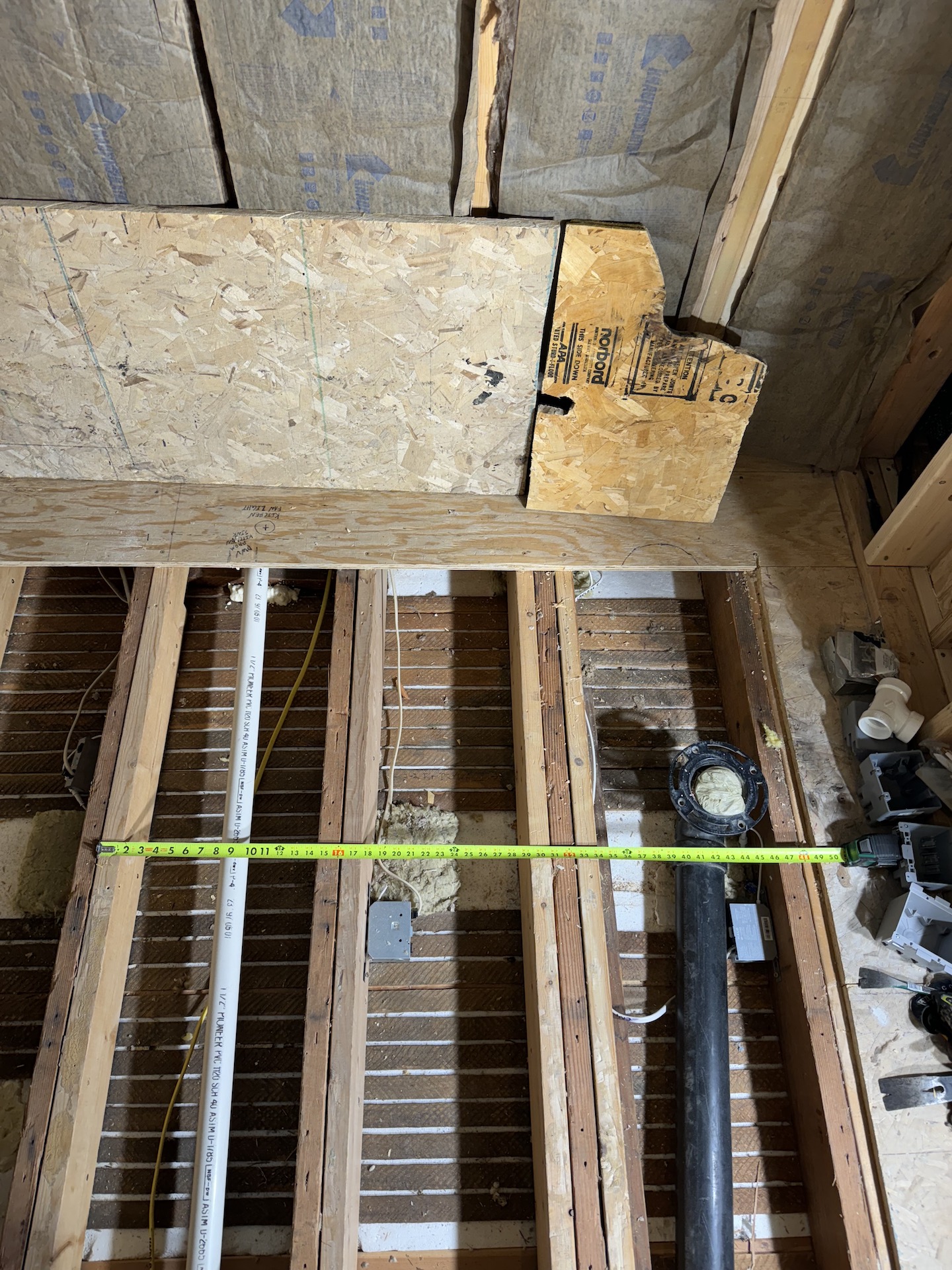

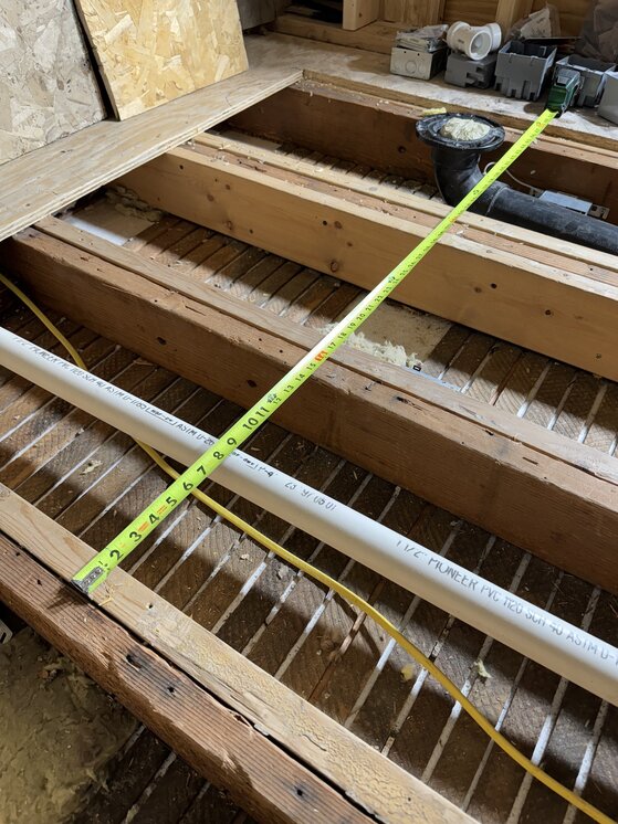

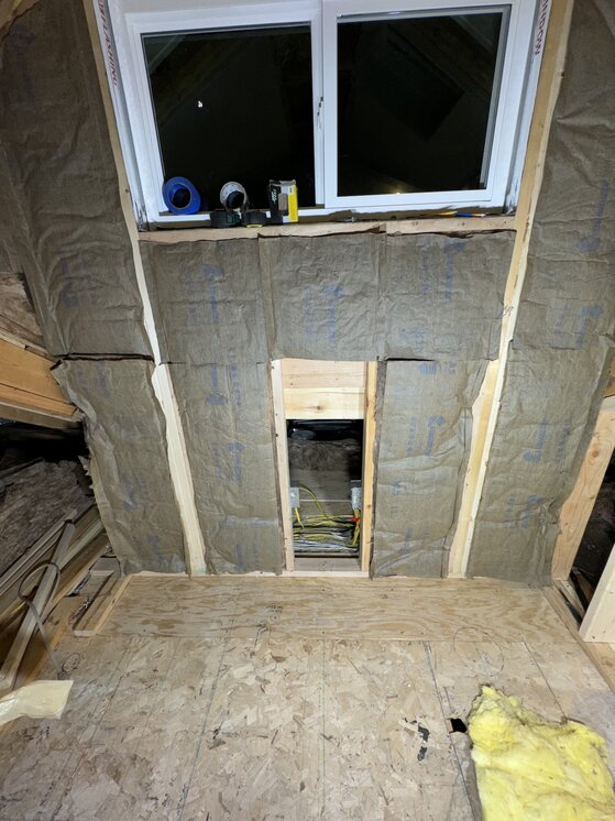

1) Bath Area in dormer
2) Gable wall of dormer. The rafter header is visible with the insulation removed. The wall starts just past half the 12' span if measured from the opposite bath wall. I'm pretty sure the gable wall via the bottom plate to wall to rafter header to double rafters is holding the floor from deflection. The load of the gable is structurally in the double rafters. Technically the walls could be removed, but the gable wall holds the joists so not much movement.
3) Doubled 2 x 6"s. The one with three is just two with a partial non-supportive 2x4" there for some reason.
4) Joists from the left angle.
5) Joist from the right angle.

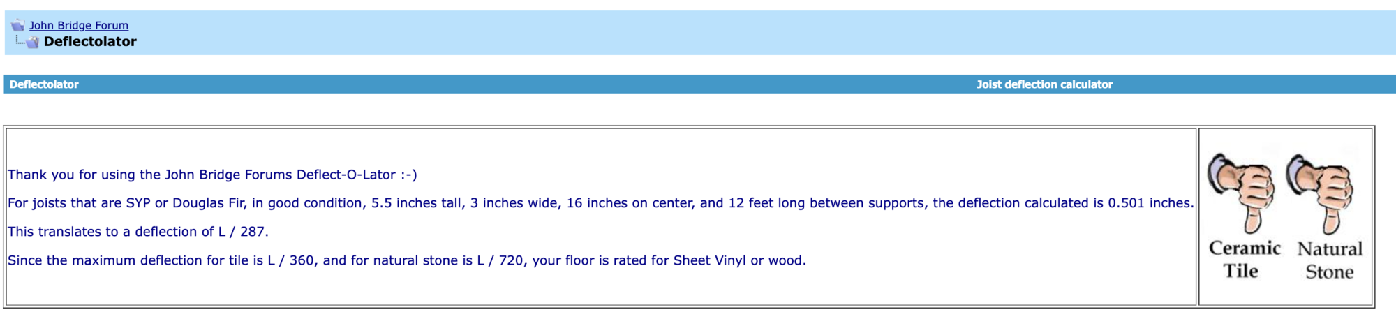

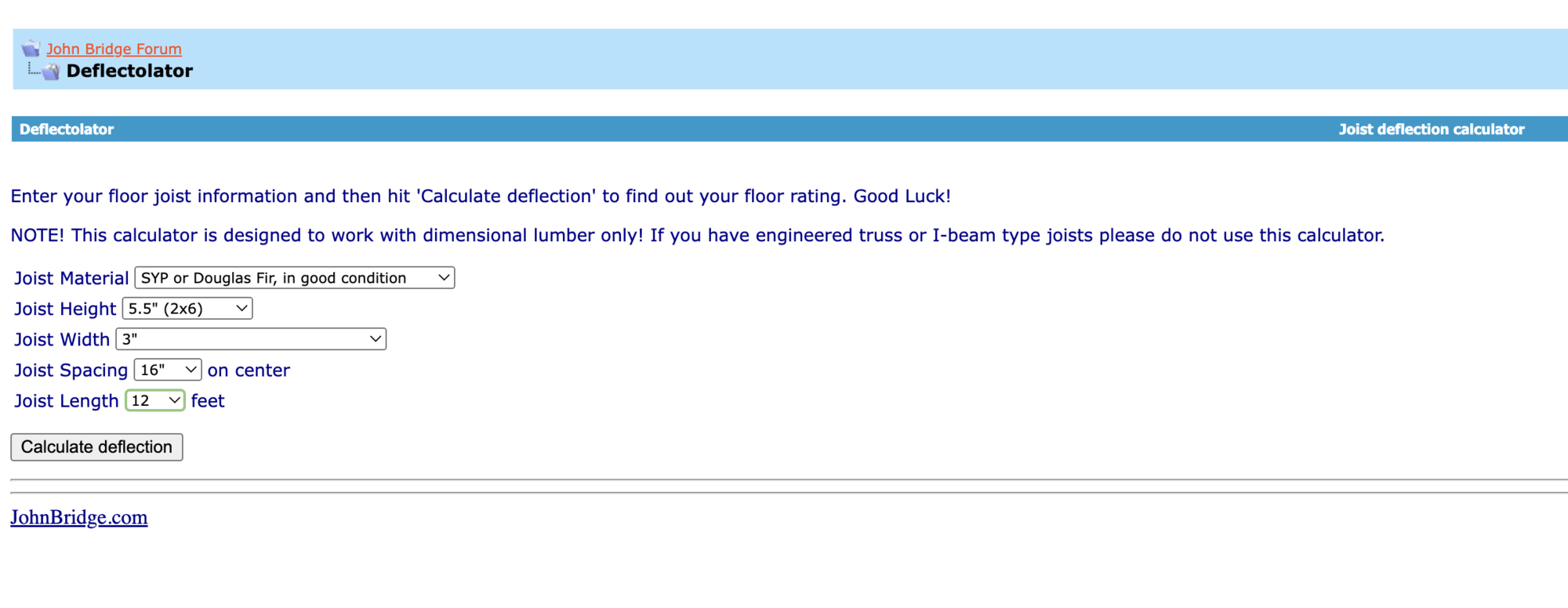

This translates to a deflection of L / 546.
Maybe from the typo on Joist With. Shouldn't it be 3" from the double two-bis.
Here are pictures from the JB Calculator I am using online. I didn't buy a special app. Maybe your app is better?
Thanks for the help again. Much appreciated.

What do you get at a joist height of 5.5"? I do believe the online calculator I'm using could be different than yours. Maybe more conservative on the assumptions perhaps.
If it's very close then I believe I'd be fine as the center is basically hanging from the rafters. I was just wondering if there was anything I wasn't considering.
