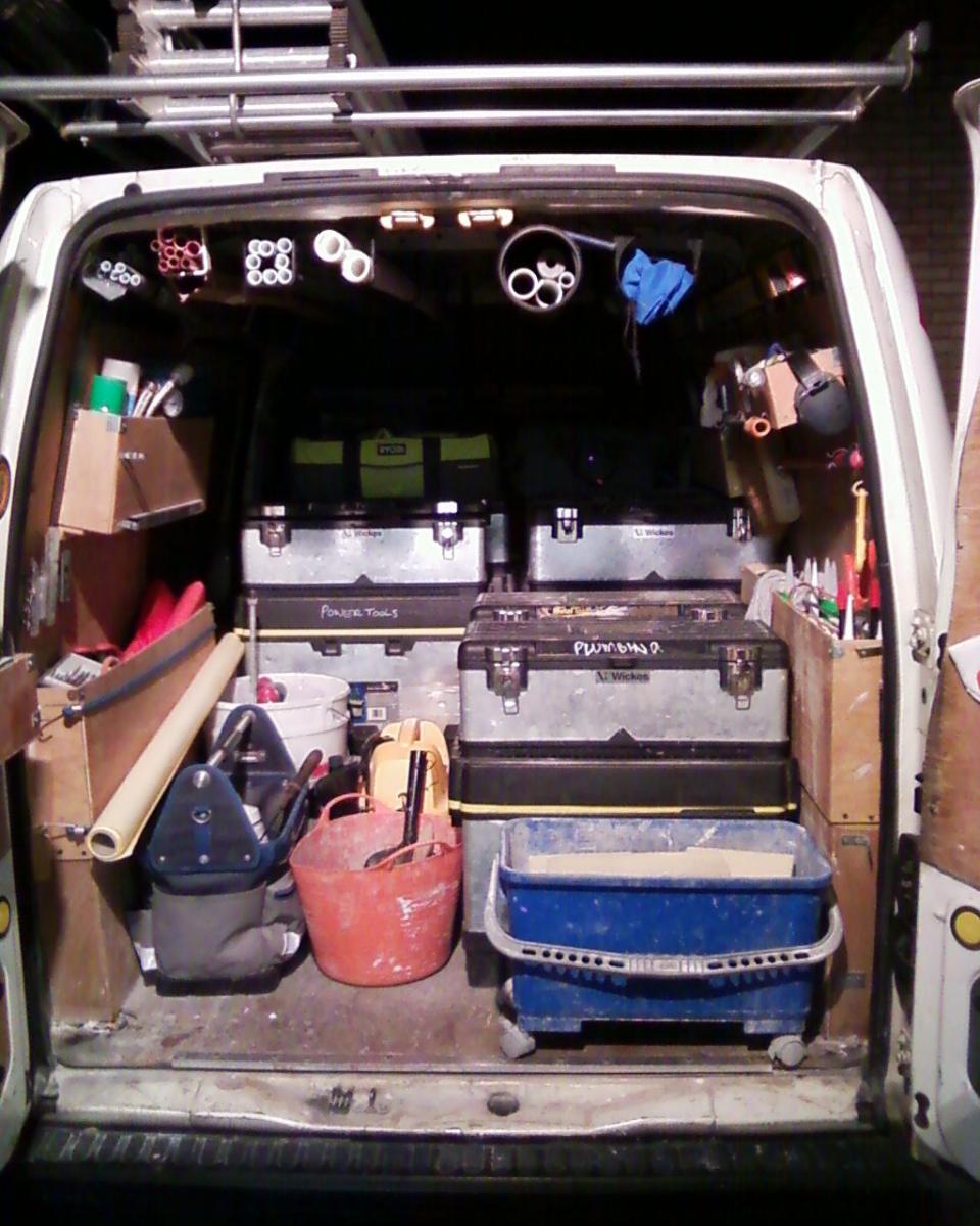

as for transporting i have the lwb t230 connect and as i said it fits in but i do have a considerable amount of tooling in the van at all times.

this is my van as of 10 mins ago dave and i would consider it relativly empty so you can see my problem, but it goes in on the 2 boxes on the right and the legs fit down the left side or on the roof (that is a chore)
you need a bigger van Spanish!! I leave a lot of my tools in my trailer now ready for when I get myself a pick -up
considerd it doug but love the connect, at least me and dave should agree on that one :thumbsup:ha ha
