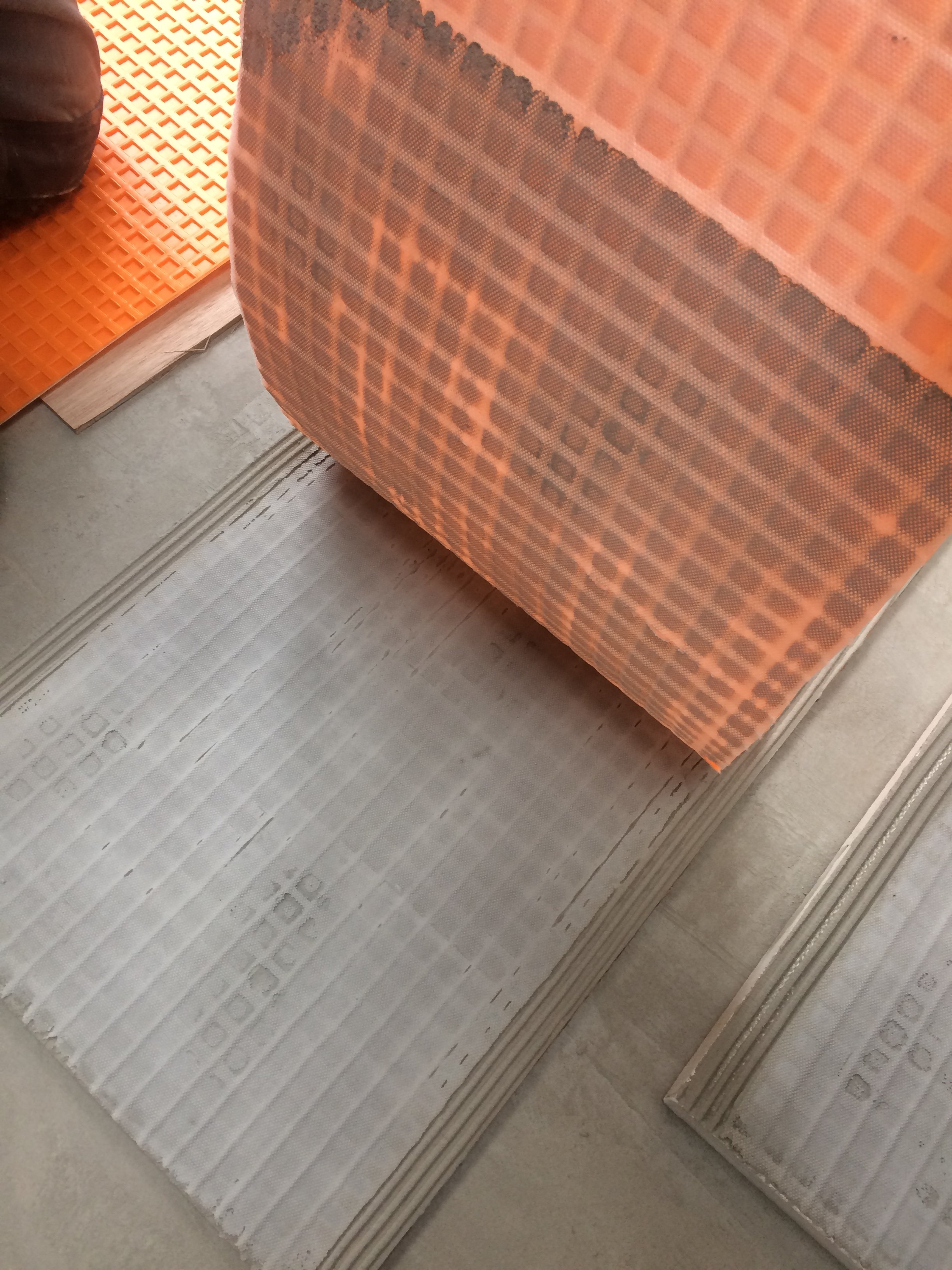

How long did you leave it before you did your pulling up stunt?
The 10 meters were only down for an hour or so, I did not want to risk the adhesive going totally hard.
But the pictures above where the matting was stuck down on the paving slab and on the piece of ply, we're stuck down by Ardex technical the previous day, and bought to my site, they were down for about 24 hours and they came off just as easy and leaving no residue.
