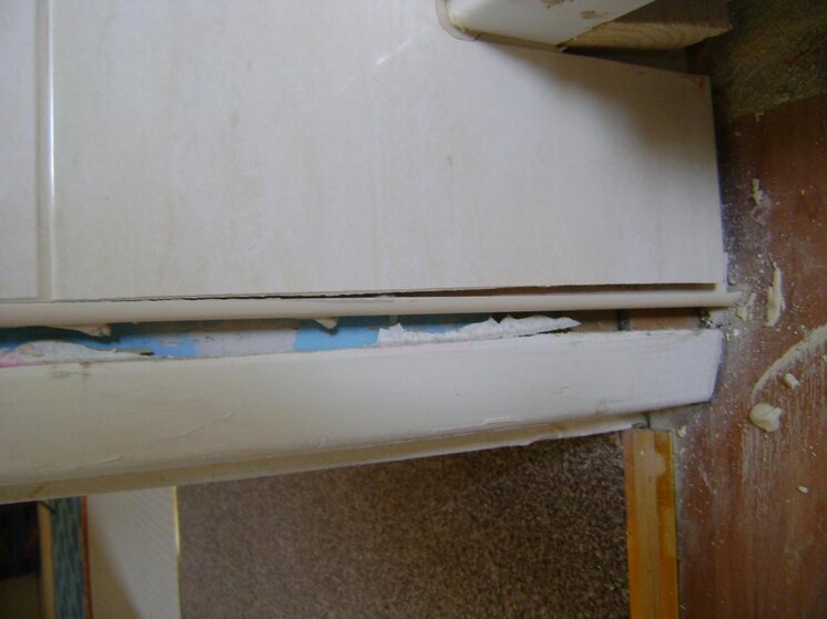

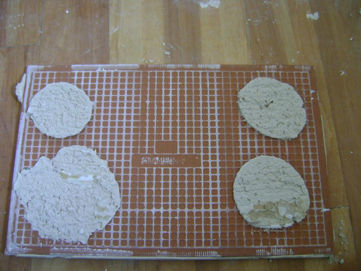

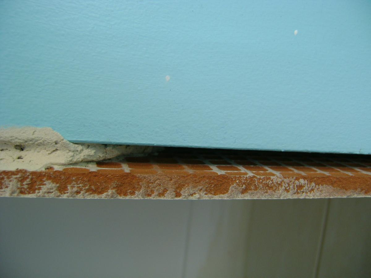

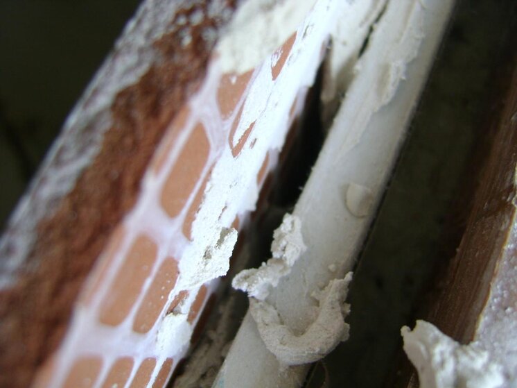

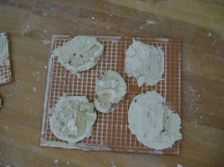

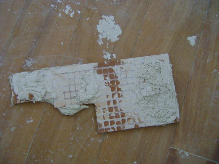

Yes they have a website etc, just reluctant to do anything more if they are supposedly re-ordering my tiles at the moment, my Dad has started removing the tiles and the adhesive was still dam underneath some of them, complete cowboys!!!
I have gone from being really upset about all this to being annoyed, I have 2 young children and they could have been in the shower/bath etc, a tile could have come off all because they wanted to cut corners, how can 'professionals' go away from a job like this and not be worried about what could happen after? Shameful!
