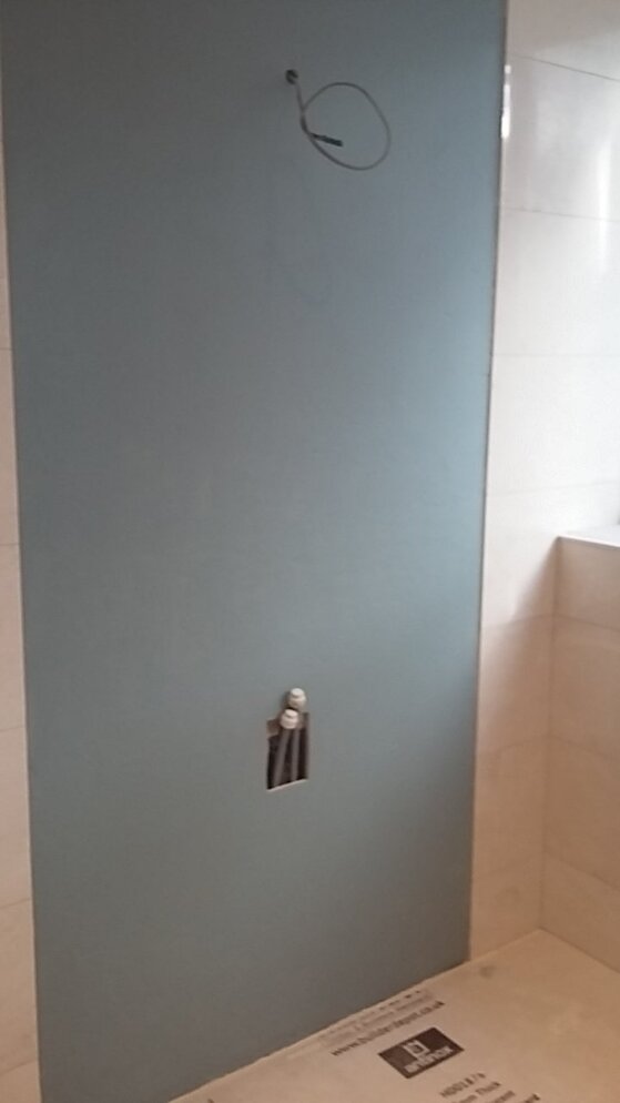

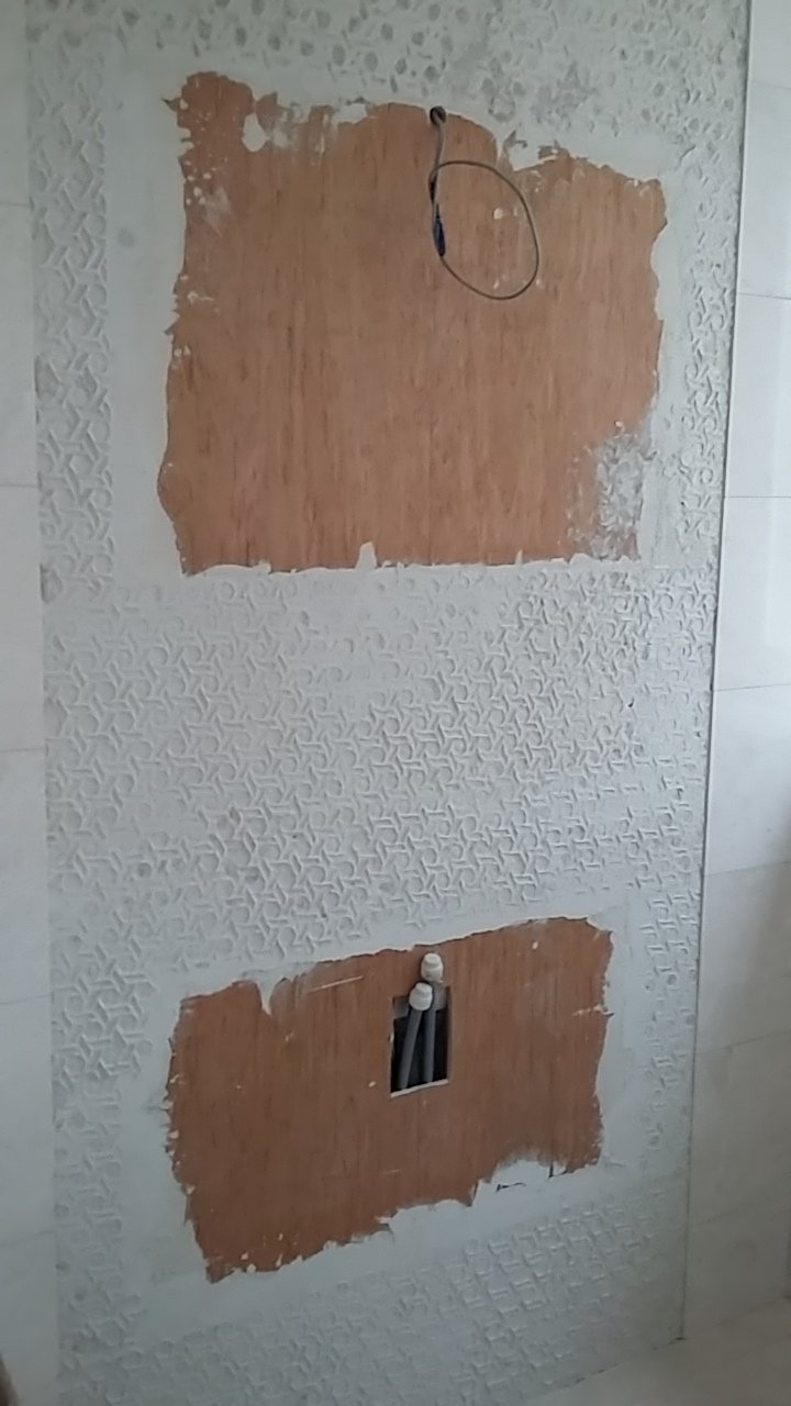

Preparation dried adhesive on ply
As I mentioned removing the ply isnt an option unfortunately.
I see, I thought it was maybe a budget issue that there weren't the funds to replace, not that it couldn't be removed. The grinding cup is without doubt the easiest option and not messy if you get a dust extractor for your grinder, other than that, you could remove the highest spots and give it a 3mm or so skim of cement based or glue and screw some 6mm cement board, if there is the depth to play with of course.
Im going to use grinding cup and scraper.
I cant board or skim over it, I have to get down to ply base as theres no depth to play with.
Thats the least of my problems lol.
I've obviously misunderstood your thread. I thought the dried adhesive was on some finished plywood decor panel and not on a previously tiled surface. Apart from 'removing the plywood is not an option' that is still not clear.
Just need to get adhesive off Ply thats all.
I got the scraper from tradetiler (great quick delivery as always) and along with wetting the addy it worked a treat.
Cheers me dears.
