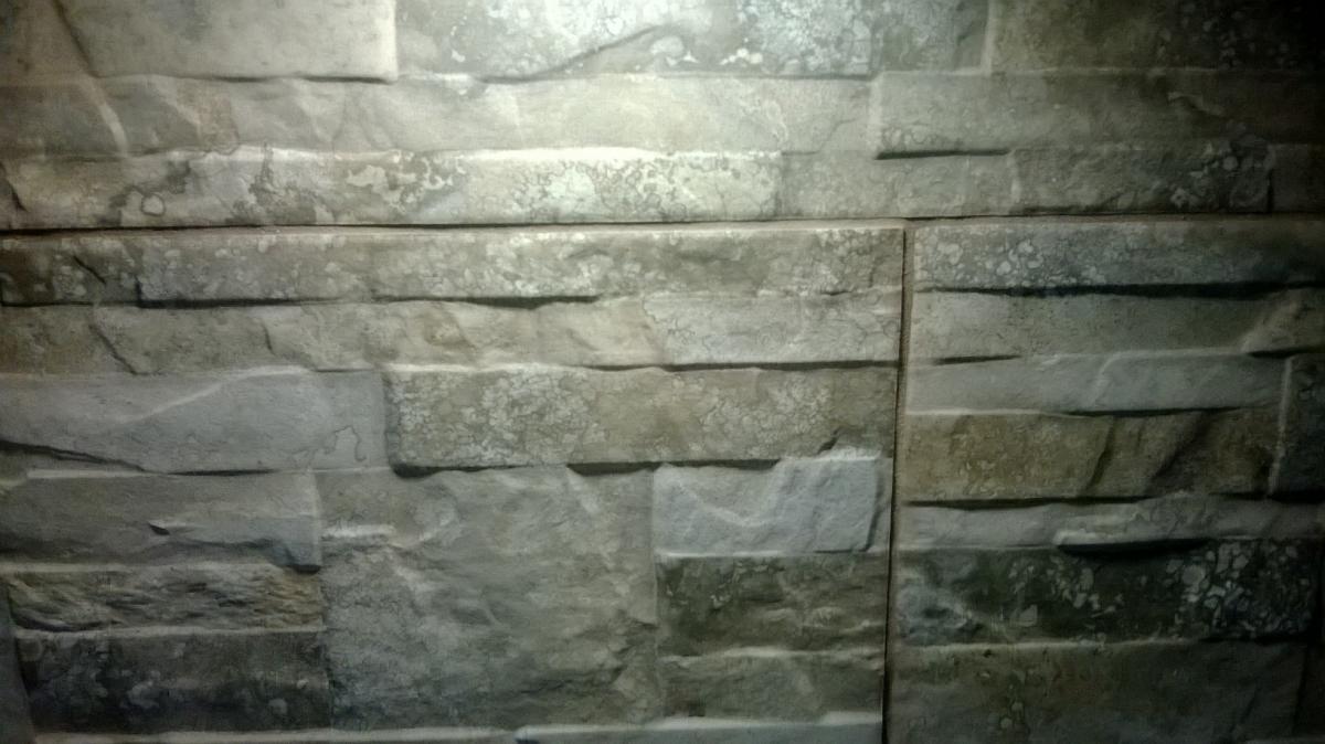

what about grinding out an angle around the whole socket and sitting the casing inside? may be a little unsightly though as more of the tile would stick out more than other bits... if that sounds rite lol
those tiles look like the same rubbish I fitted from topps a couple of weeks ago, they recommend you butt joint them only filling in any gaps that can be seen, grouting them is a nightmare so is cutting them.....good luck...your going to need it !!

As for the socket issue on your job i would just tile it as normal and if it looks too sore i would Silicon or i would grind off any large lumps that are making it stick out so it sits a bit more flush with the tiles, each to their own mate.... horses for courses and all that. good luck

that photo is from the showroom I had to pop back there to get a suggestion on what grout to be used on the walls and floor
