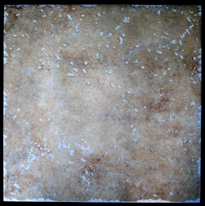

The floor tiles I'm laying are Italian porcelaine - Rondine Naples Nola, 45x45 and 34x34. I'll use the large ones for the larger rooms, and the small ones for small rooms & maybe as a visual break between rooms. The rooms vary in size from 20m2 to 40m2 for the larger rooms, and 6 to 9m2 for the small ones. The walls are very thick, so there's a 60 to 90cm long corridor between rooms. I plan to lay the tiles in the large rooms on the diagonal.
The picture is of the smaller tile. You can see the edge is square, but the surface is "chipped". The tiles are much lighter than the photo.
