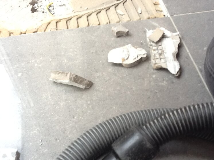

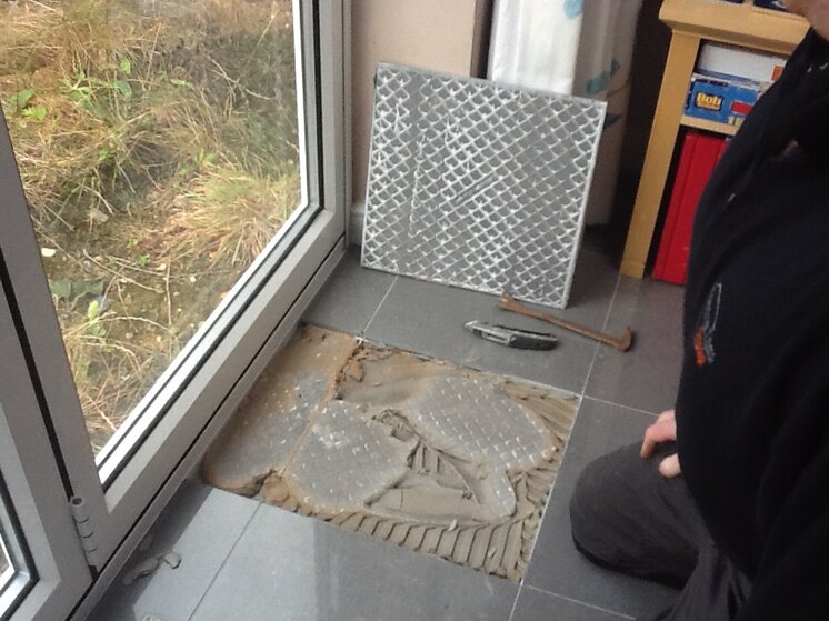

Been a while, but we've had a couple of tiles removed (these tiles could be rocked/moved easily, had a hollow sound when tapped on most of the tile surfaces). See attached photos, any comments/advice gratefully received.
Tiler has still failed to provide a copy of any report from the samples he took & Granfix have been helpful and can't locate any report ref. adhesive samples concerning our address, we will be supplying them with these photos and some grout and adhesive samples for test.
Of the tiles removed, the grout was very easy to scrape out with a Stanley knife and could be easily crushed into powder betweenour fingers, there was no adhesive stuck to the underside of any of the tiles (they were not damaged whatsoever during their removal) and we were able to lever chunks of adhesive off the backer board that is beneath the tiles & adhesive fairly easily (only tools used can be seen in the photos). The partial tile has no UFH beneath it, the whole tile (40x40cm, don't know how I got to 60x60 as stated in one of my previous posts) has UFH to half of the tile. Some of the adhesive has gone an orange colour, some is still grey, not sure if this is significant.

Re: Help, what could be wrong with my porcelain tiled floor that is li
Pic 2 say's it all...
How thick are the dobs of adhesive.....
