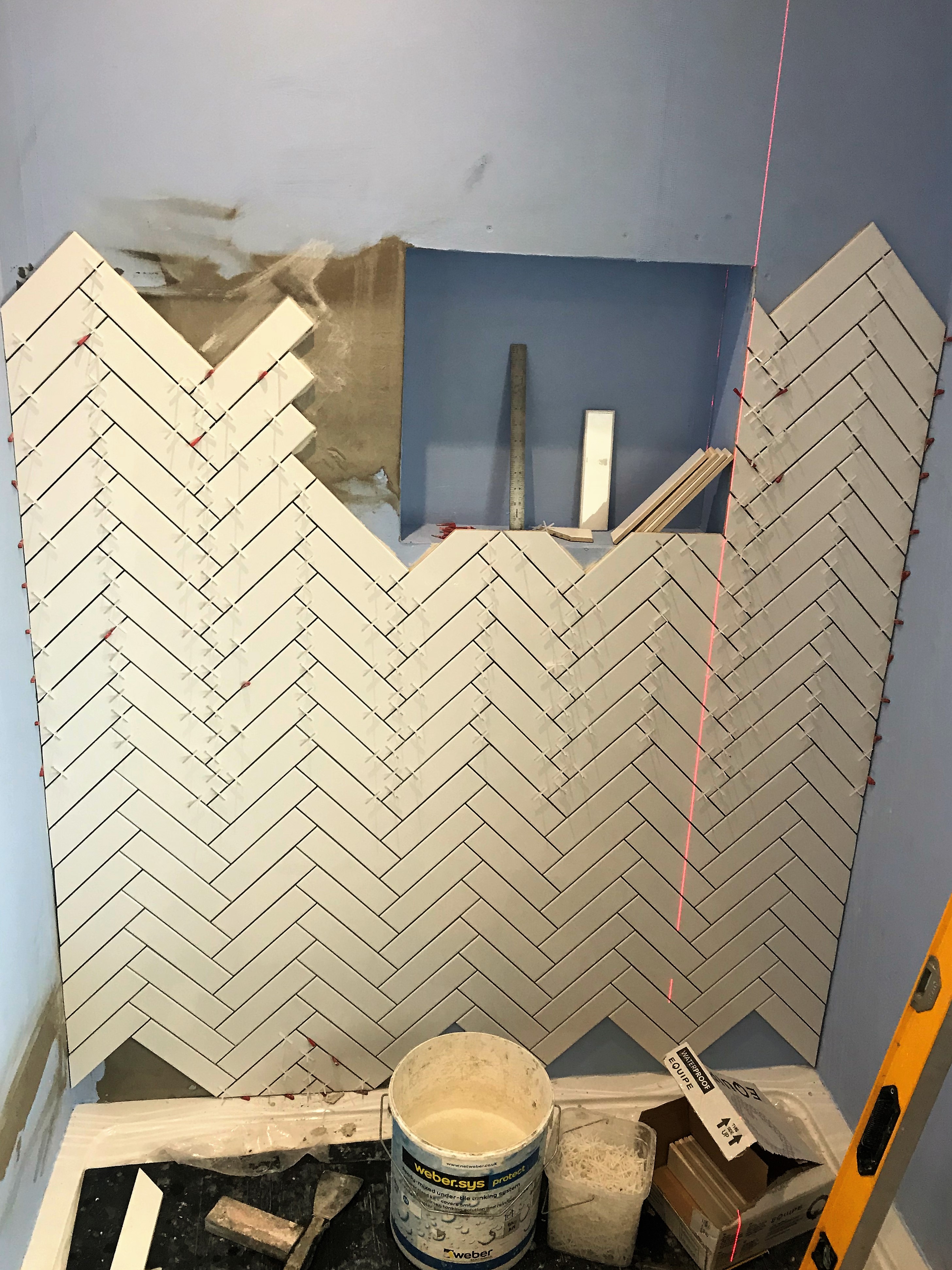

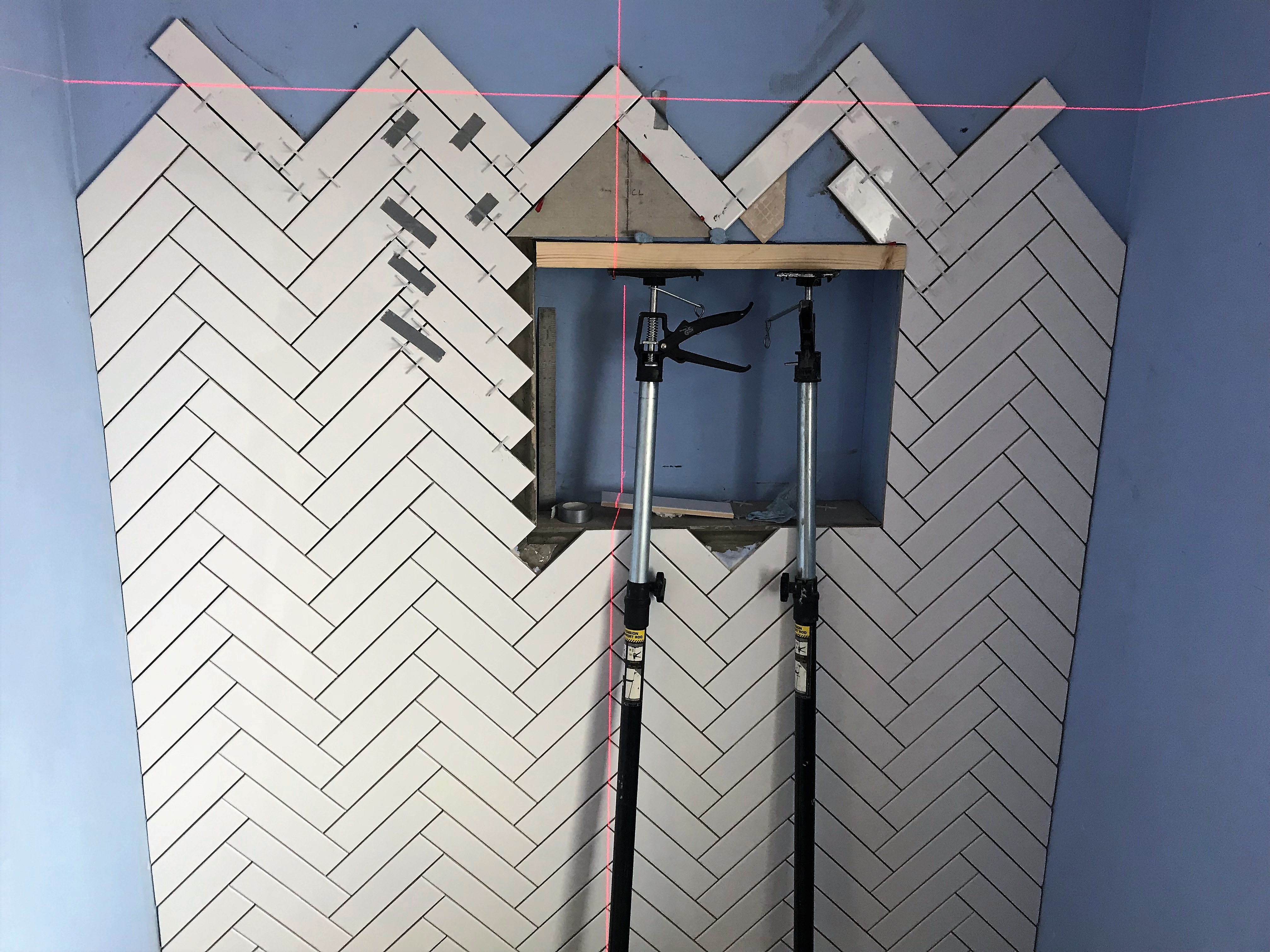

Re-clad the sill and side reveal of alcove to give me nicer cuts.
Toyed with the idea of building out the right-hand side reveal to totally equalise it all, but I've already shrunk it down and that would have meant losing a really big chunk of it.
Success with the most worrying part - going either side of alcove and meeting up again above it.

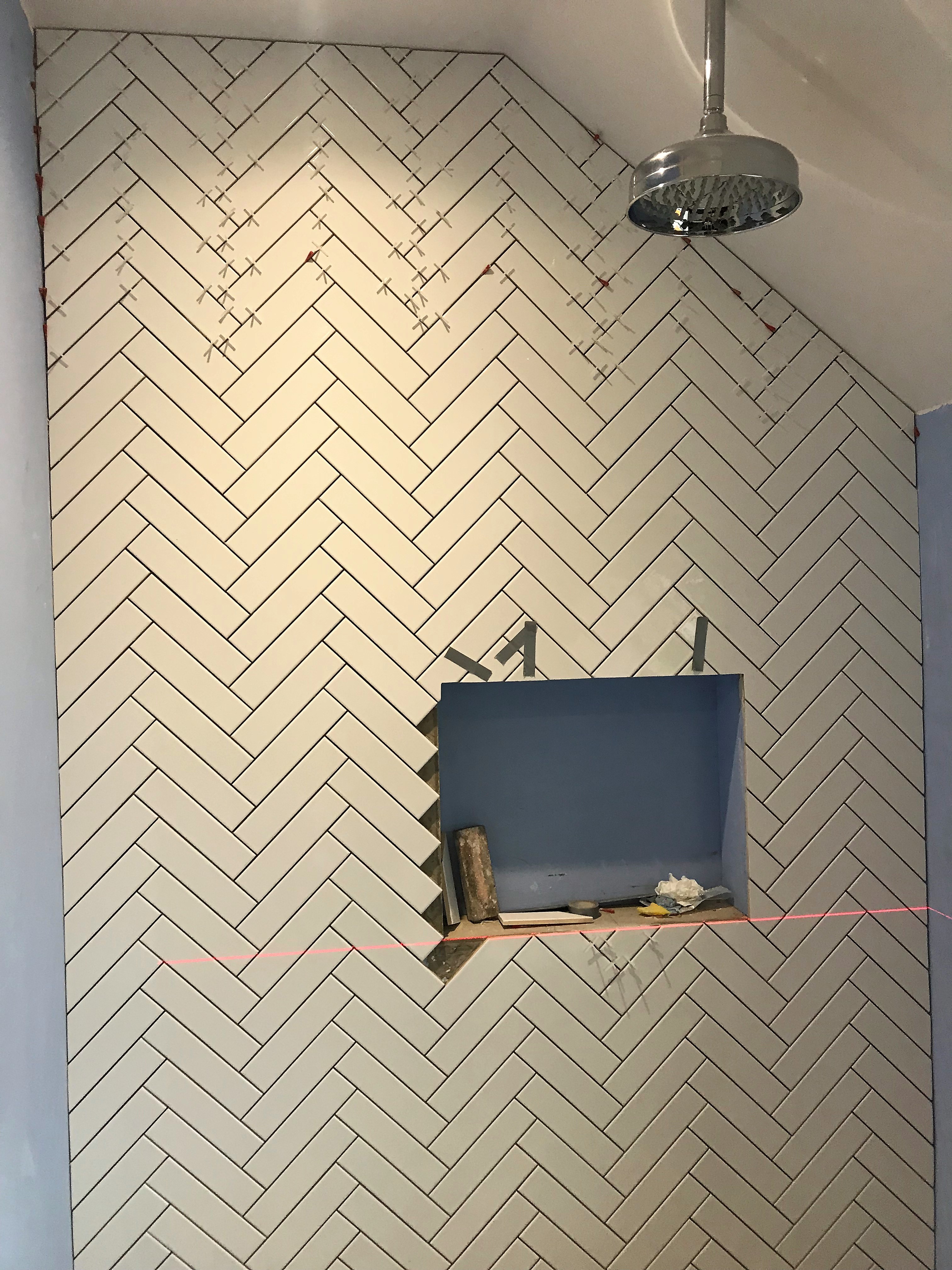

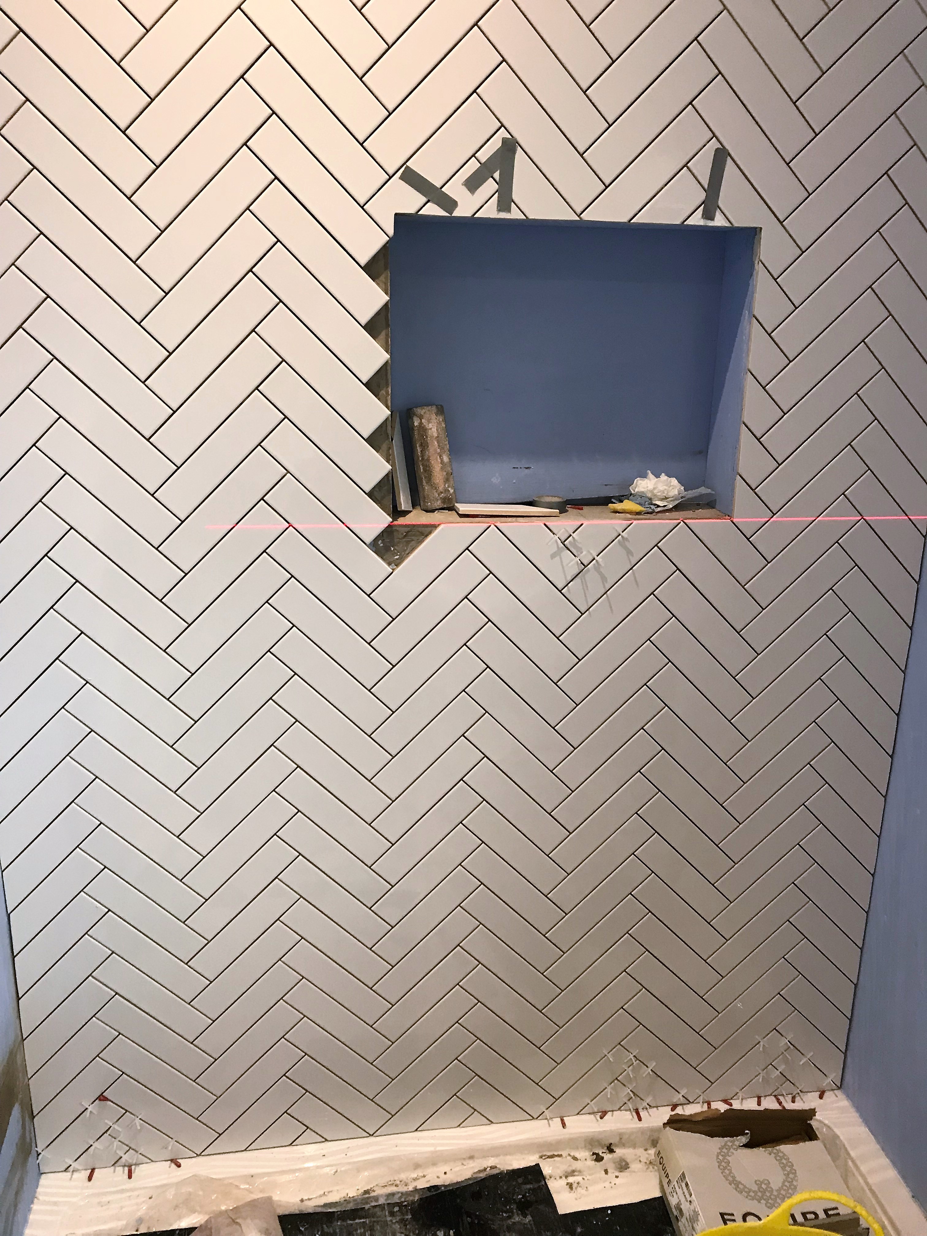

Really wanted to finish the main wall today as it was my first proper full day at it but didn't quite manage it. 5pm and I couldn't get out of there fast enough. Sick of it now to be honest 😡
Grey grout so no place for cheeky cheats 🙁
