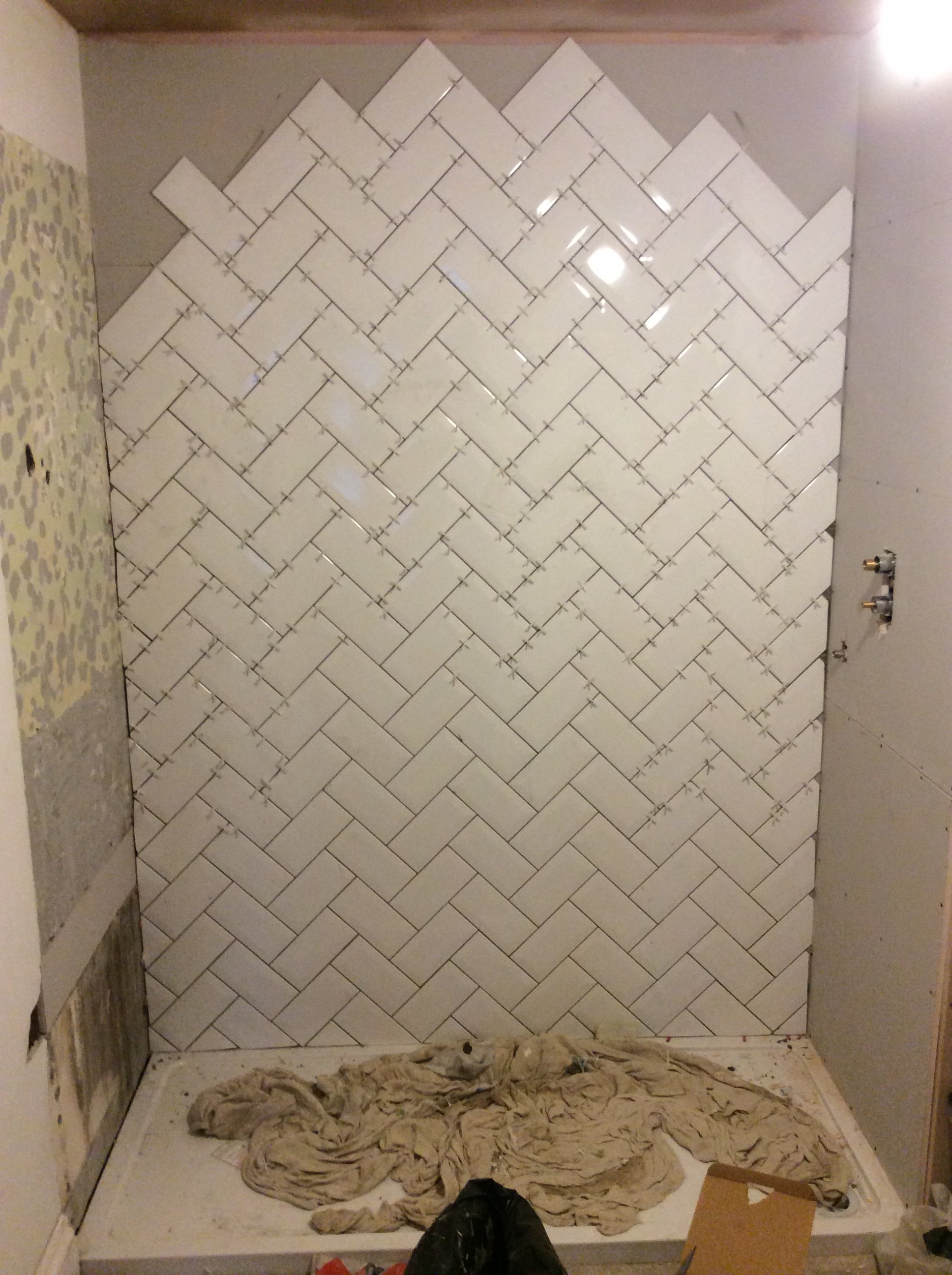

I actually had this with me and still messed up ewgAflfoQw+9Dxd87eT+Qw.jpg😀😀

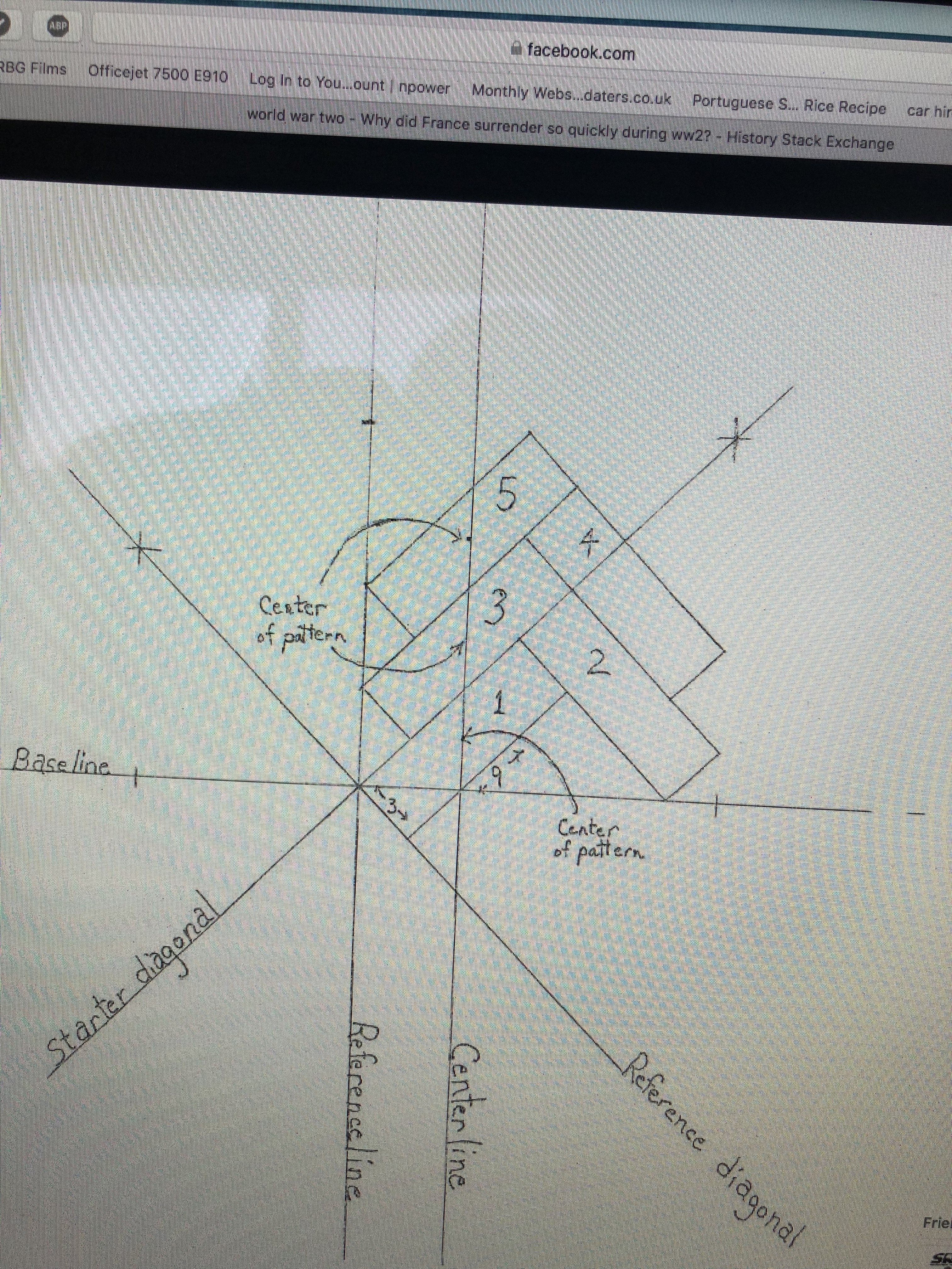

Not at all albert.was gonna wait till i was at work so i could take a few pics to explain it.once you know how its done,its so simple.works for any size tile also.plus your cuts are the same direction so you get a pair of wings.try and post an explanation when im home from work
It's already explained at the beginning of the thread mate
Measure 2 points and halve it?
Lee macs advice couldn’t be much simpler could it?
I centred the wall and left with small cuts ,but just say covered it on the return wall,think better starting off centre or one corner
There’s a way to centre herringbone properly. There is a thread about it on here, I’ll see if I can find it rather than trying to explain it all again lol.
