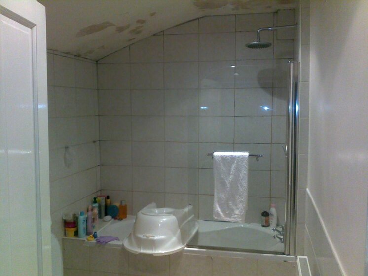

Hi,
I've just had a thought. I'd like to install a mirror into the back wall of my bathroom. I've attached an image. Basically I'd like to install a rectangular mirror the full width of the back wall from about half way up to the point where the ceiling begins to slope. This should help make my relatively small bathroom feel a little larger.
Above the bath (below the said mirror) and above the mirror I will use the travertine I mentioned. These tiles will be on either plasterboard or tile backer board.
My question is.... do I need to tile behind the mirror..... if not, what can I do to waterproof whatever it is that I choose to tile onto?
Good idea or not?:dizzy2:
If you do put screws fixings into the plasterboard, put them thru where the adhesive is and don't go thru the paper surface of the board otherwise it becomes useless
I've done it both ways.
Personally, I would mark the area that I want the mirror to be fixed and then tile around it (you may need a baton to keep the top row from slipping). I'd then get a local glazier to cut the mirror to exact size, allowing for a 2mm perimeter gap. The mirror is fixed with mirror adhesive (glazier will supply) and can be packed out with mirror packers and "great big mushroom head" dollops of adhesive, so that you get the mirror flush with tiles - "Simples!".
Just Silicon the gap after fixing with a high modulus Silicon :thumbsup:.
