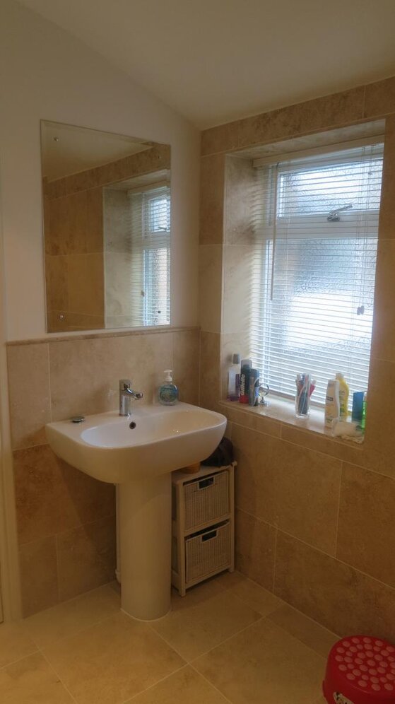

I've done it both ways.
Personally, I would mark the area that I want the mirror to be fixed and then tile around it (you may need a baton to keep the top row from slipping). I'd then get a local glazier to cut the mirror to exact size, allowing for a 2mm perimeter gap. The mirror is fixed with mirror adhesive (glazier will supply) and can be packed out with mirror packers and "great big mushroom head" dollops of adhesive, so that you get the mirror flush with tiles - "Simples!".
Just Silicon the gap after fixing with a high modulus Silicon :thumbsup:.
Captain slow has described exactly what I did last week & it looks great,I'll just add though I kept the perimeter gap to match the the grout joint size so it ran in line,it was colour matched with mapei 111 light grey so there was no colour difference.Taped off the joint both sides,left the bottom joint till all was set,removed packing, gunned in bottom. One other thing was to get the mirror polished edges all round,any glass shop will do this.. Good liuk
