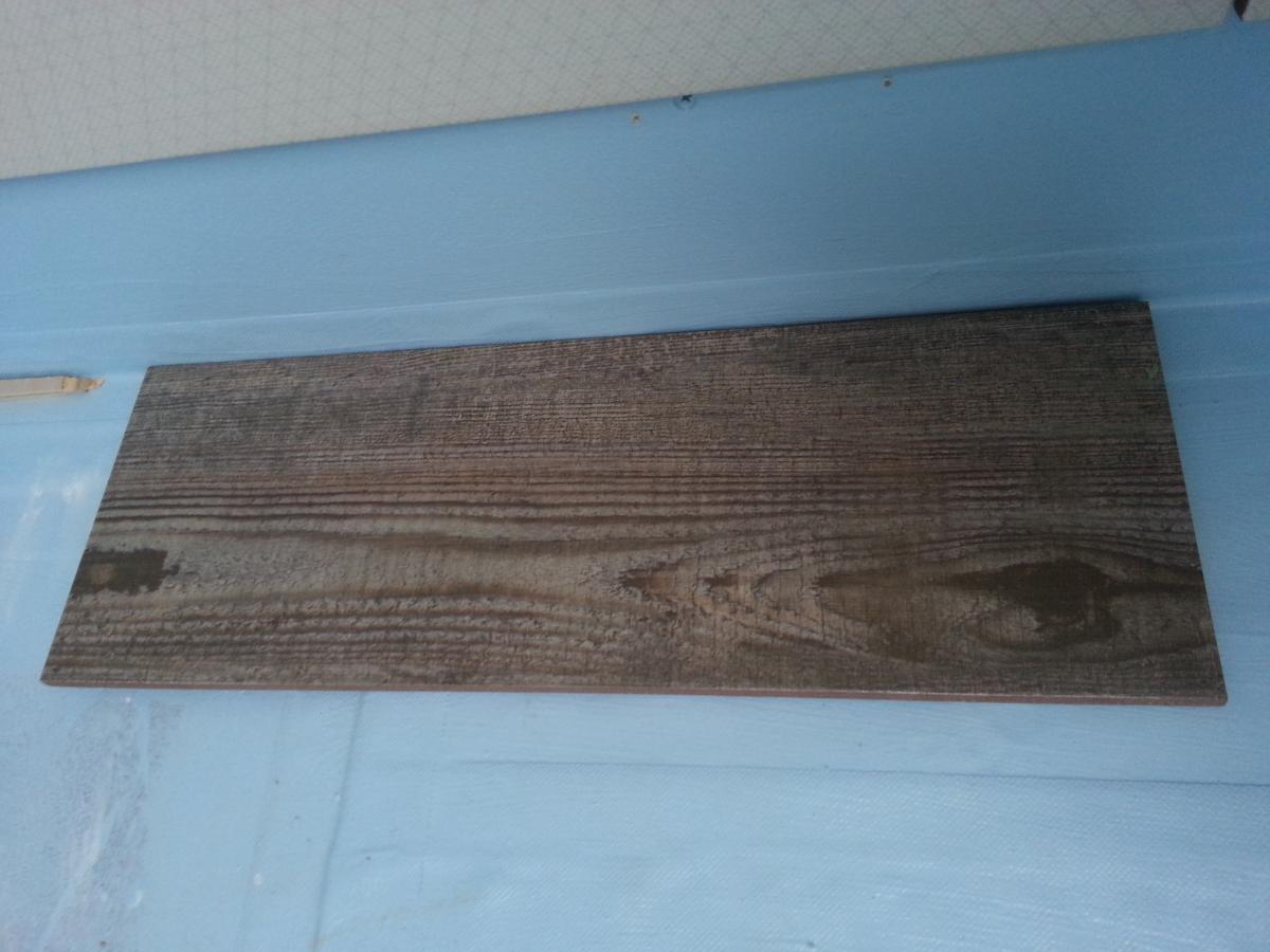

Hi again, have got new blade for cutter and waiting for diamond hand polishing pads to arrive! My blade is 1.8 mm thick not 3 mm do you think this will cause a problem. This is the room...and the tanked floor...
View attachment 55993 View attachment 55994 these r the tiles
View attachment 55995 and size View attachment 55996
Any advice would be great. I will dry lay first to see how they look and then use maskers to mark diagonals. ..do they need to be mitre cut ? Or just cut and polished ?
