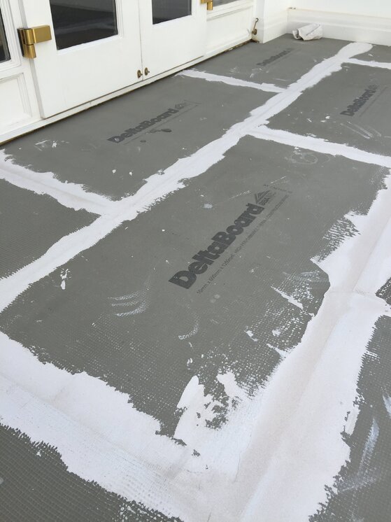

What you should do is glue and screw insulation boards down , lay electric matting , pour self leveler on top, then tile when slc has set .
Id find the center on the bifolds and work your setting out from there, either grout joint in center of glass or full tile spanning the middle door.
Measure your cut to the long wall, cut them all and work from that wall.
Id get standard set adhesive as well
thanks for your input widler, i'm not planning to use insulation boards, i'm planning to lay the electric matting straight onto the wood as you see it above after painting it with a heat resistant primer, without any self levelling, as the surface is flat, I was going to use 3mm spacers inbetween the tiles, but I've seen levelling spacers which look like a better option for me. I'd like the smallest grout line possible but I see most people recommend 3mm as the smallest line, would you agree?
So basically all the cuts should be on the lefthand wall, so you can see full tiles infront of you as you walk in the room, makes sense.

BUT i will say if he does not listen to the advice about how to do the job , then thats his problem, and it would be imo a big problem if he does not lay insulation boards over that timber , or use slc over the wiring 😵

Paint on primer with 2 separate wood substrates?

Seems like I shouldn't skimp on the insulation boards especially seeming i'm attempting it myself, i'll order some, thanks Widler.
True,this forum are here for help,but due to difficulty of this job must give him the right direction.
IMO go on heating floor with 800 x 800 is a high risk to damage wires,fit 800 x 800 is hard for an experienced tiler,do it right is another story,so I can't encourage him when I know all this issues.
