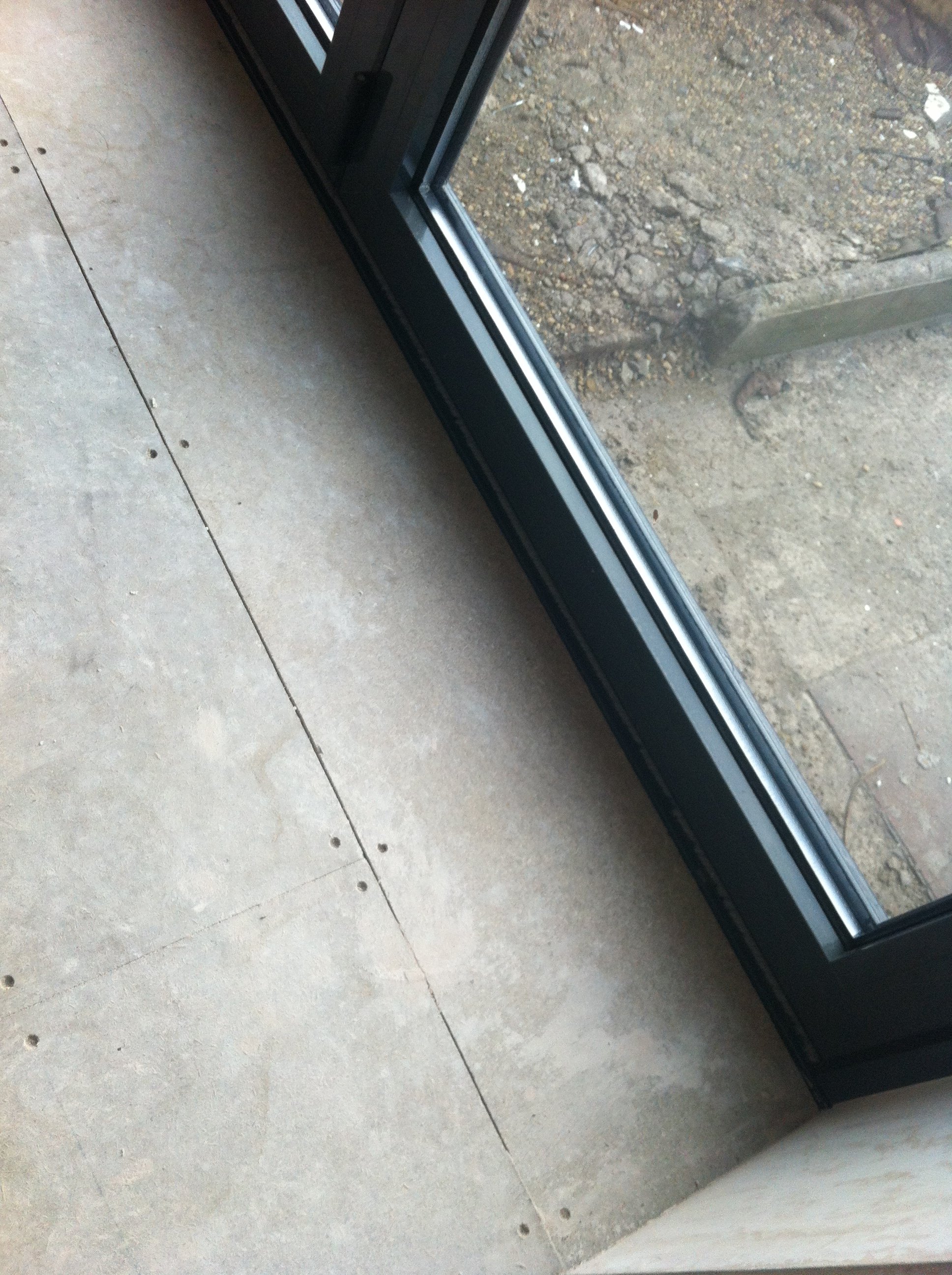

BUT i will say if he does not listen to the advice about how to do the job , then thats his problem, and it would be imo a big problem if he does not lay insulation boards over that timber , or use slc over the wiring 😵
What needs to be pointed out is that he would the same volume of adhesive to fill voids between wires as he would smoothing compound
True,this forum are here for help,but due to difficulty of this job must give him the right direction.
IMO go on heating floor with 800 x 800 is a high risk to damage wires,fit 800 x 800 is hard for an experienced tiler,do it right is another story,so I can't encourage him when I know all this issues.
Price wise material costs it will cost no more to use slc as if he doesn't fill voids in ufh with slc he will have to do it with adhesive roughly speaking they are the same price
I realise that it's not in Tilers interest to say that I can make a decent job of it as ofcourse it's less tiling work for the trade, but I've successfully done some DIY which turned out well, I've changed an alternator on a sports car with absolutely no mechanical knowledge, simply following instructions and pictures from a forum saving me a thousand. So aslong as I don't rush in gun ho and think methodically I believe I can make a decent job of it.
Seems like I shouldn't skimp on the insulation boards especially seeming i'm attempting it myself, i'll order some, thanks Widler.
Is not about our interest here,if this job was near to me I come free to help you at lest to set up and start,is just about too many steps need to be done right where we fail after 20-30 years on tools.

I'd suggest that with each stage, you start a new thread, otherwise you'll be inundated with information and it'll probably overwhelm you.
First thing is first, make sure you have the correct tools.
For such a large format tile, this is the trowel you should purchase;
RAGNI R319-10 10mm Tiling Trowel - 1 https://www.amazon.co.uk/dp/9788034470/ref=cm_sw_r_cp_api_5J0myb1S9VK57
Not necessarily from Amazon, selco's sell them too.
Make sure it's 10mm notch.
And you'll want to use your 6mm to stick down the insulation boards.
You will also want to lay your insulation boards perpendicular to your existing floor boards.
And lay them brick bond.
Make sure you do not have insulation board joints lining up with boards below.
And then tape the joints.
What mechanical cutter do you have?
What wet cutter do you have?
What adhesive do you have?
That'll keep you busy for a bit.
