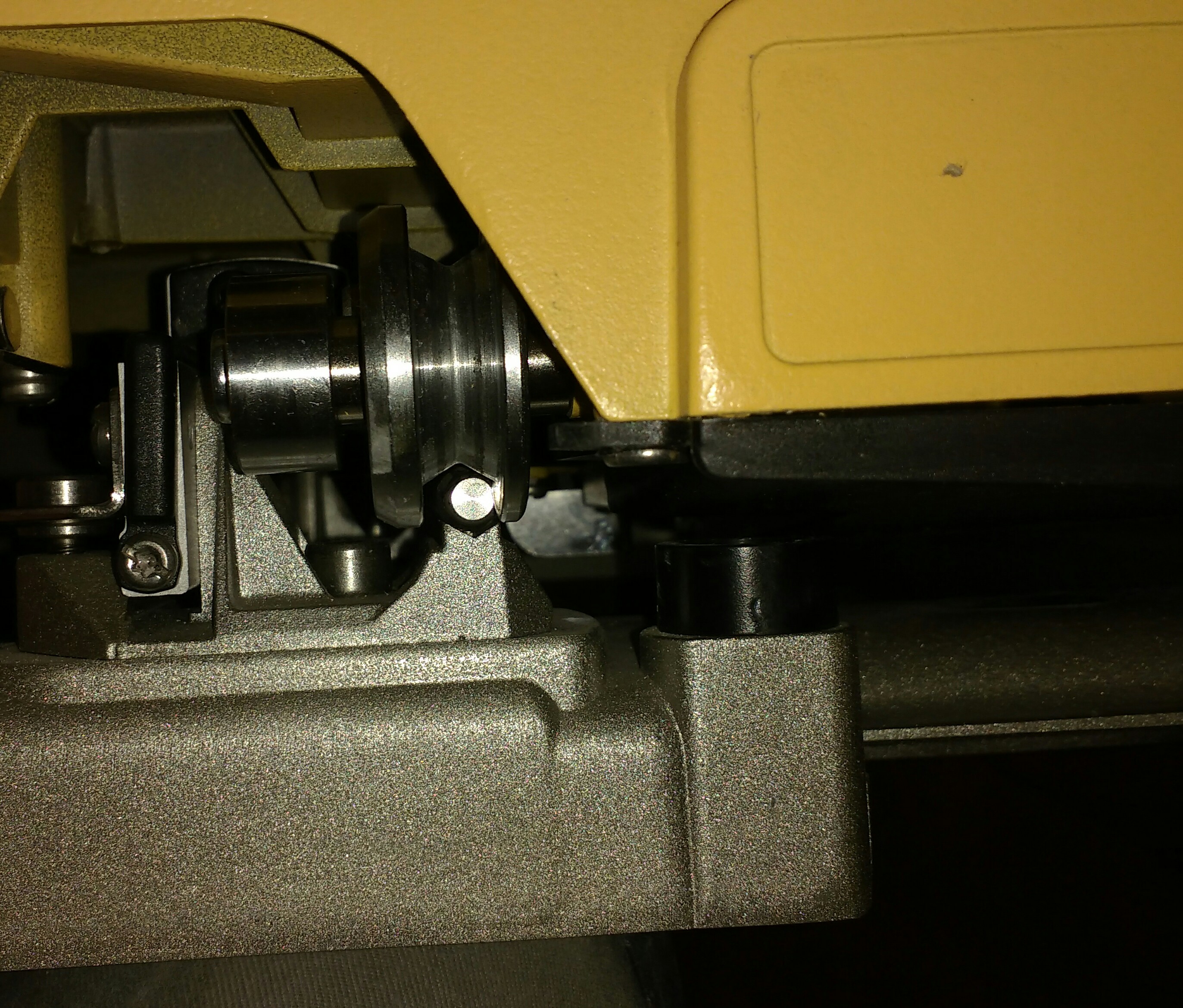

This back wheel is catching. I think this is the problem. It glides easy until the back wheel inserts into the rail. Is this supposed to be like this or a fault. I'm getting suspicious because the store I bought it off had that brown tape where it's to open at. I'm thinking maybe it's a return item theyre trying to Pam off on me.

When I have first 2 wheels on, it glides OK. Wouldn't be able to slide it up to cut point thou without 3rd wheel on. Once 3rd wheel on, and able to push up to cut point, this is when it needs pushed with slight force rather than glides. Defo something up!
Can you check yours to see when putting tray on, and when it comes to putting 3rd wheel on rail, does yours line up perfectly or like mine in the pic!

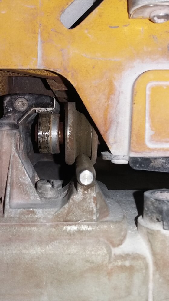

just looked at mine, as you say last wheel is of at start of run but mine glides straight on to the bar with no issues.
sounds like something out of alinement. If the first two run smoothly then maybe the last wheel is out.

yes, as has mine. Two stay on guild at start of cut and third set moves onto bar as the carriage moves forward to start the cut. I think its when the third moves onto the bar that it hits, mines fine. Sounds like that third one is out of alinement

Bought brand new in place in north of Ireland. Was thinking same about wheel being out of alignment. Have a job starting on mon, looks like it's back to using my plasplug cutter :( Very disappointed at this!
