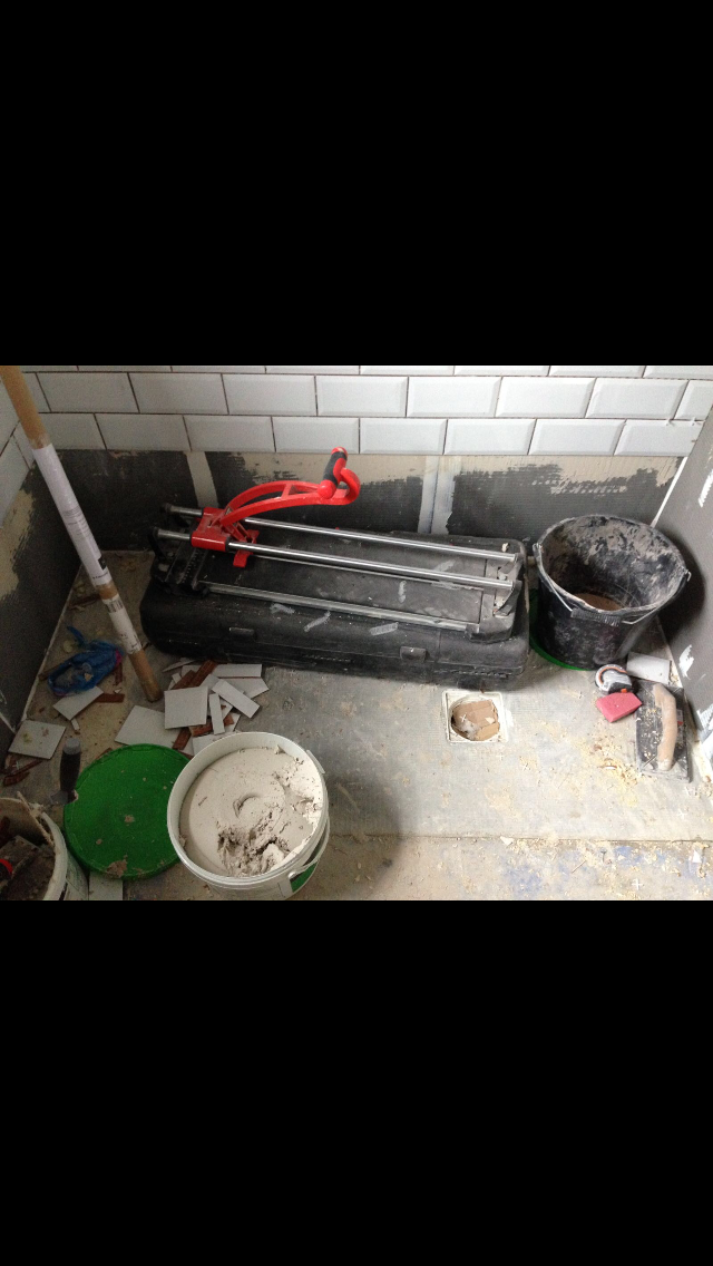

Next time I'm there I'll be taken pictures to show you. He even left the sharp cuts on the wedi tray and walked on it. It's a sign he doesn't give da monkey. He used the cheapest tile adhesive on the market fresh from the bucket 🙂 I'll upload later some videos how the tiles came off from the wall because he forgot to fit a channel for the screen 🙂

Check this tiler out.
How he treat some the jackoboard with his tiles on the floor and the waste 🙂)
