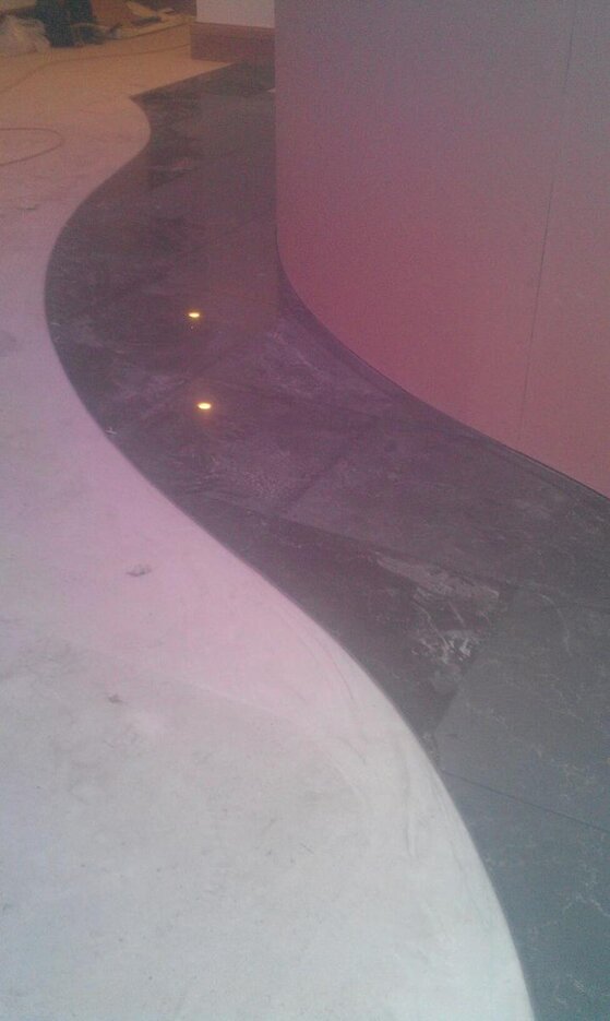

This was a challenge, when done there was no noticeable distinction between each tile, had to be good though as there was no transition to hide the cut. I love using my angle grinder, other than my sigma it's my primary cutting tool

Nice looking job there charlie
