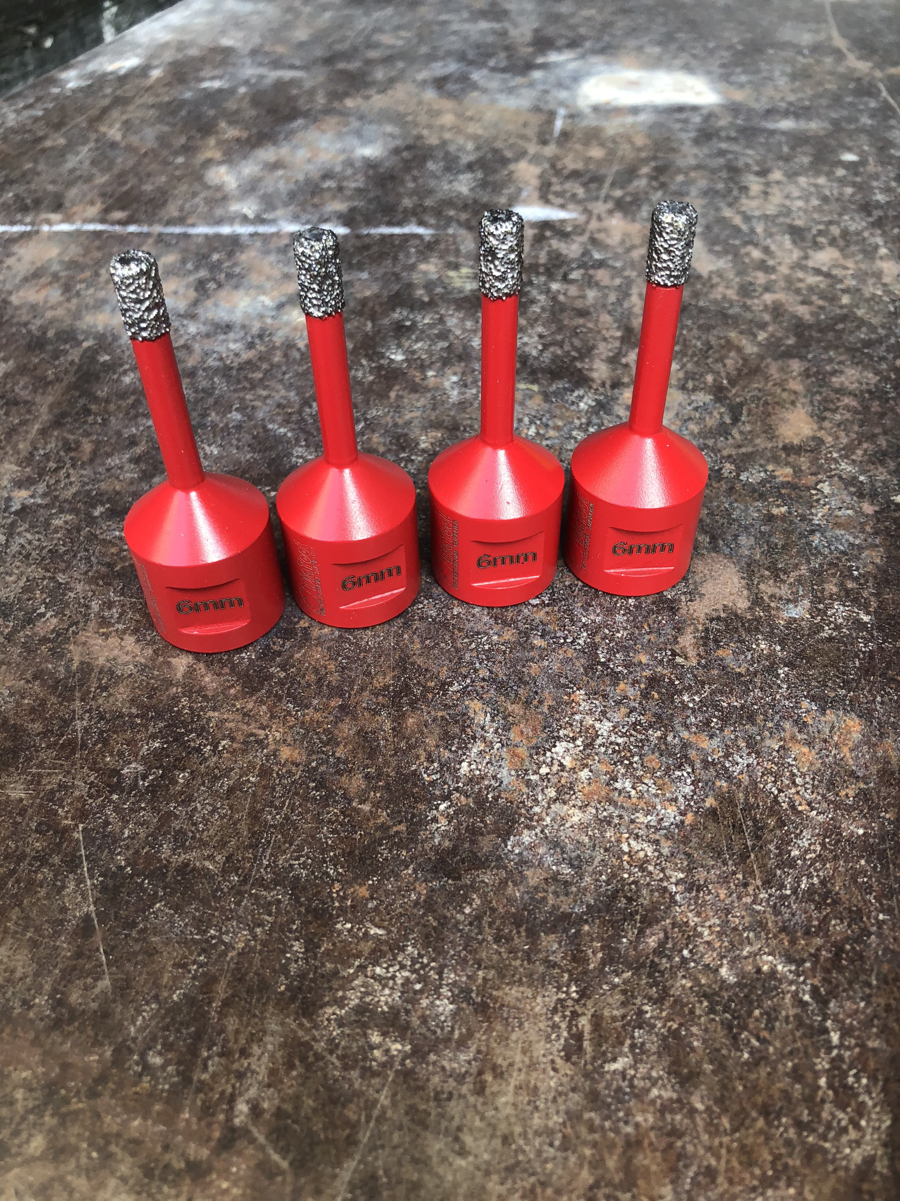

Started staying clear of the M14 bits, they don’t seem to be cutting clean enough unless you buy high end pieces.
I’ve moved back too the cheapest vacuum braised bits cos they’re leaving cleaner cuts
I've never switched from them not found I tile I can't get through yet and when working with guys who use grinder bits I'm quicker and leaving much neater holes

I absolutely agree that the vacuum brazed bits aren’t as smooth as the older diamond coated bits when using larger cores.
I’ve not used these ‘red’ vacuum brazed bits yet. I’d imagine they are identical to the gold bits from the same company.

You’re right, They don’t cut as well as as the cheaper diamond coated bits or whatever they are called. The cheaper bits but the expensive versions of those bits cut nicely with water. That because they are thin walled bits. It really depends on the application though. Towel rad pipes and hot and cold entering a wall mounted cupboard are covered in metal shrouds so it matters less
I mainly use the vacuum brazed M14 bits on the smaller verieties (6mm) and they cut beautifully. Every bit as good as the expensive versions.
On the @ATSDiamondTools website, it says "If you’re looking for a solution for 6,7 & 8mm holes specifically for porcelain tiles we recommend the wax filled bits over these M14 drills."

No I don’t agree. I prefer the M14 wax filled bits over the wax filled bits that go into a drill.
I have tried wax filled standard bits in drills. A few varieties including Marcrist, Spectrum, Mexco, Rubi dry gres with the arbor adaptor and I don’t believe they cut as well in a drill as they do in a Grinder.

These are the wax filled bits I use
Be good if you add some feedback on them when you've used them, with images too please.
these are the ones that leave the cleanest holes.
