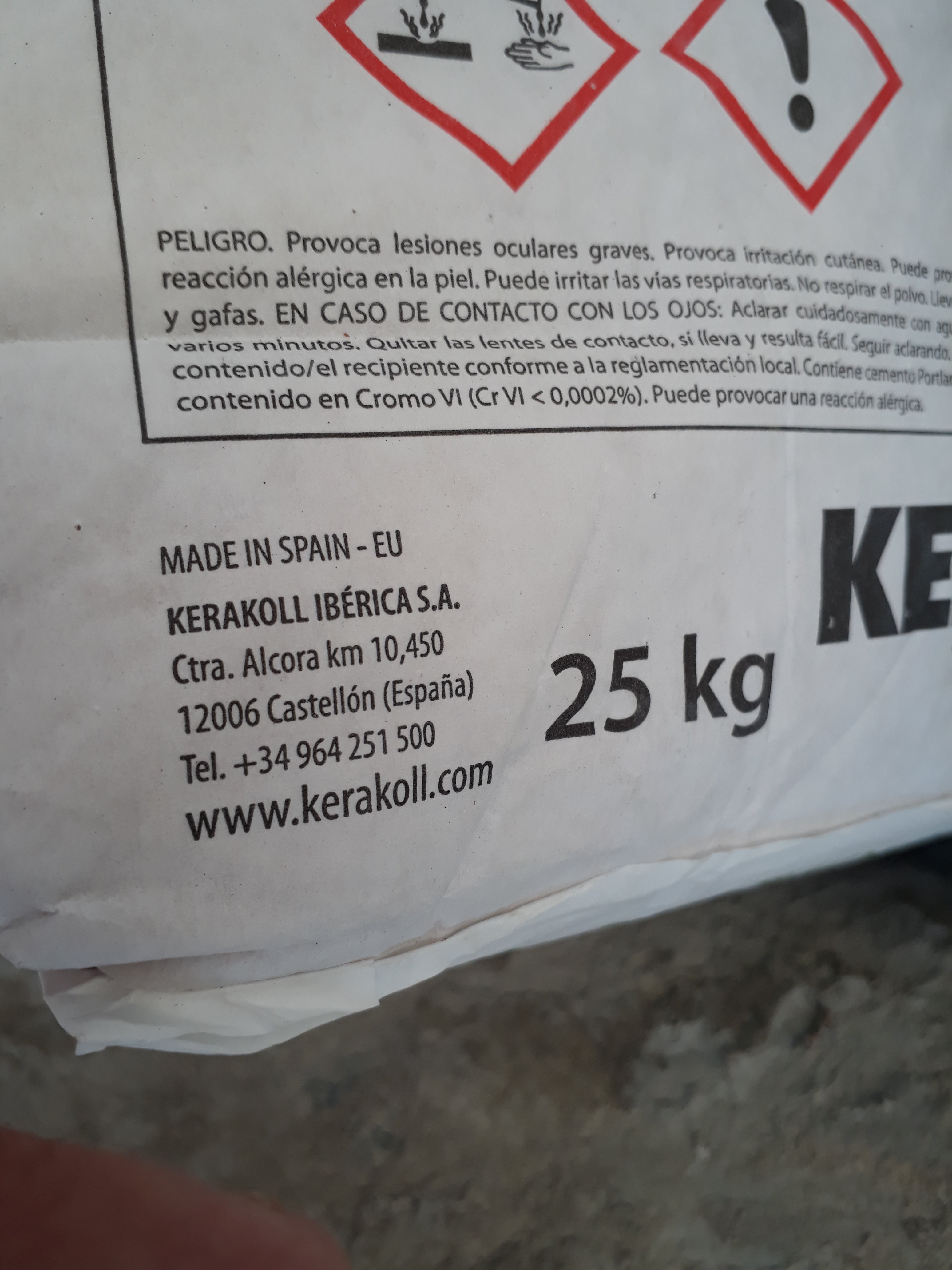

Tried the white Kerakoll H40 no limits adhesive today on floors, part mosaic wet area and part 600x300 dry area. Very easy to mix up, very creamy, and mixed till formed peaks which held shape. Installed mosaics first, 4mm serration paper backed mosaic, once mosaic pressed into adhesive with rubber trowel they stayed where I placed sheets and adhesive not coming thru joints, but still easy to straighten up joints with my little olive leaf trowel. Next 600x300 porcelain with 10mm serration, trowelled all the same way and back of tiles buttered. Very easy to serrate and spread, can definitely tell you get more square meterage per bag. Took up couple of tiles, completely covered and wet. Also tiles don't move about, and adhesive lasted all day. Very impressed really!
