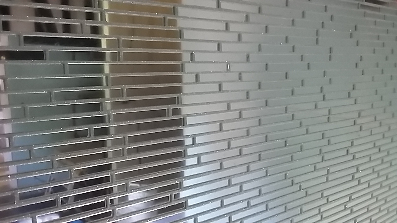

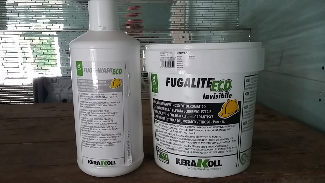

I work with Epoxy grout a lot and hate the stuff, doesnt help Im sensitive to it but its a pig to clean.
This week I finally got a chance to try out Kerakolls Fugalite Eco epoxy grout, or liquid ceramic as they call it.
Its the Dogs Danglies and stupidly easy to clean with the help of their Fuga Wash, even on mirrored mosaics. No need for emulsifying pads :).
Ive only used their Transparent grout so far (with silver glitter) so hoping their coloured grouts are as easy to clean too.

What goes on with the adhesive with transparent grout? Do you see it? Or a shade of it? Or is enough glitter added to stop you seeing it?
As long as the addy is below the surface of the mosaics/tiles you wont see it. sometimes you can see it if its too high so i just scrape out with a knife as I go along. The glitter wont hide it.

yeah it does have that oily look to it when applying. Did you use the Fuga Wash in the water when washing off grout, and then the Fuga Soap to wash off any dried residue when the grout had dried? I use two sponges with each tub.
I was working on mirrored mosaics and was amazed it didnt leave any residue after just using the Fuga Wash in the water. I thought it was going to be a nightmare. Ive yet to give it a wash down with the Fuga Soap.
