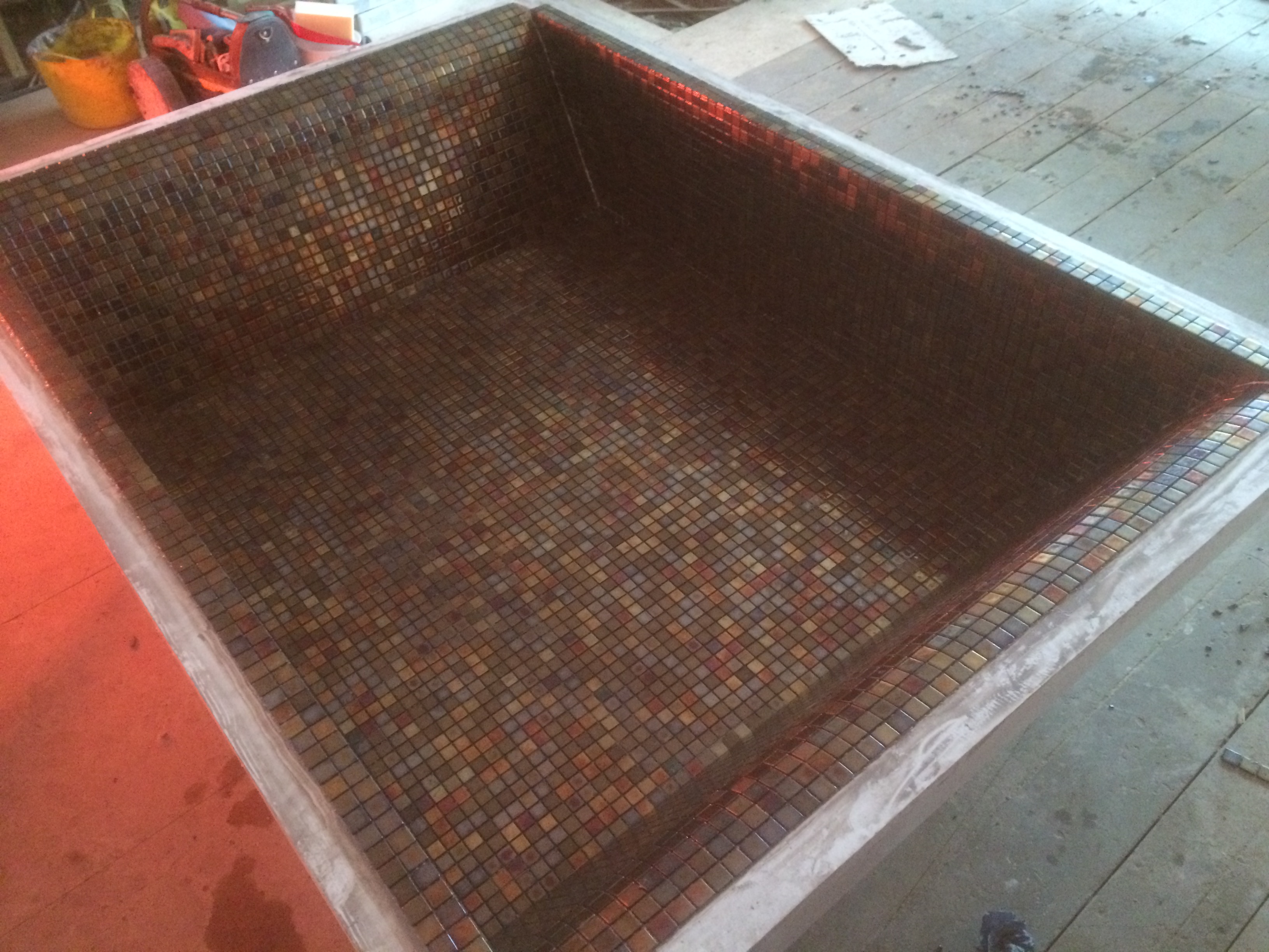

This was the tub we mosaiced - ready to be inserted into position,drilled and fitted around. Grout was taken off within 20 mins of squeegee on with white pad and their 'wash' . A great epoxy grout.

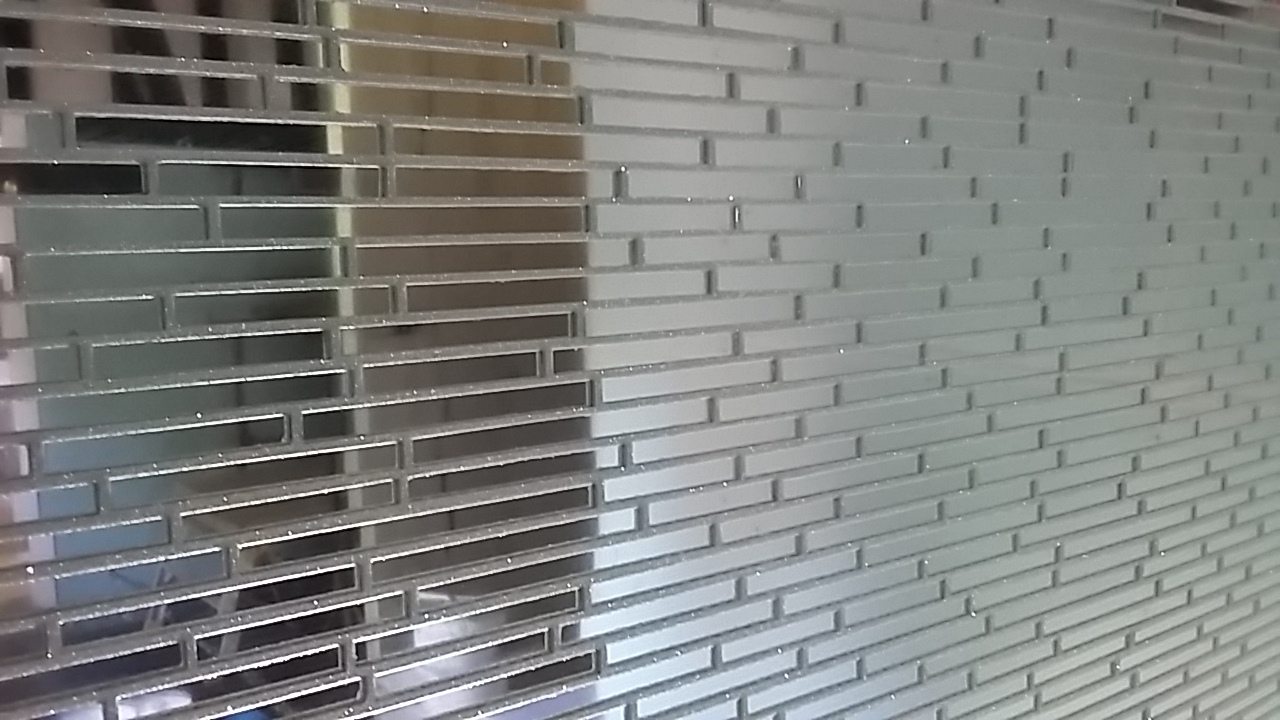

As soon as youve applied the tub clean it off. I didnt need to use white emulsifying pads. I was using the translucent grout with glitter, perhaps the coloured grouts might need white pads in the cleaning process.I just used a half decent sponge and sponge cloths. A capful of Wash goes in water to clean it. When its dry use the Soap to clean of any residue. I couldnt believe how easy it was to clean. I used it on these mirror mosaics and there wasnt any smudging after washing it down.
Still need to wear Nitrile gloves etc.with it.
