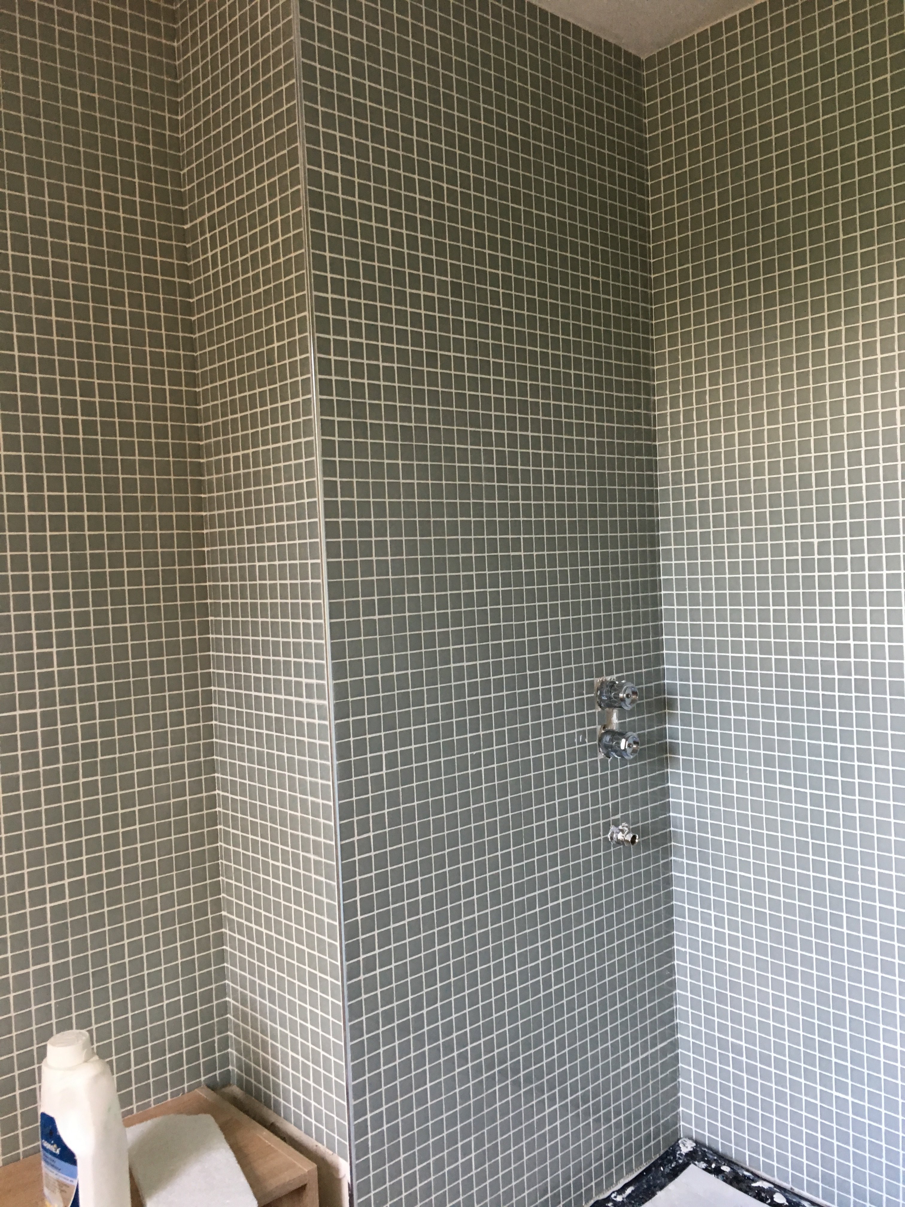

It's very coarse and very difficult to strike off smoothly which leaves quite a rough surface, which surely defeats the object of an epoxy if the dirt has somewhere to sit, it reminded me of bal wide joint when doing the walls, quite a task to keep it off the floor. As for the washing off, I washed it 4 times with their liquid in hot water and there's still a greasy residue that I can hopefully get off in the morning when it's set. The biggest issue is how long it takes to set, every wash just pulls a bit more out of the joint and smears the tile face, I used a new sponge for every wash and followed the instructions very carefully. And my final gripe is its 8 times the price of a cement based grout, now that's just outrageous.
I have the same issues but just with white one, hard to fill in,hard to archive the nice finish,but start this morning with antracite and work really fine, easy to apply. Seems the white one have different sand and not work in the same way.
