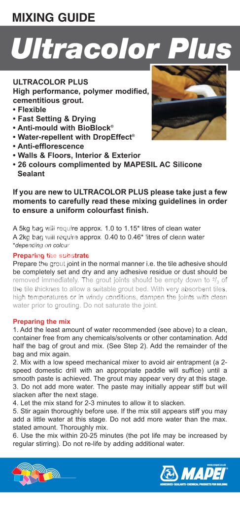

thanks for that Suzie but the instructions state that you need a mechanical mixer on a slow speed setting. what about the DIYers out there that don't have a mechanical mixer and have to mix by hand?
You can get a paddle from the pound shop etc....price hmmmmm £1 and most people have a drill :thumbsup:
