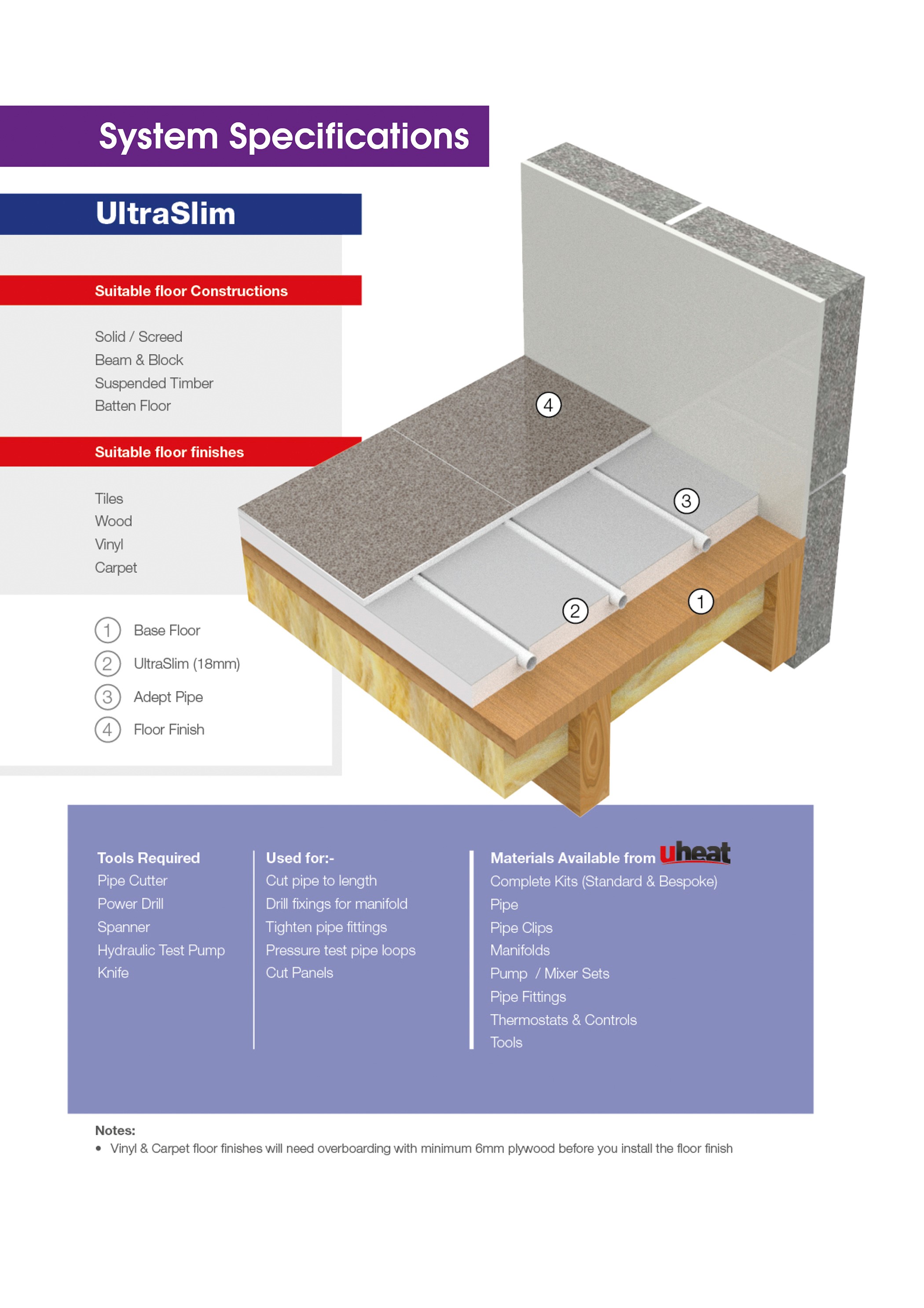

Have to disagree overlay is the way or as Boggs has suggested the systems we have recommended you tile straight on top of the pipe heat is there instantly its seems julian has advised the same type of system 3 of us cant be wrong ? All the best kop

No you won't 18mm grooved boards with pipe laid and tile directly on top of the board and pipe , adhesive and tile will give you the 30mm . Kop
Its 42mm to the finished floor.
To the tiles and adhesive its 28-30mm
For overlay boards to work I would need a 30mm overlay board...
Or
...use a standard overlay board and top it with Mapei renovation screed, hence the suggestion to skip the middle man and go with the mapei reno screed to begin with.
