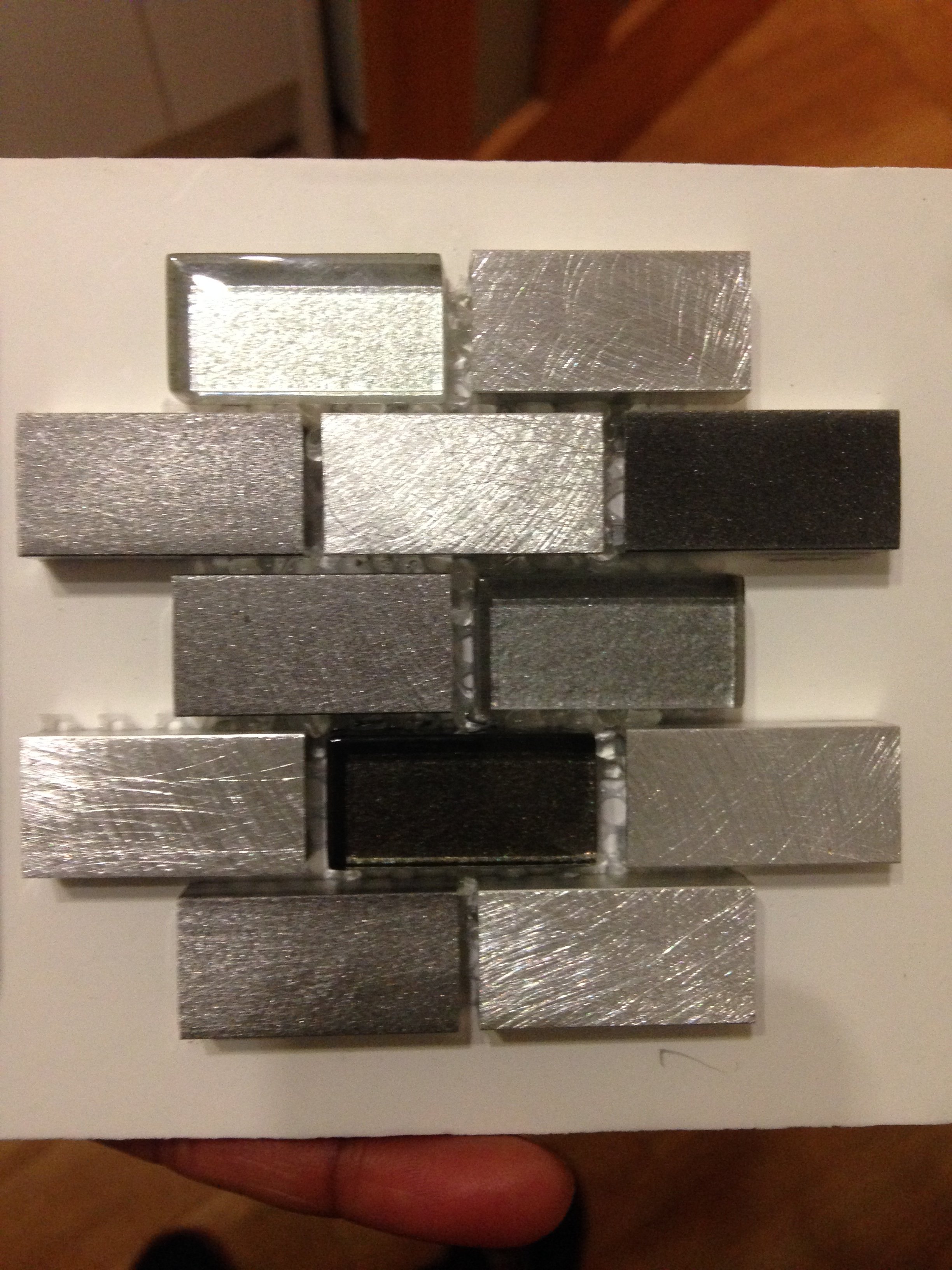

Never attempted a mosaic before, so thought I'd seek some advice. Only having used mosaic in the regular tile format (same as tiles, but patterned) around the house, I fancy a go at a "proper" mosaic stripe and column in the bathroom. I've really gone in at the deep end with my first attempt! The metal bricks are not capped tile pieces, but actual solid aluminum section that have been polished. Here's what a sample looks like:
What I planned to do was create an empty space/strip of 10cm between the regular tiles (400X150 stacked white gloss 10mm thick) and edge with metal trim. Once tiling is complete, then fix the mosaic (8mm thick) into the space.
I need to make list of things I'll need (adhesive, grout etc) in order to get the best results I can (for a novice!) I thought I could use a metal cutting blade in a grinder to cut any sections, but unsure about glass, so trying to avoid cuts.

I want them so the brick pattern is horizontal in the strip running through the main tiles. That should not require cutting, as each mosaic sheet has 18 lines down. I intend to cut the sheet so there will be three strips of 6 bricks high. If I rotate each strip by 180, then they will lock into row.... if that makes sense. There will be a vertical column behind the shower and taps that I will also have to cut at the edges, but I hope I can use the half cut pieces to fill in the other side and make a sheet that is square. Stack those up in a column, so the vertical strip has a brick pattern that runs sideways, but no half brick ends! All in my head at the moment (hoping it works, or I'm in trouble. The pattern should, it's the fixing that will be a headache!)
MTiler
With them being a brick bond pattern there will always be cuts. You'll need a different blade for metal and glass so you'll have to seperate one from the other. A good cutter with a mosaic mat will snap the glass mosaics such as a Montolit.
For grout you can use Mapei Keracolour SF, a super fine grout suitable for glass and metal.
The glass tiles have a backing on them to give them colour so you'll need to use a suitable adhesive such as Mapei Keraflex Maxi in white.
Usually therell be a tech sheet for the mosaics on the manufacturers/suppliers website check that first.

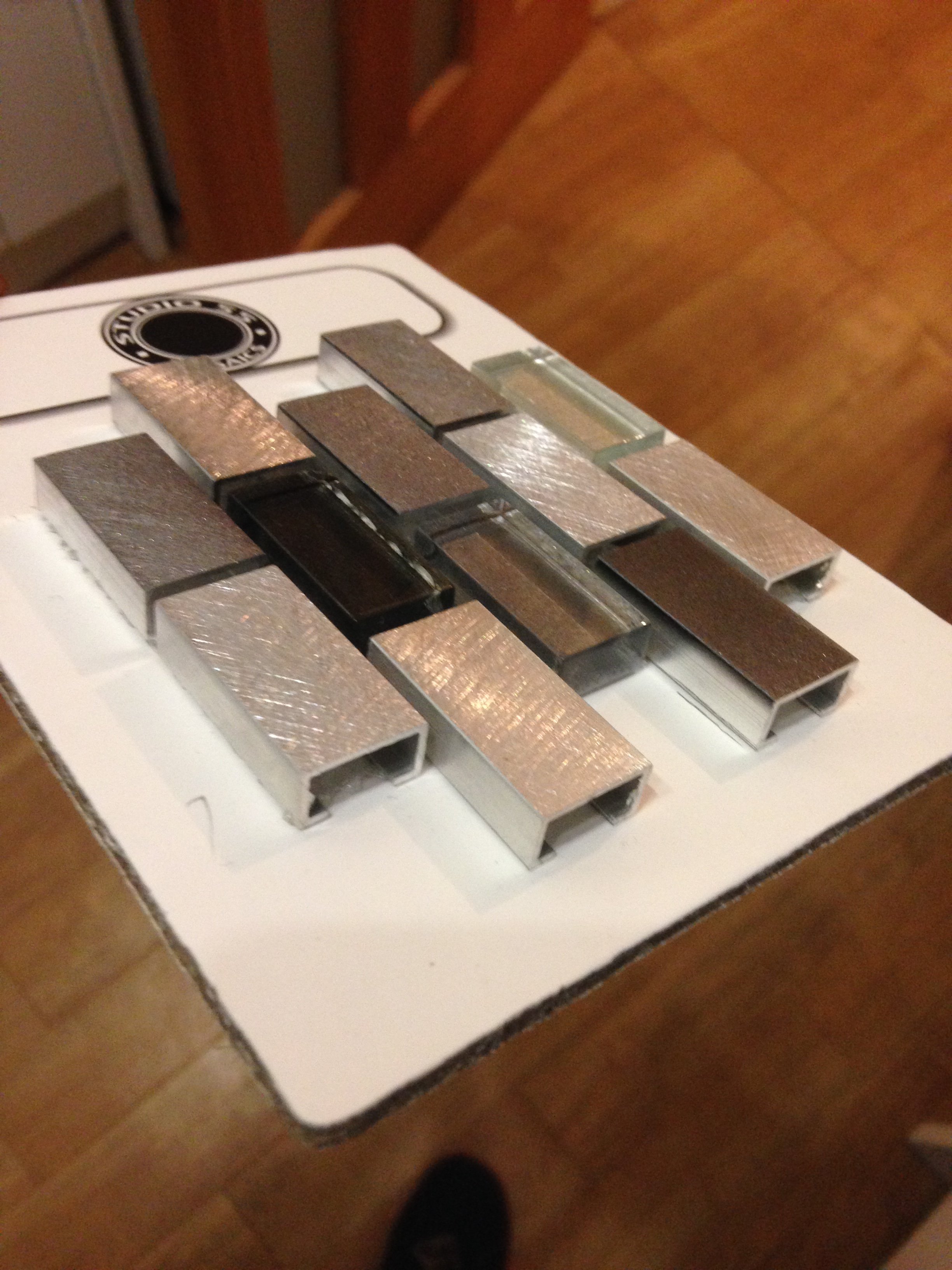

Thanks for the reply MissTiler and everyone. Gave the metal a go with the grinder and it cut through the aluminium profile bricks pretty easily. Only difficulty was holding a sheet firmly whilst I cut and aslo smoothing the cut edges. Any ideas? I had thought maybe getting a metal cutting disc for my dremmel, as it would be more precise and I could cut with one hand and hold the sheet with the other. Don't fancy trying that with a grinder!
Regarding adhesives and grouts: I can get some BAL white star ready mix for free from a friend who has a couple of tubs left over from his own house renovation. I understand ready mix isn't as good as the wet mix, but seeing as I'll be only doing small sections a few hours a night, after work, I thought it may be better for my situation. Read somewhere that the grout needs to be as fine as possible, so it doesn't scratch the metal surface. Apparently that is usually only available in white, but that's fine, as I planned on white anyway and it would be handy if using white adhesive, as some will no doubt come through.
As the thickness of tile and mosaic is only 2mm, I thought some mosaic mesh should help make up the difference. What I planned to do was cut most of the mosaic tiles into the strips I need and get some self adhesive mesh. Then I could pre-prepare all the strips and have them rigid and straight to begin with. Then in the space I'll leave between the tiles, I will fit these strips afterwards. Almost as if slotting a tile into the empty tile space, one at a time. One wall each evening, so I can slowly check all the levels are right. Does this sound ok? Need a good quality, reliable mesh that's rigid and self adhesive. Anyone used the Homelux one before

Do not use Bal White Star it is not suitable, even if it is free, use a white cement based adhesive as Ive mentioned above.
To smooth off the cut metal you can use a diamond rubbing pad.
If you use the mosaic mat mesh you need to have the adhesive coming through the mesh so it adheres to the mosaics as well, as the glue on the mesh could dry off in time and the mosaics could come loose.
How much do you have to make up?
Mapei Keracolour SF is a super fine grout that can be used on metal and comes in a few colours.

A week on and the best advice I've had has been from you helpful folk. What is it with tile and adhesive manufacturers that they daren't recommend any product or give advice on anything? Even the tile manufacturer won't endorse a particular brand and they produced the tile. You'd think they would have tested it, and if so, would have used an adhesive to fix it at some point. Maybe it's not wanting to put their neck on the line and be held responsible? Or possibly, fearing I am a novice DIYer assume I will mess it up and blame them? Regardless, I will just go with the recommendations here. I have decided to go with Mapei keraflex maxi S1 (white) as the adhesive and Mapei Keracolour SF (white) as grout (Thanks Miss Tiler!)
I have decided to do all the main tiles (400x150) with it too. Decided I would just use the same adhesive for everything and not bother with any ready mix. Just mix an amount each evening and finish it - start again next evening. I can't find any mention to it being suitable for glass and metal mosaics in any tech sheet, but will assume it is (fingers crossed - pinning my hopes on your expertise Miss Tiler!)
The thing that does concern me is the metal part of the mosaic bonding well. With it being a U shaped profile with only a thin lip to bond on either edge, and a hollow cavity inside, I am worried it will not have enough area to actually adhere to the cement. Especially as I can press it inwards too much with the risk of adhesive oozing through. But then, if it oozed through into the cavity inside the metal that would be good. For this reason I may now thinking mosaic mesh may not be a good idea, as it will mean even less contact between mosaic and adhesive. I know, I know, I am obsessing too much over it, but hey that's me. As per always, any advice is welcome and appreciated. Thanks.
