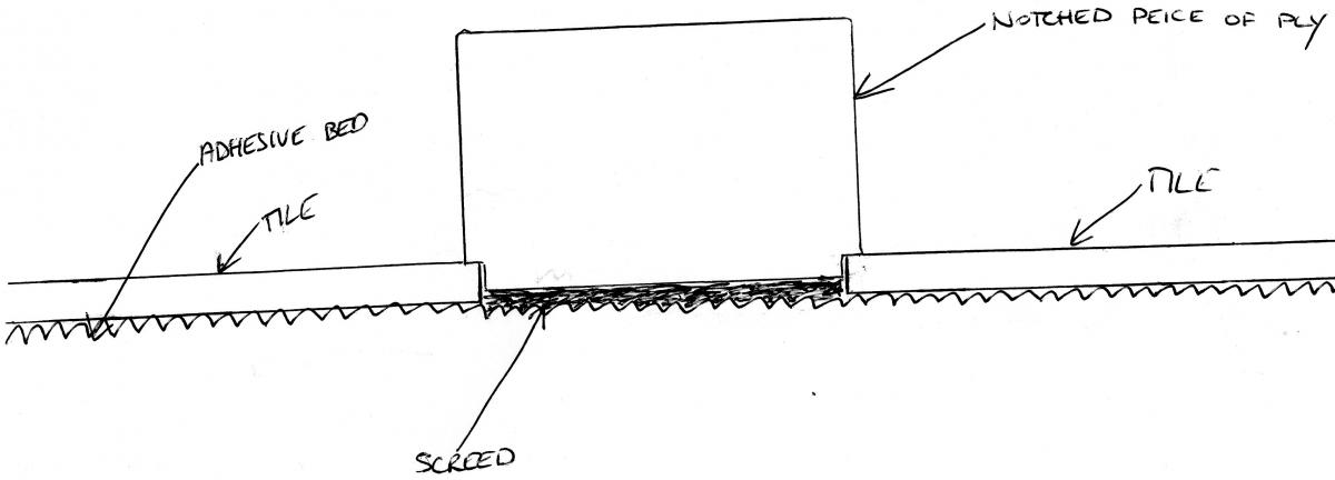

Just needs modifying for corners though, where you only have one tile edge to screed from....that is why i suggested to do one with a small leg at the depth of a tile...so you get the same effect....
I see, I understand what you are saying. So you would use that one for internal corners and also for externel corners when the wall has not yet been tiled at the other side of an externel corner
DHTiling
With the correct method you can use a template like you posted for any situation..
I was just pointing out that bathroomboy's job is an internal corner and not a border..:thumbsup:..so a slightly different template set up is needed..
Just to add..many thanks for the pic..not many get what we are on about when it comes to bedding out for mosaic borders etc etc...
