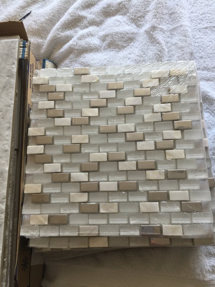

I am planning to lay the mosaic tiles pictured onto a wet room shower tray former, I have bought larger porcelain tiles for the rest of the bathroom,
IMG_0283.jpgwas worried about cutting them in around the tray former. Do you feel the mosaics would be a slipping hazard? and would there be any problems with underfloor heating.

So it’s an xps foam tray.
what size are the mosaic individual pieces?
(not sheet size)
You’ll need to check direct with manufacturer on the point loading of the tray.
Mostly, foam trays have a minimum mosaic piece size of 50 x 50mm, anything smaller will exceed the point loading of the tray and could potentially pierce the tray.
so you will need them to guarantee that your mosaic are suitable, size wise, first.
