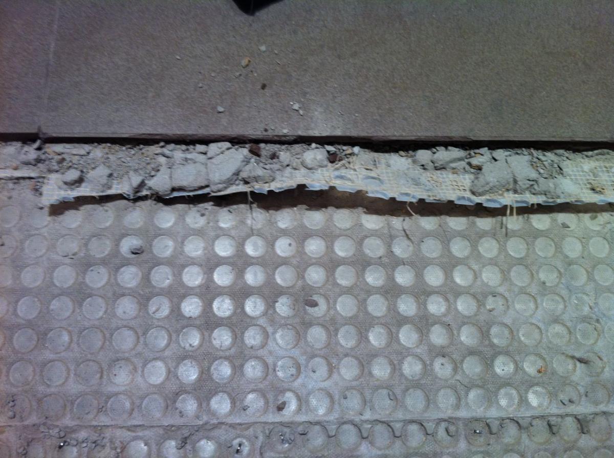

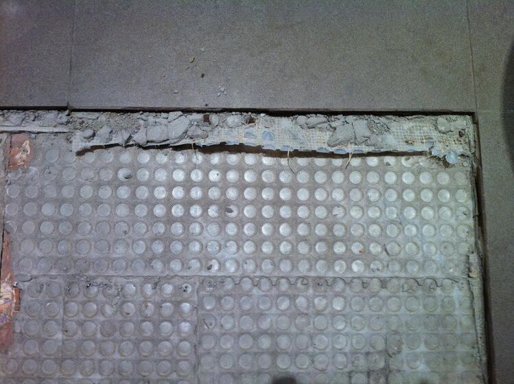

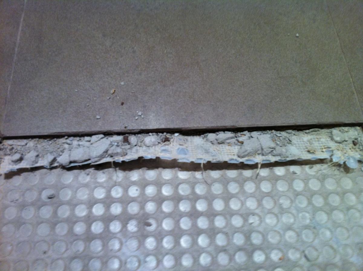

I have a few pictures below where we lifted a couple of tiles in the shower room. The builder was hammering to remove the tile, but the top layer of the mat literally lifted off. You can see the tile mat has separated for some reason anyway. The base of the mat is very firmly fixed to ply. The top is a bit less clear, but still seems pretty solid. It seems like the movement is from the mat separating rather than the adhesive failing, but it could possibly be a bit of both. The grout was only starting to show some hairline cracks, but the floor was moving significantly in places and making a flexing sound like the mat rubbing against itself. The main bathroom which we have left until we can get some more tiles as they are not in stock is over a much larger area (as it is a bigger room I guess).

Have you checked to see what the perimeter joint is for floor to wall..?
If this is too tight then lateral stress will cause the tiles to tent up and separate from the fleece.. i did ask this a few posts up..?

Thatll be the noise of the tiles pressing agianst the adhesive/mat where its lifted.

I did look at this, and it is quite tight, as there is no skirting the wall tiles do sit on top of the floor files at least to some degree. I would have to take a tile off the wall to truly know what allowance has been made. I would need to do this in the presence of the builder and tiler, so will wait until they are available. The section shown is on a door threshold so does not butt up against anything.
It will be to the left and right though..
If it is deflection related then this will do it as well.. as the bottom of the mat( fleece) will want to hold to the ply and the top ( polyethylene) will want to hold to the tiles.. hence separation..
