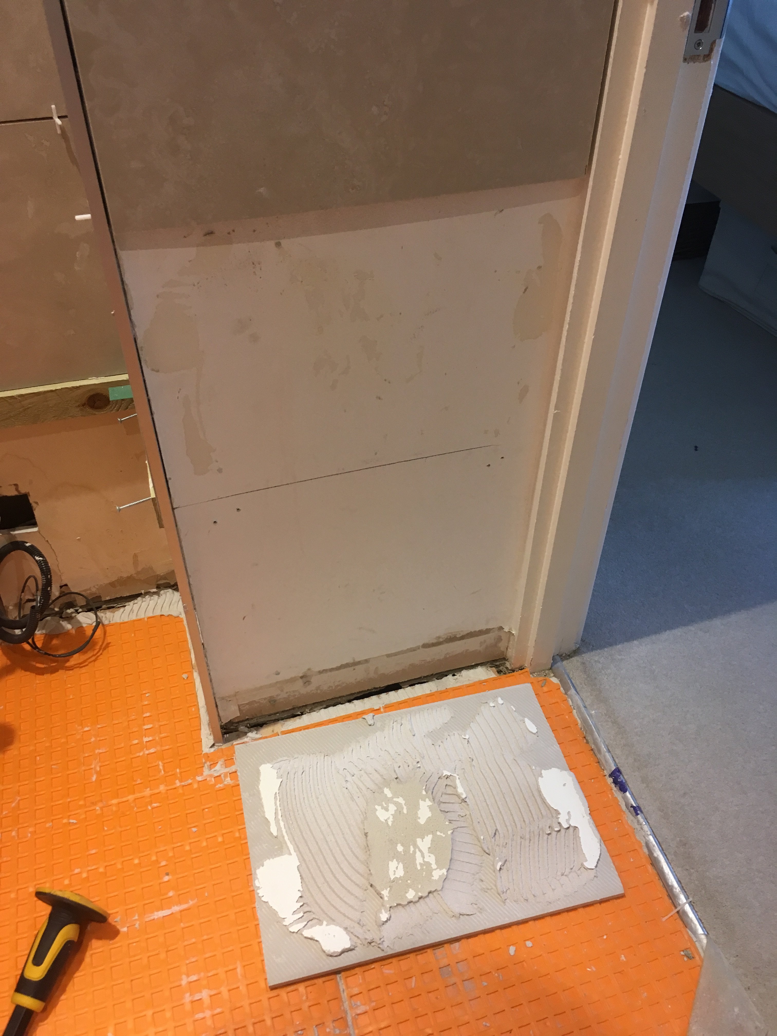

Opinion of tiling job so far
Seriously a good tiler will point out the mistakes and rectify them . I would also remove a tile to see if there is good coverage if not i would take them all down
Tell him to put things right before he goes any further as you are quite rightly not happy with his work ,see how he reacts ,if badly tell him to leave the house Pronto and then take things further at least then you have given him chance to make things right and he will be extra careful hopefully
This is pretty much what I've done.
He's going to send around a 'real' tiler tomorrow for a chat with me.
I'd like to give him the chance to put things right however I'm obviously cautious.
So I decided to see what the coverage was like on the tile (after advice from here). I have taken down tiles before so I was a little worried I'd take a chunk out the wall but this tile came off with (worryingly). very little effort. It felt like it was just attached on the right and left side.
Looking at all the tiles I am wondering if he applied the adhesive to the tiles not the wall as I can see now adhesive through the gaps in the tiles.
