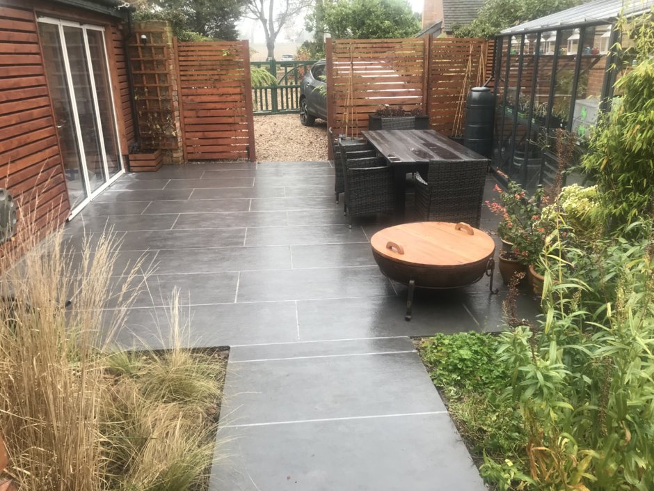

Thanks for the update matey. We rarely hear about them once we've sorted them out. So thanks for that.
Any pictures of it done?
Photos as requested. A wide grout gap, but that's what the original builder did.
