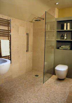

Its effectively like this here, except its not a walk in its an enclosure. But position is identical, in the corner where the slope is.
