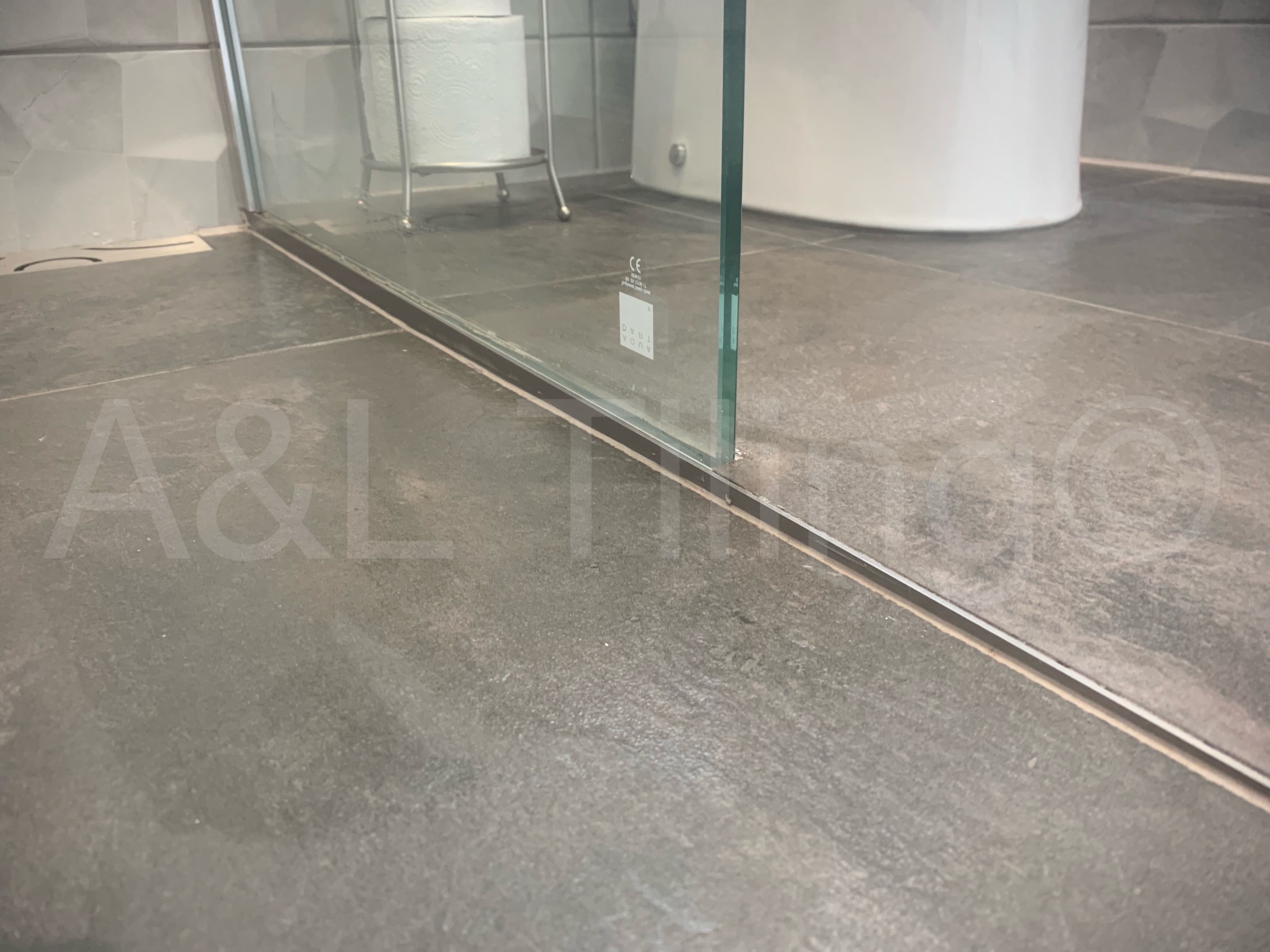

Recent wetroom using @Schlüter-Systems Ltd products. Was a lot of prep work involved and the old waste trap was off a Belfast sink and taped to outside pipe using brown parcel tape.

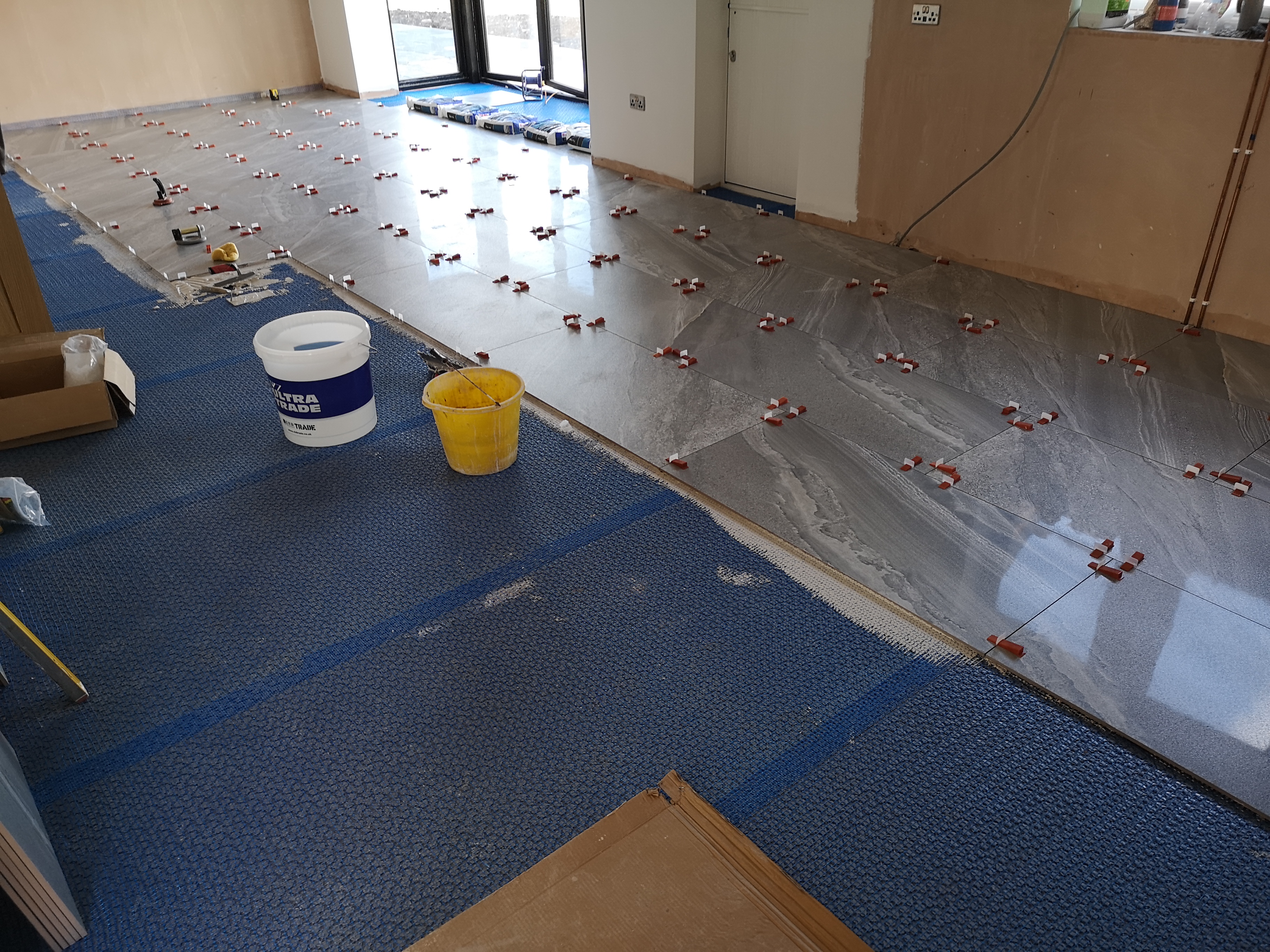

Job from a few weeks back and trying out @Nicobond Dmat. 900x450 porcelain.
Are other folk using a flooring roller to lay their matting? I bought one after watching a YouTube comparison between the adhesion you get with a float pressing it down and the roller and I must say it works a treat.

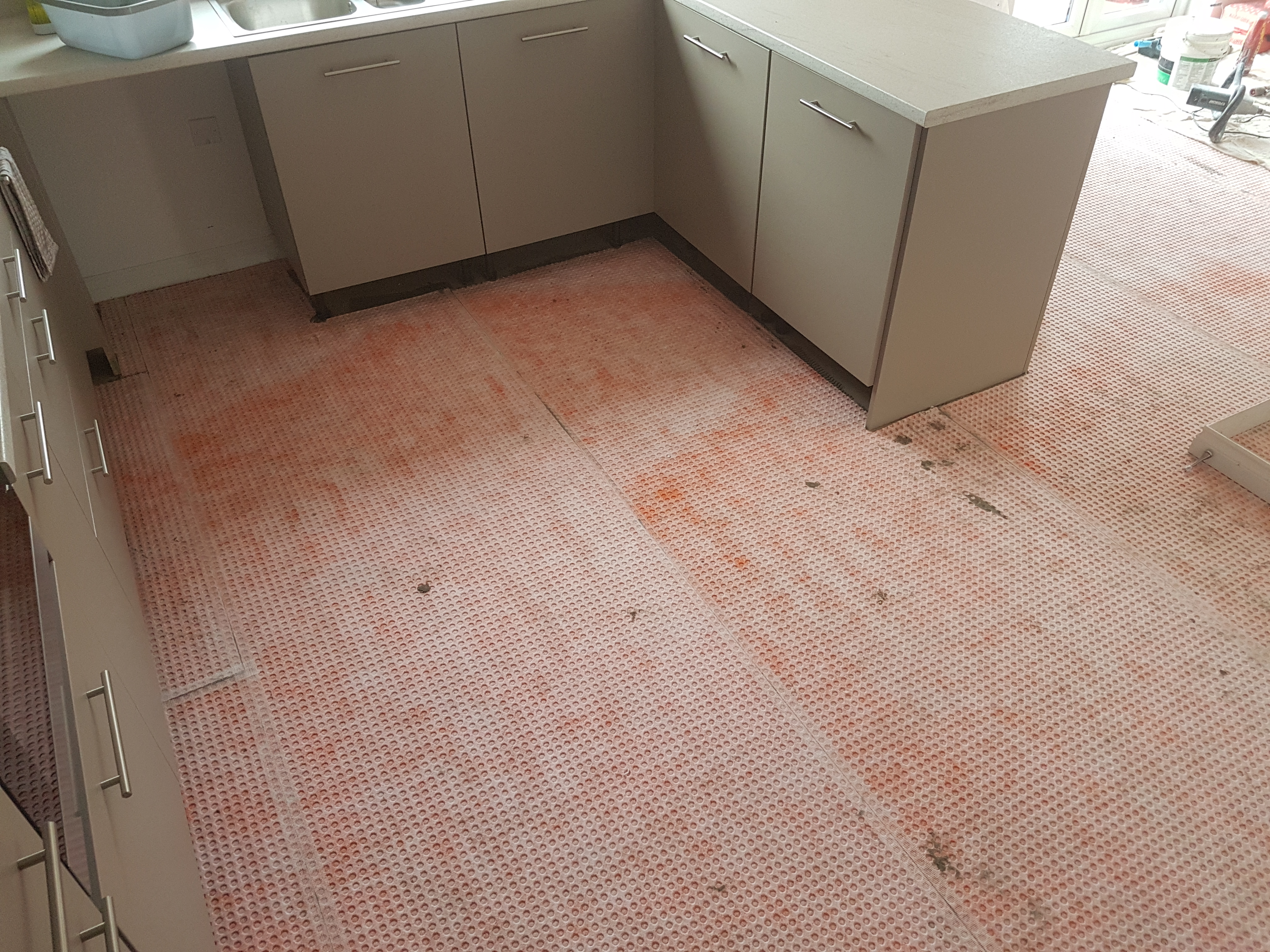

What’s your views on the 2Easy Mark?
Certainly easy to install. Easy to comb adhesive into. Feels wierd being loose but I'll have a better feel tomorrow when that section is dry and clear.
Worst thing was having to use bals new flex one. After a couple of years using nice lightweights, this was like going back to a budget adhesive. Not good to use at all.
Interesting to hear as of yet I haven’t used either. I’m keen to hear your thoughts at the end of the project Mark.
I had it spec'd as the floors haven't had time to fully dry and there's pressure on this one. The developer likes the sound of it as a solution to everything they could face (they were using durabase) so they've decided to use it on the next 5 houses and all of them in future.
Shame I'm not getting the ctd loyalty points seeing as it was MY idea!
