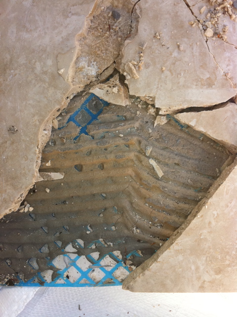

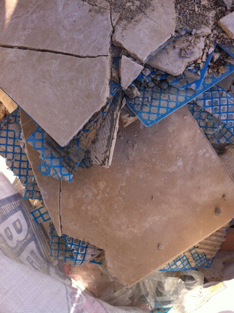

personally I think it's rubbish.... I've got 10 square metres rotting in my store with no intension of using it. I've also ripped up a couple of jobs where its been used...:thumbsdown::thumbsdown:

Floor completely failed, but that was also down to fixer error. It was installed on top of chipboard and t&g floorboards, with a 5mm trowel used to fix travertine. The floor was failing before the guy finished and asked the customer not to install their washing machine as it would damage the tiles. the other floor I ripped up had too much movement in it for the pp to cope with. I know a tiler who swears by it and uses it on all his timber floors and told me he hasn't had one failure....!
